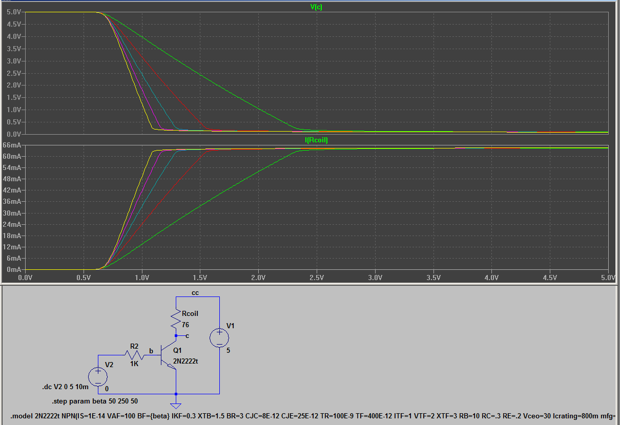

Relay coil current and collector voltage as a function of transistor beta:
Shouldn't be a problem.
Take the just the relay, connect it to a variable DC supply. Slowly increase the voltage. Record the voltage at which the relay pulls in. Slowly decrease the voltage. Record the voltage where the relay relay armature releases.
