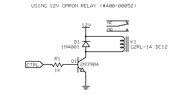

the sensors do not provide enough current to drive the relay. you need to use a transistor to drive the relay coil. you need the relay power to be 12vV dc, and the relay coil acts as the collector (for a bipolar transistor) or drain (for a MOSFET) load. the sensor would be connected to the base or gate of the driver transistor. an example of a relay driver transistor is this:
the control signal can be a 5V logic level, or the output of the sensor.

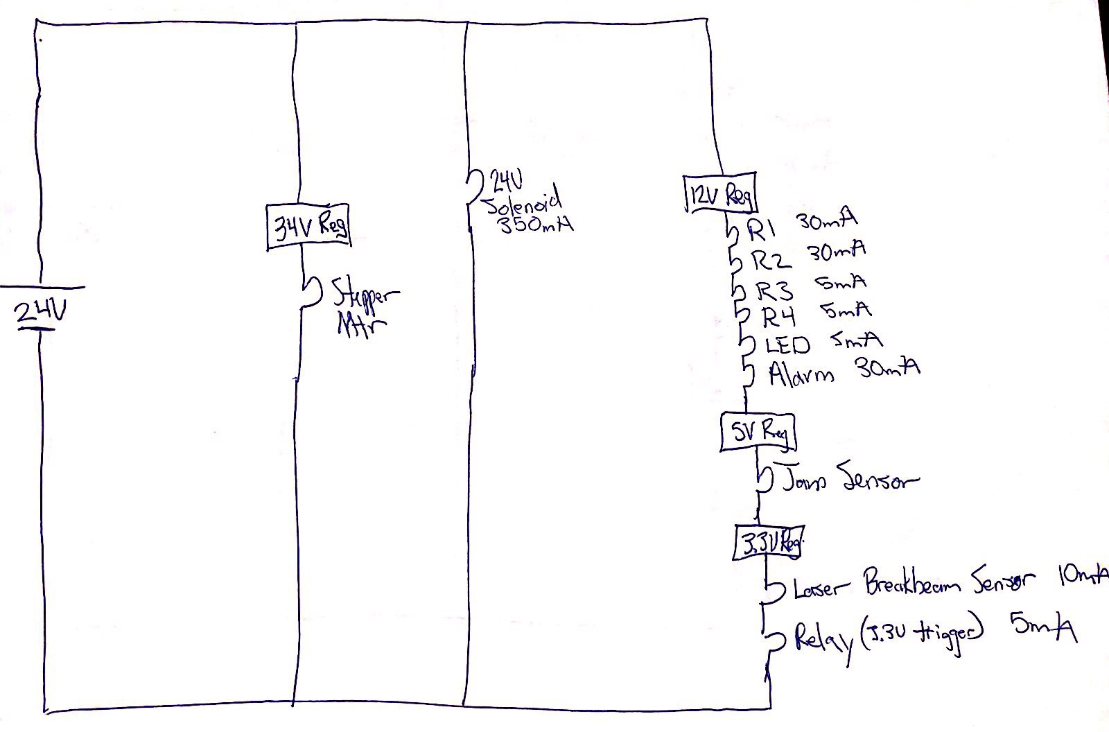

Im supplying from a step down regulator for 3.3V with an 800mAh current limit. Why do you have to supply a separate source? What are you referring to as a micro pin? Are the I/O ports and micro pins your referring to from a logic based controller? My controller can do sinking up to 50mA. So being I have to use two seperate power sources, one for the sensors and one for the relay, I should remove the caps on the relay, correct?

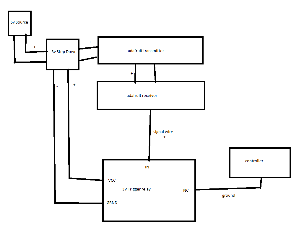

Post an EXACT circuit of what you're doing, vague descriptions are useless, we've no idea what you might be doing.
What is the 5V source? Can it supply the 800mA that the 3.3V converter needs (technically). Of course if all the loads are a lot less than 800mA, and the 5V supply can sothen no issues. Just want to verify the 5V supply has the current capacity...
Also, make sure the adafruit receiver ground is connected the the relay module ground.

here is a better interpretation of what my circuit looks like also...
I bought these from amazon hoping I can take any signal these sensors put out, and convert it to a logic signal...
https://www.amazon.com/gp/product/B07F7W91LC/ref=ppx_yo_dt_b_asin_title_o00_s00?ie=UTF8&psc=1
100mA sink means it can conduct (sink) up to 100mA of current to "ground" when in low state. That is, when active, its signal line drops to low, and sinks current form whatever it is interfaced to. It does not mean it can source any current. If the device sinking the 100mA is an open collector type of device, it will not source any current at all. The "high" state is held high by the device you are interfacing to (the relay board)
Your relay interface "in" pin is normally high, and you "sink" the line low to trigger the relay....
