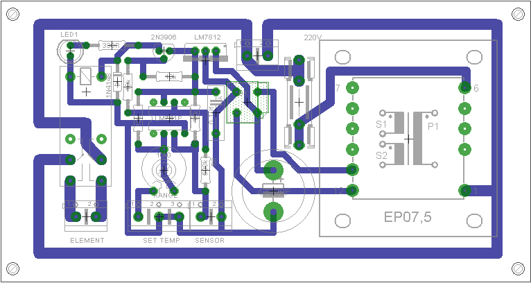

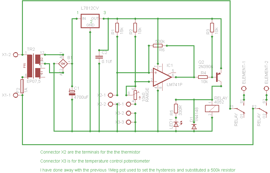

Could someone please cast a critical eye over the attached, specifically;
a) I have added a standard 5mm Green LED and a 330R resistor at the relay as an indicator when the relay turns on. That's 30mA, too much?
b) I think I am breaking serious design protocol by mixing 220V and 12V on the PCB. All the thinner tracks are at ~12V whilst the thicker tracks are 220V.

hi Andrew,
A bog standard led should be 10mA thru 20mA max.
Ensure a wide gap spacing on the wider tracks to any other track.
What current are the 220V tracks carrying.?
Whats the board material.?
Your LED is upside-down. Look at its datasheet to see if it will burn up with 30mA or if it will be very hot and very bright.
The transistor probably will not turn off because the output high voltage of the lousy old 741 opamp is not high enough. Reduce the value of R3 to 2.7k to fix it.

- I connected the LED one way and drew it the opposite. The LED works, for how long not too sure but will buy LED's of known parameters and will alter the LED resistor to suit. The one I used happened to be laying around.
- Current of 0.82A on a 180W element cold.
- Board will be a standard epoxy glass cloth based board, don't know the copper thickness, someone will make them for me.
- The circuit does work as shown, bar for the error on the LED, but will alter R3 for safety sake.

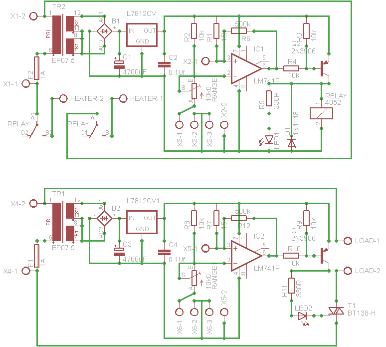

Relay Chatter (Solved) new issues
O.K.
I've had a go, don't roast me. Found a BT138 (I'm sure there are better) and after examining the spec's, don't truely know what I am looking at. It would appear as if the required gate voltage is between 0.7 and 1.5V max whilst the latching current is around 40mA. What confuses me is that constant reference is made to 12V in the specs?
If the gate current is to be limited to 40mA then I would need to limit the current through a gate resistor. Currently the 2N3906 is allowing a 12V signal to switch the relay. If the switching voltage for the BT138 is a max of 1.5V I will need to reduce the voltage accordingly.
I have attached the original with the modified schematic below, am I on the right track?
Cheers
Andrew
