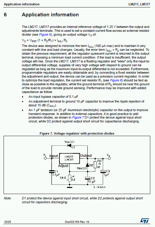

regulator 37v to down volt
Have you built it using exactly the components shown? If so, the voltage should be adjustable all the way down to 1.2V.
what values for R1,R2? Vout = 1.25V (1 + (R2/R1)) + I adj R

Attached below is where Circuits Today stole their info (pretty bad web site, IMHO), but left half of it out....
The full data sheet can be downloaded from here.
The datasheet shows that a 240 ohm resistor can be used with the more expensive LM117 but the LM317 needs no more than 120 ohms if it has no load.
Mike do you think that the circuit I posted is faulty? Maybe the one you posted is right?
Audioguru I did 240ohms as on circuit.
ST Micro did not invent the LM317, instead they simply copied it from National Semi. Both of them say in their datasheets that there is a minimum load current but ST Micro neglects it. The minimum load for an LM317 is 10mA but the 1.25V reference in the 240 ohm resistor makes a current of only 1/25V/240 ohms= 5.2mA so some LM317 devices will not work properly and cause their output voltage to rise when there is no other load and the supply voltage is high. You are simply lucky that your LM317 needs only 5.2mA or less, or that your load current is always at least 5mA.
Load current have to be more cause I am going to use this circuit to charge lithium batteries. I settle output voltage so that lithium batts don't get over charge.

Sorry guys for the trouble today I noticed that I connected the Lm317 pins wrongly .
It's working fine now down to 1.25v.
