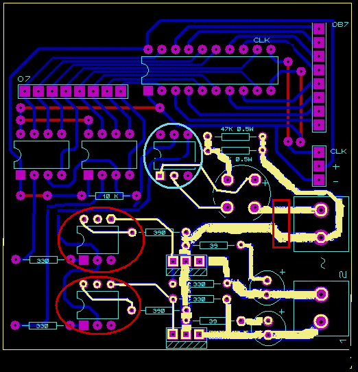

If you rotate the optocouplers circled in red clockwise by 90° and the one circled in cyan anti-clockwise by 90° it should make it easier for you.
The 47k resistors could bridge the mains traces where I've drawn a red rectangle, you'll obviously have to move the bridge rectifier, but it should be pretty simple.

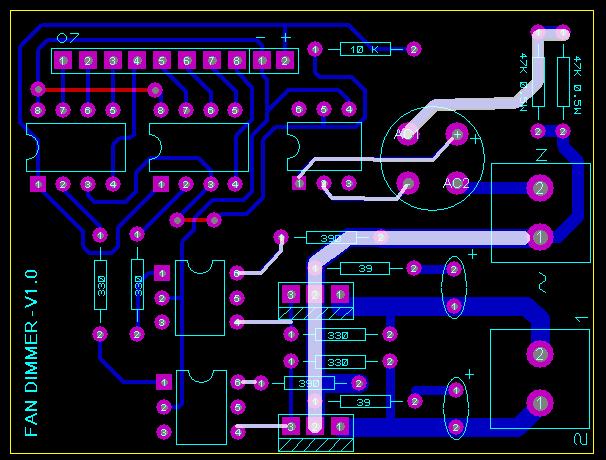

No i meant like should 220 phase and Neutral be also away 5mm from each other?
Yes the trace will be from copper but i thought like maybe from Gauss's law or something the charge might be contained in and not flow out :D (just some guess work)

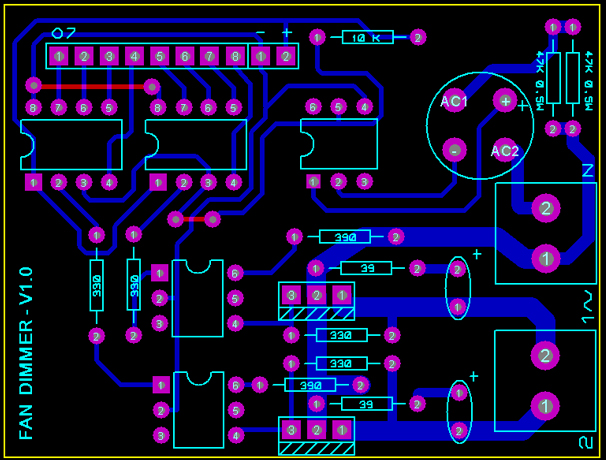

I have actually changed it a bit. Attached is the updated image.
The highlighted Traces are the Mains (220V) traces (boundry)

Oh no, the mains phase and neutral can be pretty close to each other, 1mm is fine, if I remember rightly.
I think you've missed the point about why there should be 5mm between the mains and 5V. The 5V side is a non-hazardous voltage which is safe to touch and will be connected to lots of potentially uninsulated metal parts. Therefore the insulation between the mains and the 5V side needs to be very good. This is because there can be some pretty high voltage spikes on the mains (>2kV) and it's important to protect the user from them. The insulation between the live and neutral is not so important because if it fails the user won't receive a shock, if there's a high voltage spike, it'll just arc over for a split second and nothing bad will happen, the worst case is the fuse will blow.
Your new board layout is much better. The only traces I'd be concerned about are the ones on the opto-coupler next to the bridge rectifier but if you CAD package says they're 5mm away from the 5V tracks then don't worry about it.

59.8mm x 45.5mm are the new board dimensions. I think this is good enough. Actually user will not be touching any parts even from 5V section. It will all be controlled from a microcontroller using a Remote control. Actually some of the traces are 4.5mm apart but i think its still good enough.
