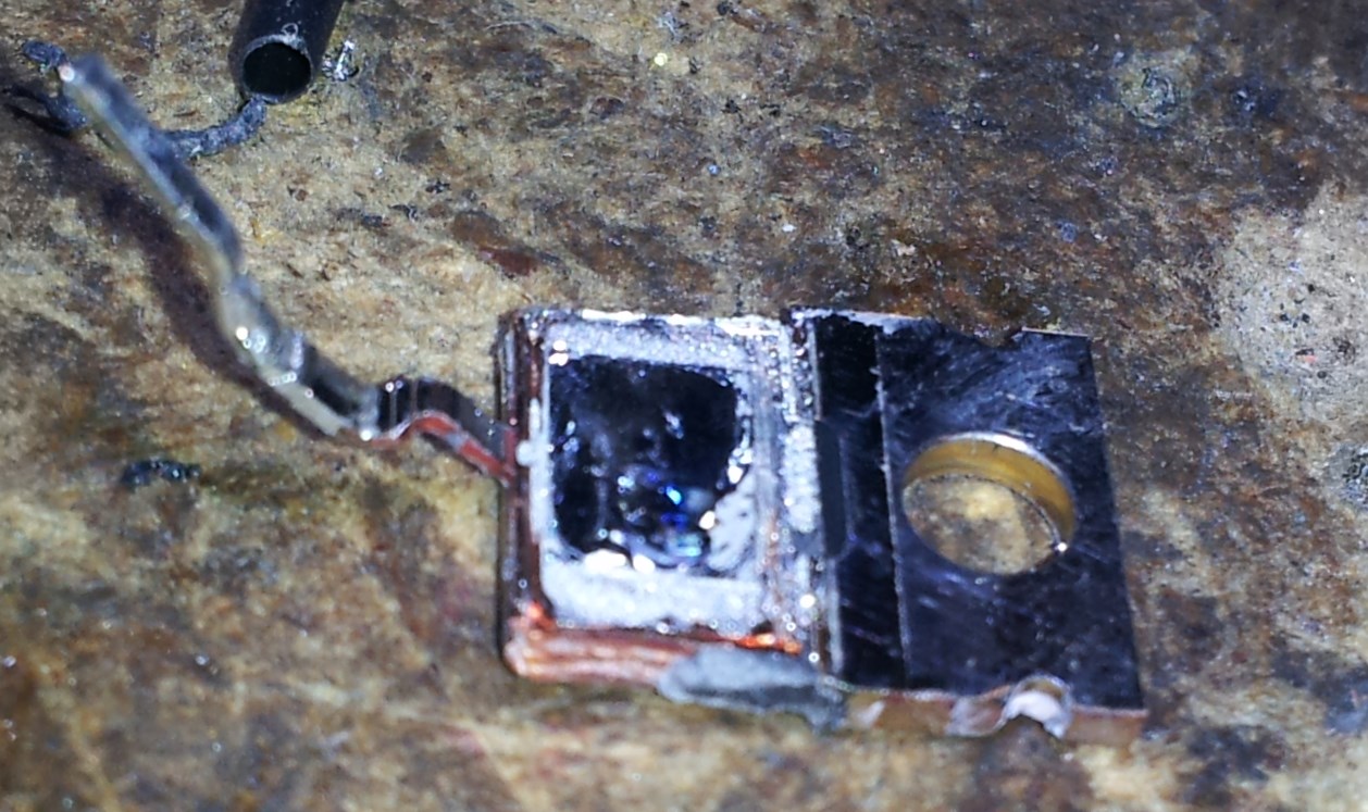

Well I've been very happy with my power supply, the transistor version didn't seem to every fail, just get hot, the new fet model doesn't get hot and I thought it wasn't going to fry FETs, WRONG !!! I left the leads laying on the table, the negative side was driving lights and then they started dimming and flickering and I realize the leads laying the table were shorting out, I tried to get them real quick, but I didn't and by the time I did, the damage was done. When I put it back together, I paralleled 2 FETs, I'm considering putting a high current shut down in it if I kill these FETs. After it was back running, I put the FET in the vise and squoze it and the plastic popped off nicely, I think I see why it is DEAD, Is this MELTED silicone?

Wow that looks nasty, and sorry to hear that it blew up again.
We can add current limit if you like. Sometimes this isnt too hard to do.

I think I know why I was frying the 4905s so badly, no over current at all, I had put a 30 amp fuse in some time back and forgot to change it back. One really nice thing about the external switch is that it take all the punishment and it dies to save the LM2576 and when you buy them in quantity, they are a lot cheaper.

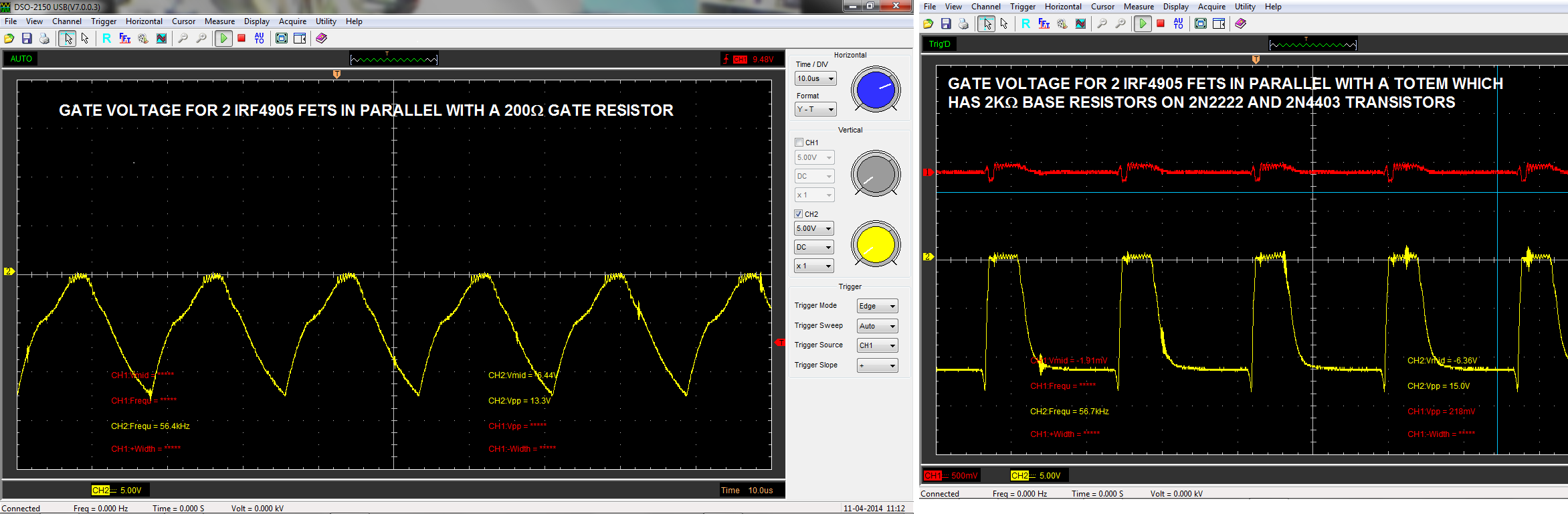

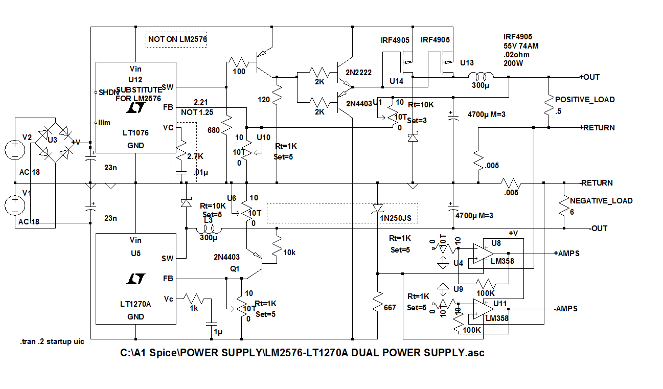

UPDATE, I have lost a few sets of IRF4905 FETs that were used as my switchers for the positive side of my power supply, but I think I let the leads short, they are a lot stiffer than they were originally, any way after lots of help on another subject, Heat Transfer, I changed from a 200 ohm resistor feeding paralleled FETS to a totem that has 2K ohm resistors feeding the base of the 2N2222 and 2N4403 transistors and I think these will last a bit longer. I took some screen shots of before and after of the gate voltage. Here's the schematic and .asc file also
I was pulling 16 amps at ~ 18 volts for the scope shots.
The new drivers look like they work much better than a single resistor, as expected. But why the 2k series base resistors?
what would you suggest, please, I used 2K because I couldn't find my 3K at the moment. My thinking is that 2 or 3 k is low enough to drive it full on and in another place, I've been loosing the the 2N4403 with 25v on it.
I haven't figured this out yet, may not even try to, but I using my power supply to on an H bridge and the bridge caused a short circuit and the power supply died, again. I replace the failed parts and I couldn't get it to work again until I went back to the pre totem design, I made some fet totems out of an 8 pin P & N FET chip and tried that too. I could get the voltage to come up but as soon as I applied a load, the voltage dropped to about 2 volts. This was the case or no voltage or 24 volts for every thing I tried until I went back to the NO totem design. Also, after going back to the no totem design while still in bread board mode, I had it working properly and switched in the transistor totem while lightly loaded and the voltage dropped and wouldn't come back after switching out the totem until I turned it off. I was watching the wave forms on the scoped and it seemed mess up the phase relationship between the switcher and transistor collector and couldn't recover. Anyway, here's the schematic, again, I tried using 100 ohms from collector to fet and it became unstable as load changed, so I stayed with 2oo ohms and the voltage stays pretty steady. I also tried a TIP125 darling in place of the TIP42c and that didn't seem to help either.
