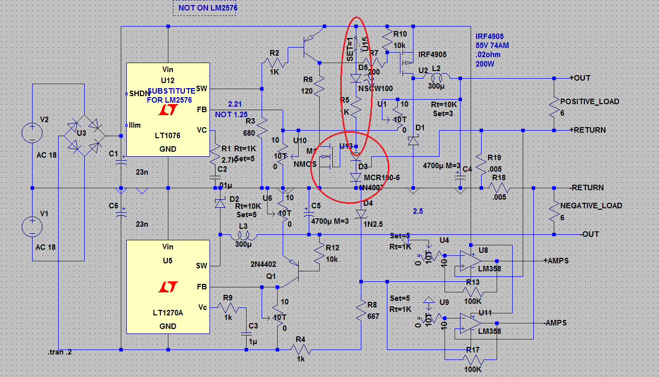

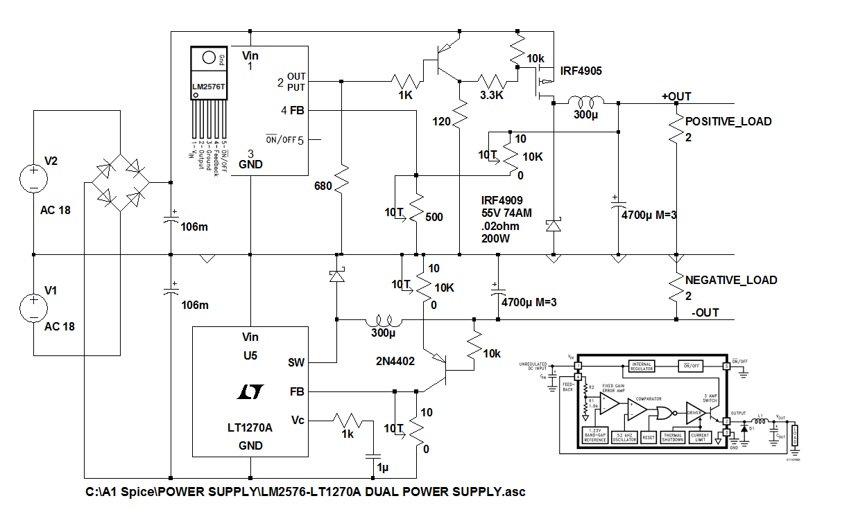

I don't remember if NPN worked or not, I'll try to test it tomorrow, I'm building a negative regulator. It's interesting how easy it is to get the negative voltage, same circuit, just move the negative feed, (ground) to the point between the inductor and the capacitor. A problem I have is the lack of higher voltage power supplies. I do have a Variac and I guess I could put a bridge on that. But that has no isolation. I got to see (hear) a 22uF 100V cap fail today, haven't found the canister and there was paper everywhere. I kind of think it got hot because of it's proximity to the 100 ohm resistors.
I just simmed the circuit with a NPN and it does run, (last attachment)
Since I'm always hands on with my power supply usage and it does have definite limit, I don't think I'm going to worry to much about current limits, If I find a need for it, I'll just use a LM317
Yes be very careful for sure. See if the PMOSFET gets hot too. But then again for much higher DC buss level you'll need a higher voltage PMOSFET too. Hope you have one around.
I like to stand back several feet when i do tests like this.
When the solder that is holding the wire to the FET lead melts and lets the wire disconnect, THAT's bad, isn't it! Also means the FET is probably DEAD. OH well, I got plenty of that FET, any way, I watched what was happening with the LM2576 and changed my circuit and now it seem to be running well. One strange thing that I haven't figured out is that with THIS dual voltage power supply, if I run from the Neg out to the Pos out and bypass the common zero out, it causes the FET on the Pos regulator to get hot. I only tries it once, without melting solder, but that's what I was doing when I melted the solder. The negative side seems to be work real well, I'm very happy with it and satisfied with the positive. I have some binding posts coming and still debating what type of current monitor to use, current sense resistor or LEM Current Transducer HX 03..50-P/SP2 that uses hall effect.n It's all just for fun any way. More photos at https://www.dropbox.com/sh/wfpkr5w0hcrz7a2/RoElm-fUVF

Well for one thing the resistors connected to the IRF4905 seem a little too high for driving a mosfet in a switching regulator. Typically we want very low impedance drive and that's why we end up using a special mosfet driver chip sometimes. If you lower those values (provided that is possible with the driver for those) the PMOSFET should switch faster and so less heat. If any of the mosfets switch too slow they can cause lots of heat which not only wastes energy but makes them overheat and burn out.
You could check the rise and fall times at the gate (very carefully) and see what those look like.
The power loss during switching is due to the rise and fall times of the gate and thus the source/drain. The output then looks like a ramp which consumes energy and makes the mosfet heat up more. When the mosfet is fully turned on or fully turned off there is little power lost, but during the switching transient there is power lost. There is one switch transient to turn on and one switch transient to turn off, so there are two important times to consider for each switching cycle.
It helps to know how much of the total cycle time is taken up by the switching transient times so we can express that as a percentage of the total cycle time. For example 10 percent is not as good as 5 percent because more power is lost in the MOSFET.
An estimate for the switching power dissipated in a transistor that switches on and off many times per second is:
P=Imax*Vmax*p/3
where
Imax is the peak current,
Vmax is the max voltage (usually the power supply voltage), and
p is the percentage of the switch time relative to one complete cycle,
assuming the turn on and turn off times are roughly the same.
So for example if Imax=20 amps and Vmax=24 volts and it takes 10 percent of the total cycle time to switch on or switch off completely, then the power due to the switching is:
P=20*24*0.1/3=16 watts.
For the LM2576 which switches at around 50000Hz, that would mean each switch transient would take 2us and the total period is 20us, and 2/20=0.1 even though the 2us occurs twice per cycle (that's just the way the formula is formulated).
So to be clear, that means 2us rise time and 2us fall time and a total period of 20us for that example above which means the transistor would have to have a decent size heat sink.
Of course reducing the rise and fall times means reducing the power, so reducing to 1us means half that power or just 8 watts, and 500ns means just 4 watts, etc.
This is also the maximum power and in a buck circuit it could easily be less depending on the output voltage setting too. But for any given setting the power does reduce by half when reducing the rise and fall time by half.
Note that a small package without a heat sink may only be able to handle 0.75 watt without getting pretty hot. That means we'd have to use a heat sink or reduce the switching times or both.
Resistors as high as 1k can easily cause rise and fall times to be as high as 1us or more, so gate drive resistor values that high could cause overheating problems.

Played around with my positive voltage, you're right R collector to gate was too high, ended up taking it down to 200 and the FET stayed cool after that. That's where I'll leave it, now for the amp meter circuits. I did see that if I jumpered from collector to gate, my output voltage under load was only 11.8 +- volts.
Deleted a bunch of photos and added scope screen shots with notes.

Some nice pics there. I can see the last pic looks like the waveforms are much more square with the 200 ohm resistor. That reduces the power consumption in the MOSFET quite a bit. The original had very poor rise and fall times so that's a vast improvement.
I also see a pic with what looks like some oscillation. I have to wonder where that came from, how that happened. We definitely want to avoid that.
MOSFET driver ic's typically can deliver a 1 amp or more pulse to the gate which turns it on or off very very quickly without wasting too much power otherwise. Low values resistors use more power but if that's not an issue then i guess it doesnt matter that much. For a bench supply i would do the same thing if i had to.

One of the reasons i wanted to try the LM2576 mods with the MOSFET is so that i could get the efficiency up much higher for a high efficiency buck circuit to convert 12v to 5v. With the present internal bipolar the efficiency using the chip alone isnt that good even with just 2 amps output (maybe around 80 percent if lucky). I'd like to get up to 90 percent or better for battery operated equipment. Since the MOSFET can be made to turn on and off so fast and with little voltage drop, i think this can be done using one fo the mods like with the PNP or the NPN or similar.
A second application would be an offline 120vac to 14vdc converter, where the MOSFET would have to handle 170vdc and step that down to around 14vdc. But this would be higher current like 20 or 30 amps too. Using an inductor rather than transformer, this would be non isolated. Using a higher frequency transformer and opto coupler feedback it would become isolated.
I'm finished, for now anyway, the final screen shots were taken of 10 amp from Neg to Pos with no common, IRF4805 stayed cool, I could keep my finger on it after a minute's running, heat sink was cool also. My amp meters are a bit disappointing, as the vary and not real accurate, but I'm very happy with the rest of it. Especially because it stays cool as opposed to the heat it put out before just driving some LED light that I use on my bench, one has a LT1270 driving 4 10 watt LEDs in series, ~40 volts @ 1 amp, and the other is the 4 3 watt LEDs in series with NO limiting resistor that everyone says won't work, but it does, nicely!! (I'll add a photo of it tomorrow)

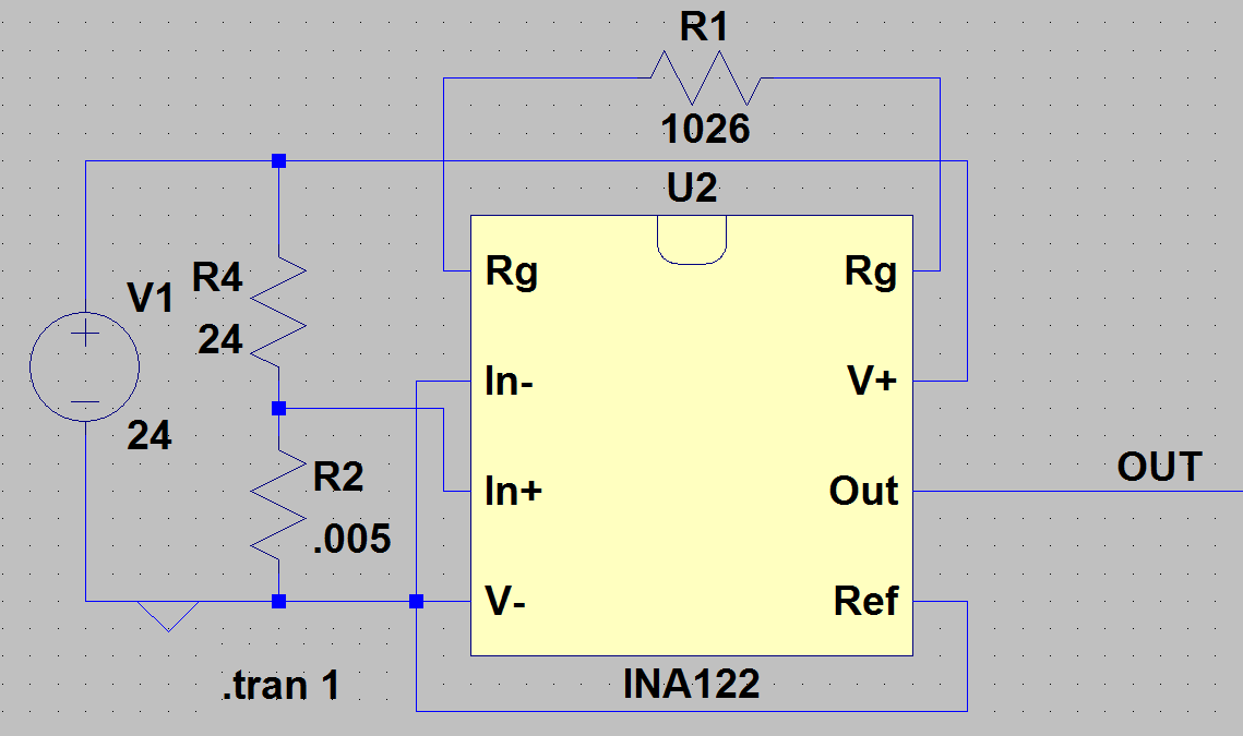

What am I doing wrong with my instrument op amps. I down loaded the zip file for INA122 files from TI, unzipped it and then copied the ina122.lib and pasted it into the ina.lib so it would show up in the [Opamp Add] list in spice. The bad thing is that it's actions in spice are about the same as I get for real. To me, what I have is just like the data sheet shows in fig. 6 page 9. With the setting I have, one amp through the current sense resistor, I expect 1 volt out, not a - .52v and it doesn't change as the current is changed.

If you have everything hooked up right then it must be a problem with the model. The model is a little complicated so it's not easy to spot anything wrong or not compatible with LT Spice.
If you have a real device at home you could try this on the bench and see what happens. If it works better, we could build a simpler model out of regular op amps or an ideal model just to get it working in spice.
To make your own model, try using the internal diagram with two low input offset op amps as they show on the data sheet. Use the same value resistors.
If that works then there is something wrong with the model in the zip file.
From what i read it should give you a gain of around 200. That means with 1 amp through 5mOhms is 5mv and that times 200 is 1.000 volts which i think is what you were looking for and that does sound reasonable.

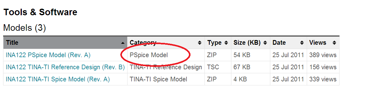

I guess i will have to try to add that model to my LT Spice too and see what happens. I'll try to do that today sometime.
Maybe this is my spice problem, PSpice model in LTSpice, not sure how compatible they are.

Yes maybe that is the problem. I went over the data sheet and i see the offset can be as high as 250uv but that would not cause such a large error like you are seeing.
Are you sure you got the pin assignments all correct?
I tried to enter the spice model into MicroCap simulator and it messed up all the models. Something must be wrong with the file or it is not compatible. Not sure what is causing this.
I have be trying to may a 200 gain amp all day, I used INA122s, INA128, TLC2274, LM324, and failed miserably with all. Nothing seemed to work. What I am doing is trying to use the .005 ohm (how do you use the symbols at the top of the page?) I bought to get the amperage, one end is grounded and that seems to mess with every thing, so if you have a schematic for that, please let me know.
You should definitely be able to get this to work with an LM324 but with that op amp you'll have to modify the spice file to set the offset to zero or much lower than it may appear in the downloaded file. That's because the LM324 spice model probably has a 2mv offset which is WAYYY too much for your application that needs to sense 5mv.
But the circuit shown on the INA122 data sheet will work if those 25k and 100k resistors are added to two op amps as shown (somewhere on the data sheet).
If the LM324 spice file is not changed however then it may look like there is a huge error in the measurement. Alternately find a very low input offset op amp in the LT Spice files.
I could post a circuit but it would be the very same one on the data sheet for the INA122.
If all else fails you could use a voltage controlled voltage source with a gain of 200 and assume that the INA122 device works properly in real life. That will at least get you going. That wont simulate frequency response though.
Earlier you said something about oscillations, I think it's just a spice error, rock solid in real life. Had my first failure today, voltage was turned up to near max, + side, and the leads shorted momentarily and the 4905 died shorted. I also think part of my problem is the use of TLC2274, it's only rated for +- 8v or 16. Found a LM358 (half of LM324) and fed it with + - 13 derived from zeners and had my best results from that. Occasionally I pull more current than can be indicated by the just under 13 volt supply, so I'm thinking to unbalance the feed for the LM358 to 24+ & 5- . Any idea what I should expect? spice says OK
