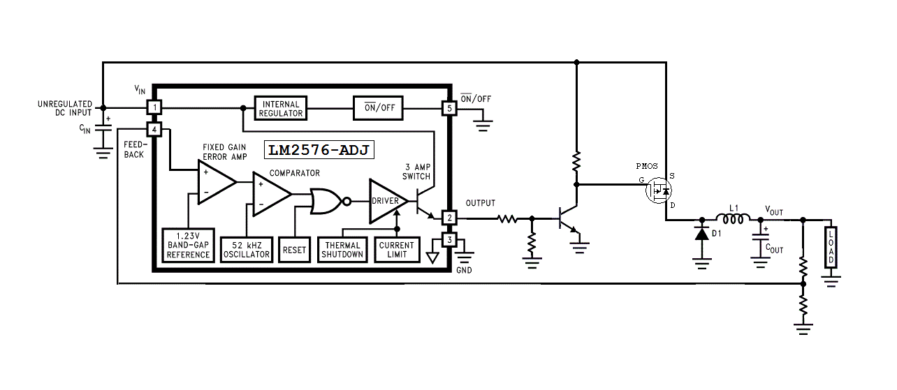

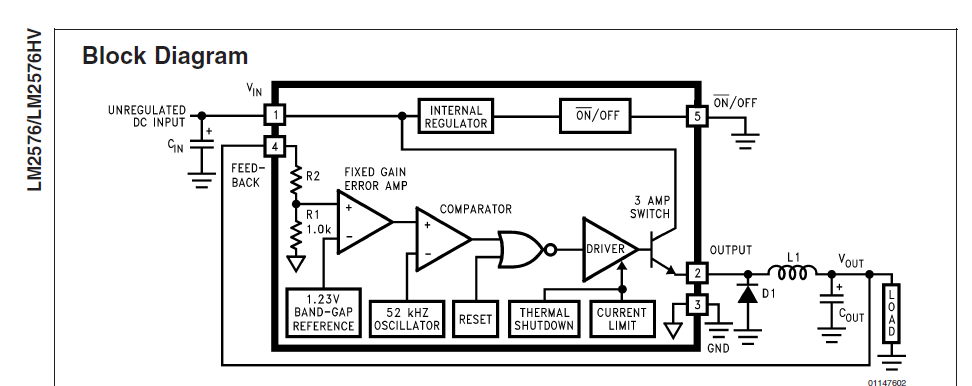

I am posting my first thoughts on this project of using the LM2576 to drive a PMOS and thus obtain more
output current and still have the nice control of the LM2576 to look forward to. Keep in mind this
is like a preliminary drawing that i am using to illustrate the basic idea, although from your text
you seem to have a good grasp of this already.
Are you saying you tried something like this already? Note that i used an inverter too but the resistors
that load the internal drive transistor would be small enough to draw some significant current, maybe
at least 100ma or more, even 250ma perhaps, im not sure yet. The LM2576 has to think it is working
as usual. If that means connecting a small inductor too then so be it, if that's what it takes.
Alternately we could look for a controller IC and go from there.
I've also looked at inductors in parallel, but for some decent inductance like 100uH it takes quite
a few inductors. To double the current rating of a single 100uH inductor, it takes a total of
four inductors of 100uH to get the same inductance. So if we had four 100uH 5 amp inductors, we could
make ONE single 100uH inductor that had a current rating of 10 amps (that's twice one inductor rating).
That still might get a little expensive. Of course if we had two 200uH inductors at 5 amps we could do
it with two inductors, but they would be more expensive than the 100uH inductors in some cases.
So maybe a parallel setup would be better where we build several smaller units and parallel them. We'd
have to make sure the complete circuit is stable then and solve any problems that might come up with that.
Take a look at this schematic and see if that is what you tried or not. Let me know so we can figure out what to do next.

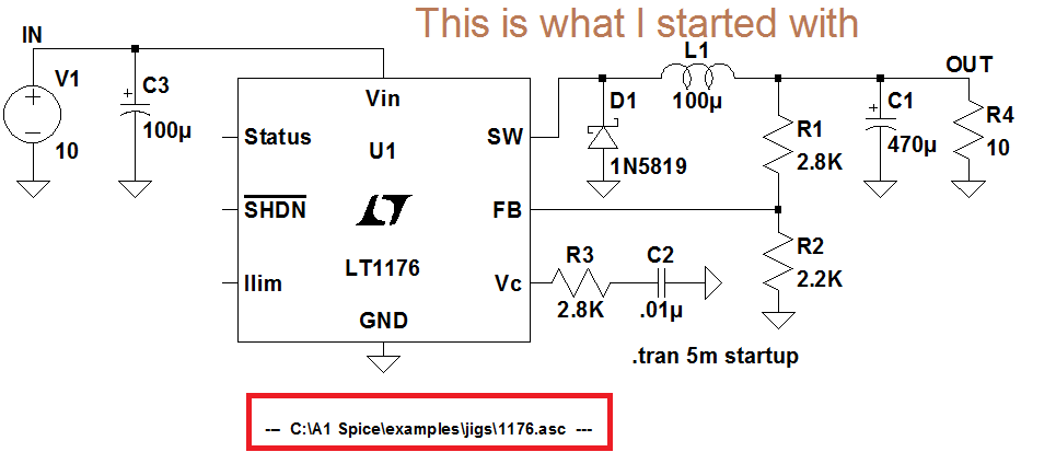

couldn't find a model for LM2576, so I searched Spice and found the following and modified it and I appears your design will work
I'll let you know this evening, 6-11 hours,
  • MC34063_buck-4905.asc

The model came from a search of spice for "buck" C:\A1 Spice\examples\LtSpicePlus\Smps\OnSemi\
change .txt to .lib on mc340683 .electro-tech-online.com won't let me load it a .lib.
I ran into the mc34063a while writing this, it's pretty good and sims too. but it doesn't show any switching.

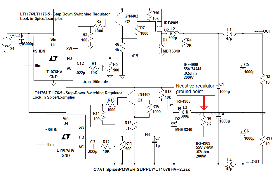

we did it!!!!
more later
Please explain what's not correct and which drawing you're talking about.
Well actually i dont think i see any circuit yet other than the one i drew myself that might work with the LM2576. Is it that you dont want to try that IC with the external MOSFET? Just wondering that's all.

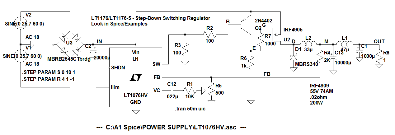

This unit was holding 18 volts at 9 amps, the load got hot, but the LM2578, IRF4905, Diode and Transistor stayed cool.
The 100 ohm resistors got hot too, they need to be 2 watt or better, look like a good design! Now to do the same for the negative side of my power supply

Short answer is yes, I thnk so, long answer, If I remember correctly, & I think I do, Pin 2, output, starts out High and turns the NPN on so the FET is on also. With the PNP, the output turns it off and the FET is off until the output sends its signal out. Also, if you look at the two screen shots of my scope, I had to switch to AC because it couldn't be seen on DC because it was on top of 24 volts. Sorry for not documenting everything, but I get going and don't take time to write it down as I go from one possible solution to the next, and then, I have it working and have to try to remember what I did to get here. Added some photos https://www.dropbox.com/sh/wfpkr5w0hcrz7a2/RoElm-fUVF . The drawing in post 75 is accurate except for the output filter and as you can see, the 100 ohm, 1 watt resistor do get HOT. Got any specific tests you would like me to make?

I don't remember if NPN worked or not, I'll try to test it tomorrow, I'm building a negative regulator. It's interesting how easy it is to get the negative voltage, same circuit, just move the negative feed, (ground) to the point between the inductor and the capacitor. A problem I have is the lack of higher voltage power supplies. I do have a Variac and I guess I could put a bridge on that. But that has no isolation. I got to see (hear) a 22uF 100V cap fail today, haven't found the canister and there was paper everywhere. I kind of think it got hot because of it's proximity to the 100 ohm resistors.

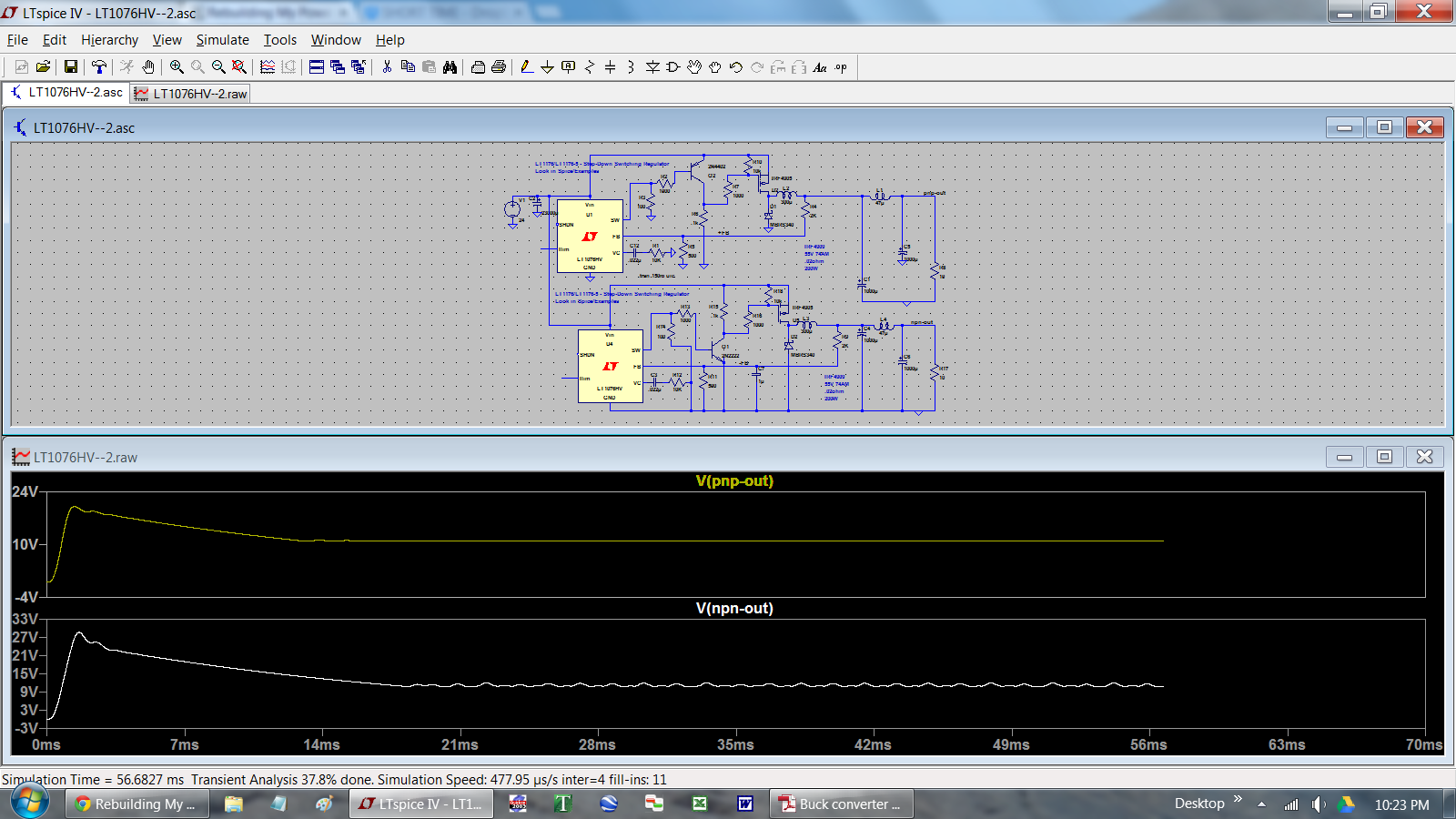

I just simmed the circuit with a NPN and it does run, (last attachment)
Since I'm always hands on with my power supply usage and it does have definite limit, I don't think I'm going to worry to much about current limits, If I find a need for it, I'll just use a LM317
