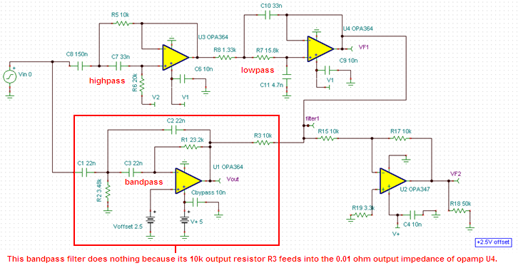

Here is Crutchows circuit but my results are way different??
Will recheck the schematic again but so far havn't found any discrepancies electrotech1..PNGelectrotech sche&#10.PNG??

You show a green trace from a highpass filter but your schematic has a different highpass filter.
You don't know what you are doing and we also don't know what you are doing.

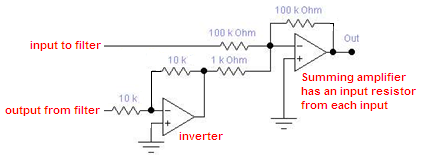

Now you have the output of a bandpass filter U1 feeding a resistor R3 then R3 feeds into the extremely low output impedance of an opamp. The signal from R3 is shorted and does nothing. You can sum it with the output of your lowpass filter if your summing amplifier U2 has an input resistor from the lowpass filter. I don't know what the result will be.

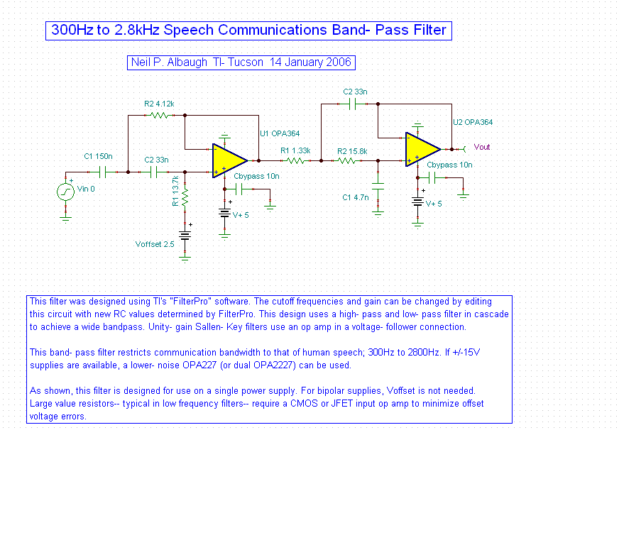

Crutschow made a lowpass filter in series with a highpass filter (but it doesn't matter which one is first) making a bandpass filter then he inverted its output and summed it with the input.

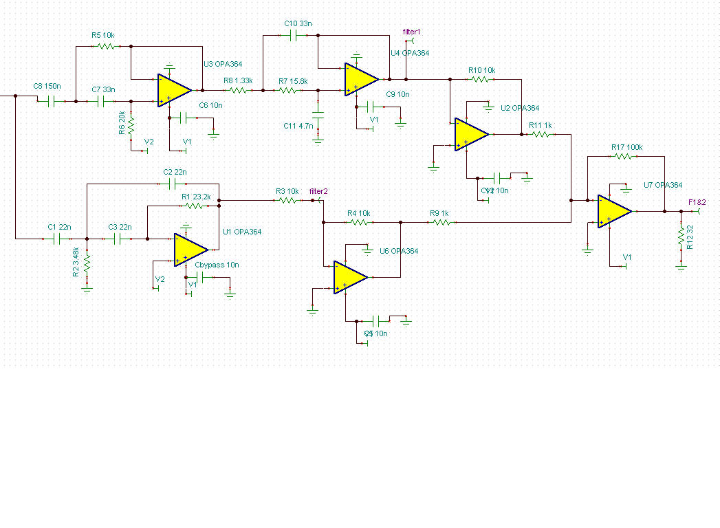

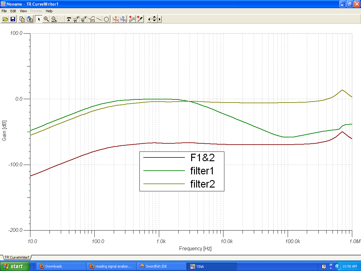

Sorry about that

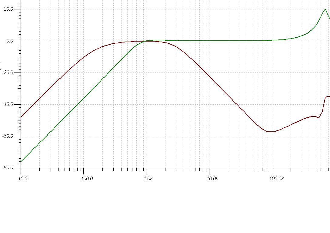

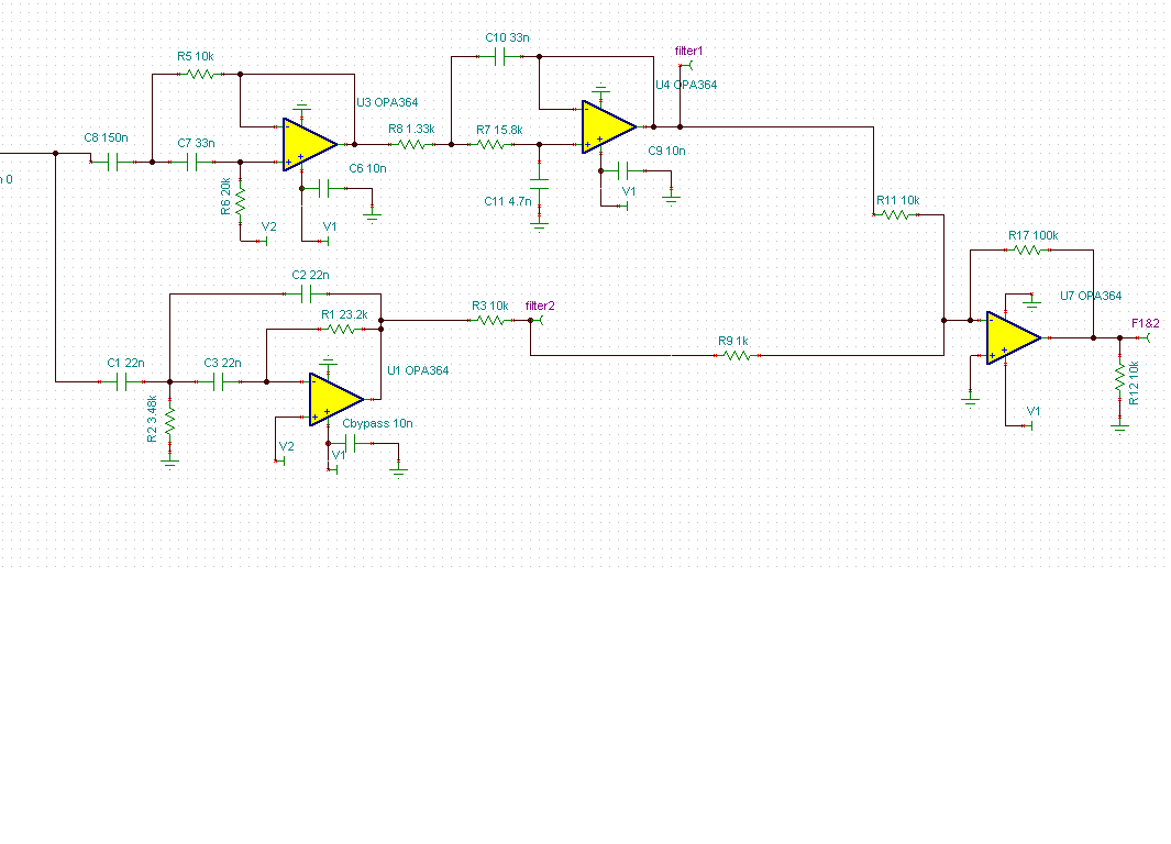

Here is the graph with labels using a signal analyzer
also reconfigured circuit for summing amp as per suggestion

I was wrong. Your U1 is not a Multiple-Feedback-bandpass-Filter. Instead it is actually an inverting 2nd-order highpass filter.
Why are you inverting it then summing it with your lowpass in series with a highpass bandpass filter?
Now im lost??
U1 filter is all by itself then U6 I assume is part of the summing amp as you posted? or did I misinterpret it??
All the filters came from a TINA example file.
I thought inverting amp had the input connected to the + input. TYhats the way the filter was derived from TINA file.
Will locate orgin and post.
circuit from TINA
here is the filter I am using. The bottom filter I posted earlier I need to locate
U1 is an inverting 2nd-order filter followed by U6 which uis an inverter. If you made U1 a non-inverting filter like all the others then the inverter would not be necessary to do the same as your circuit.

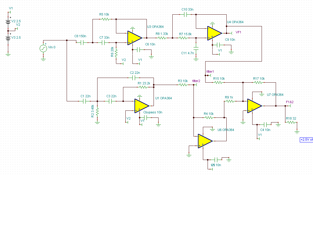

revised circuit
are the results what you expected??

The signal that you call "filter 2" is the input pin of the inverting opamp U6 that has no signal voltage.
Instead, the output pin of opamp U1 is the signal "filter 2" or you could show the signal at the output pin of the inverter U6.
As you can see at the output, the U1 and U6 opamp circuits simply attenuate the other signal so are absolutely useless.
well we dont want to kill the signal so do I insert another op amp to separate the outputs of U6 and U4 (kinda like a buffer?) or how to combine the two signals or do we want to (I guess if its to be connected to an amp the signals must be combined?)

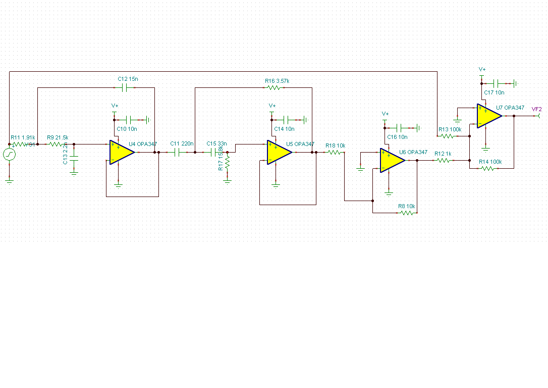

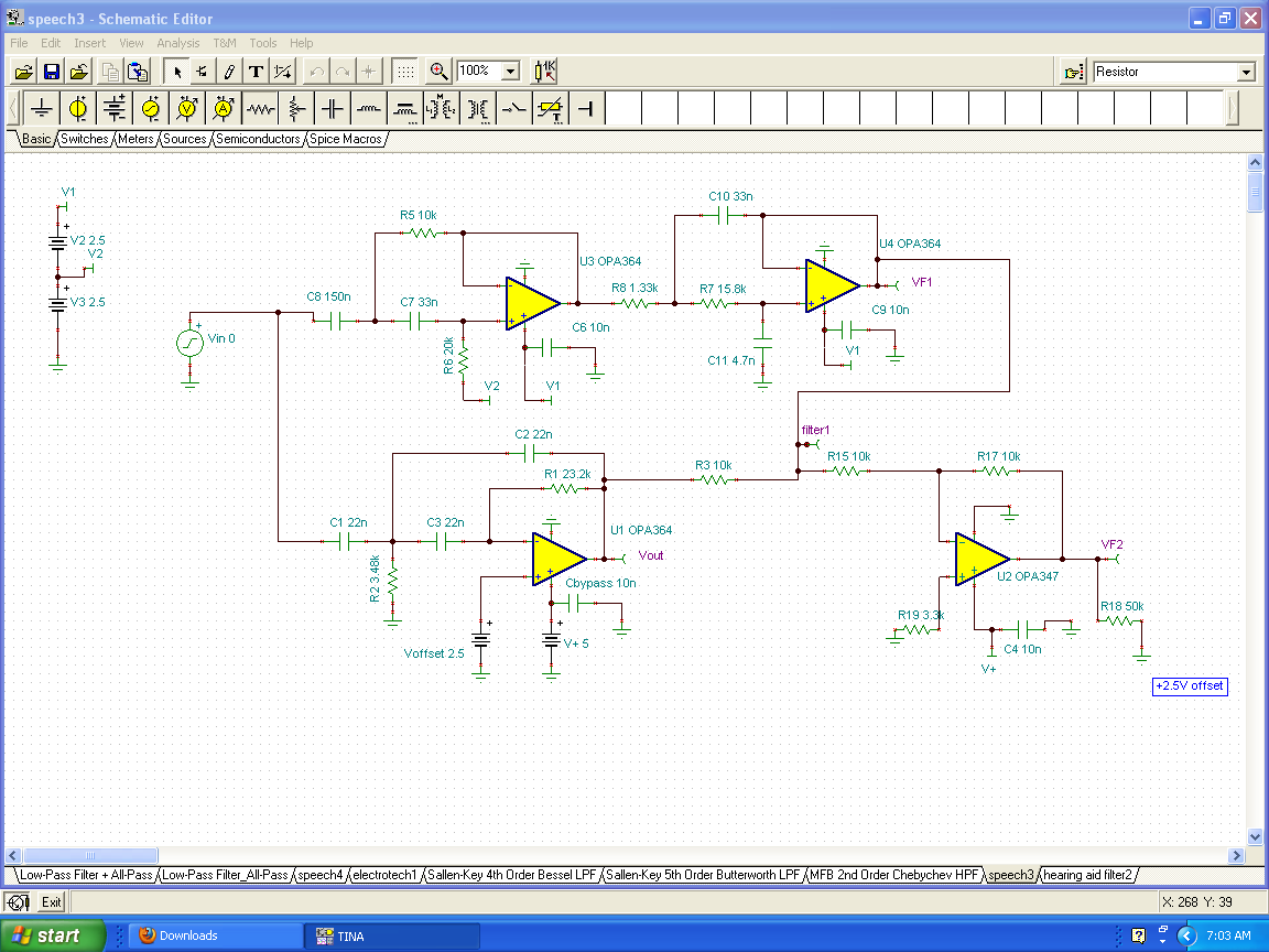

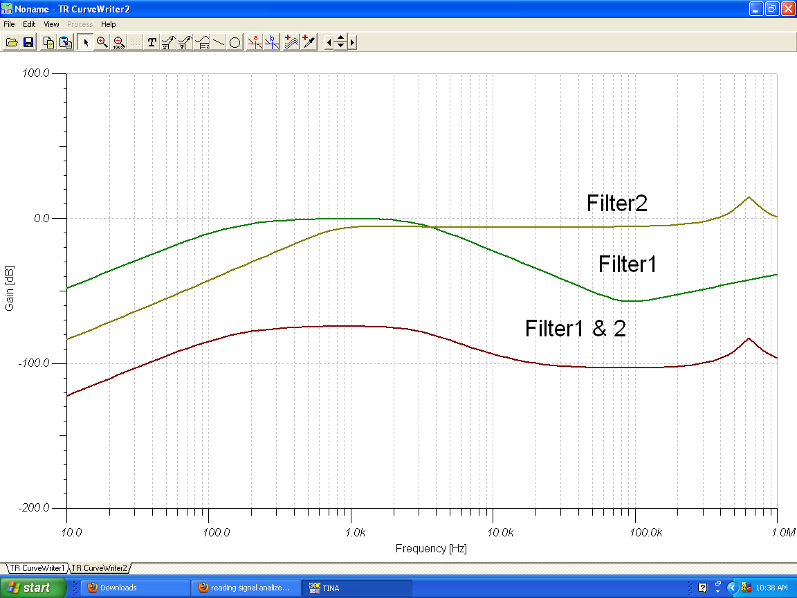

revisions looking better??
changed a few things around. Didn't see the 100k gain resistors

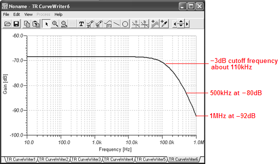

Isn't the combined output of the two filters supposed to be 0 db but its way down at -100 or is this correct so that the amp will perform right?
The output level is almost nothing because the output resistor R12 is almost a dead short at only 32 ohms. An opamp can drive 1k ohms with difficulty. Use 10k ohms.
Also causing the output level to be too low is because the upper bandpass filter and the lower highpass filter which has an inverter have opposite phases and they cancel. Try it without inverter U6 then maybe the filters will add instead of subtracting. Then the output of U1 drives R9. But maybe if you remove inverter U2 then inverter U6 might be needed.
You added inverter opamp U2 (an inverter, not a buffer) which is missing an input resistor so its input is a dead short to the output of U4. If it has an input resistor then it is an inverter which might not be needed. Try it without U2 and with the output of opamp U4 driving R11.
R9, R11 and R17 cause summing opamp U7 to have a gain of 100 which is much too high. Increase the values of R9 and R11 to 10k for a gain of only 10.

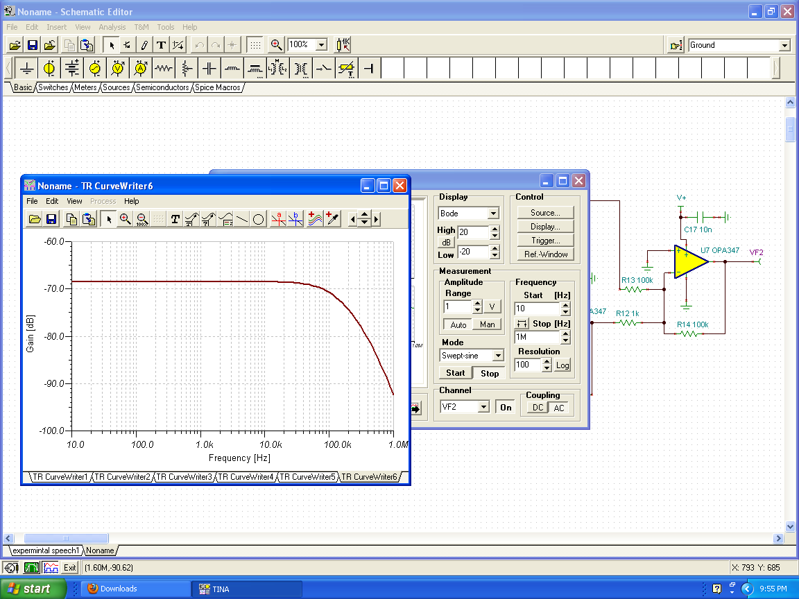

looks different
made revisions as suggested.
The combined is still below 0 db. Is this desired?

The output now has a loss of almost 80dB so its level is only 1/10,000th of the input level. Maybe it is still cancelling the signal because U1 is still an inverting filter.
Why are you summing the non-inverting highpass/lowpass bandpass filter at the top with the inverting highpass filter at the bottom?
