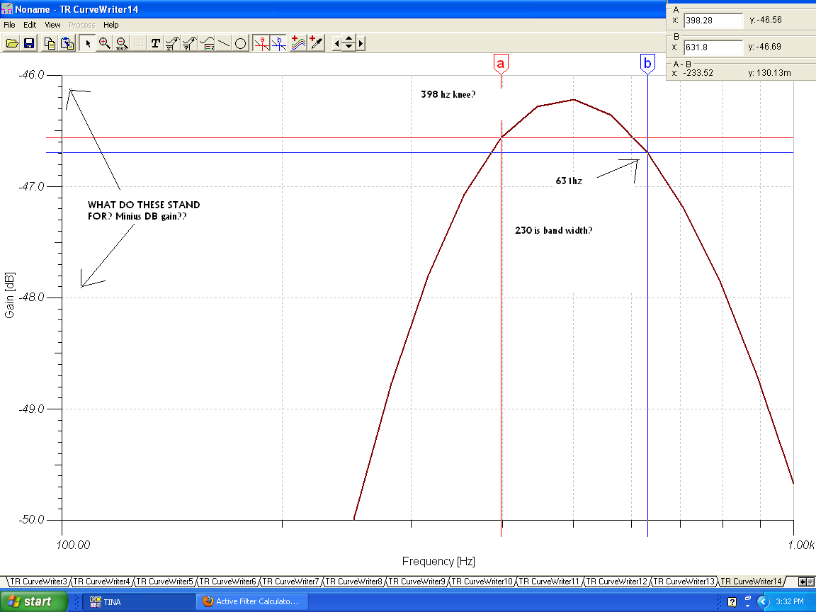

Am running all sorts of filter configurations for a DIY hearing aid.
My audiologist says 250hz to 4.3khz with 60-70 db loss.
well in running simulations in TINA I can kinda figure out the bandwidth and center frequency but why is the db measurment say -40 etc. ALL minus signs?

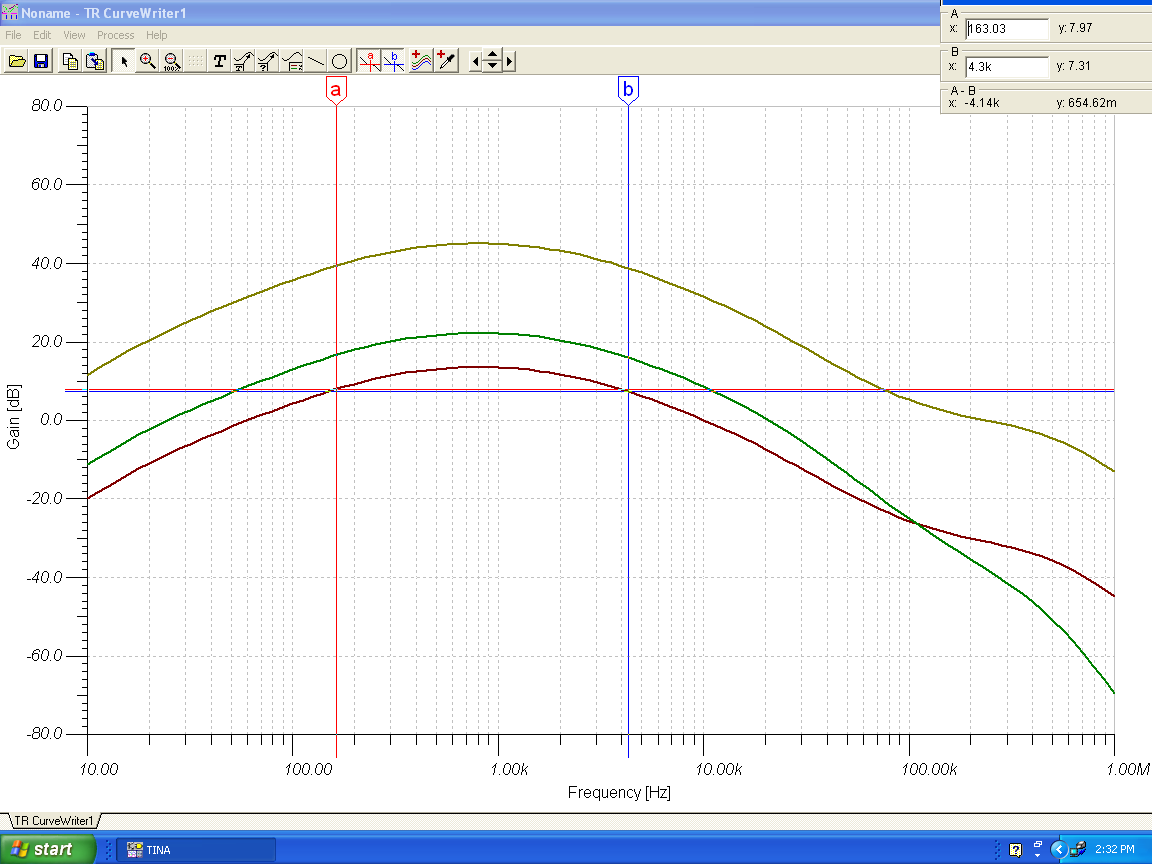

Here is a screen shot of a speech filter combined with a sallen filter. Looking at the screen I think it tells me the green trace (both combined with summing amp) that I have a 140 - 4khz bandwidth or ??
did I interpid this right??
230 bandwidth but what is the db gain being mius??
why??

Do you want no bass and no treble?
Don't you want "normal" frequency response instead of this muffled and thin telephone quality?
The gain is low because adding a narrow bandwidth highpass filter with a lowpass filter reduces the gain at all frequencies.

So, getting back to your original question (one of them anyway)
Because there is a lot less coming out of the filter(?) than going in, it has lots of loss.
This is probably good on the skirts of the filter, what the loss is mid band I cant easily see as I am typing this.

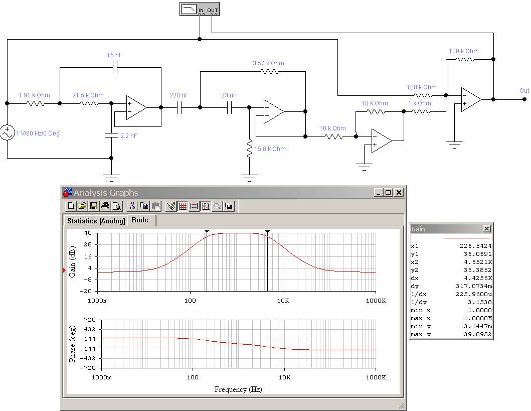

I will see if I can add a High Pass filter
What is considered a LOW PASS? anything below say 200khz?
If so Maybe I can add to filter.
I assume using a summing amp to combine all 3 filters together?

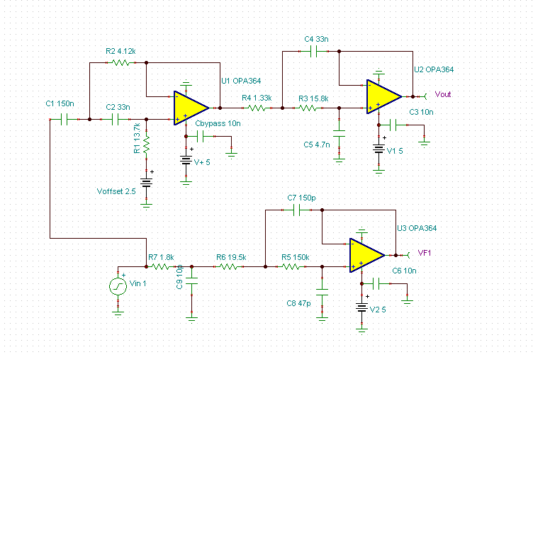

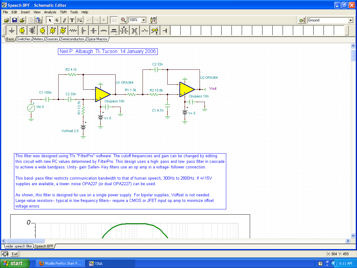

Found another filter that looks very promising.
see attached. It goes from 300hz to 2.8hz.
Need to compare the OPA 347 vers the OPA 364 op amps

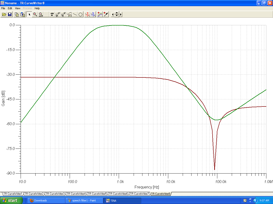

revised wave form
circuit and wave form in TINA
wish I could get Filter Pro working. Keep getting an error??
Is this what we want? A low pass filter (red) and a mid-range frequency filter?green

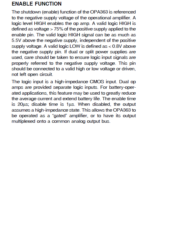

Enable feature
I knew Audioguru is at the top of his game. That's why I listen to ANY and ALL of his suggestions.
Now I saw this feature on the OPA4364 and wonder if I can use to turn off the hearing aid upon a loud noise?
How to determine at what noise level to turn off?? and how. Could use a PIC perhaps??
ADC method??

Hi MrDEB,
If you want to amplify frequencies from 200Hz to 4kHz then do so.
You have a 2nd-order 300Hz highpass filter feeding a 2nd-order 2.8kHz lowpass filter. Its bandpass output is from 300Hz to 2.8kHz like a telephone or AM radio.
Then why do you have a separate 3rd-order 12kHz lowpass filter?
You cannot sum filters together. When you do, you get a notch filter (due to phase-shifts in the filters) like you see at 90kHz.
The signal can be fed through a resistor normally without attenuation. Then when a very loud sound is detected by a comparator it turns on a transistor or Jfet that shorts the signal to ground, attenuating it. The comparator can have an adjustable reference or a dynamic reference.
If I understand correctly, the OP would want a circuit with a flat frequency response for the high and low frequencies and a gain for the frequencies between 250Hz and 4.3kHz, where there is a hearing loss. This could be achieved by connecting a single 250Hz to 4.3kHz bandpass filter output into a two-input summing op amp that has the unaltered signal as its other input. By adjusting the relative gains of the two inputs, you should be able to achieve the proper frequency response to compensate for the hearing loss.
An easy way to do the filter design is to use the FilterPro free software from TI. Use the "Wide Band-Pass' option.
Below is a filter from FilterPro with a summing amp. The filter consists of a Salen-Key high-pass and low-pass filter in series to achieve the bandpass. This is summed with the input signal to give the flat response outside the bandpass. You likely will have to adjust the filter and gain parameters to get the exact response you want.
Note: Depending upon the relative phase of the filter output, you may have add an additional inverting op amp to invert the phase of the signal to avoid a dip at the edges of the bandpass where the summed signal transitions to a gain of one. I had to do that on the attached circuit.
