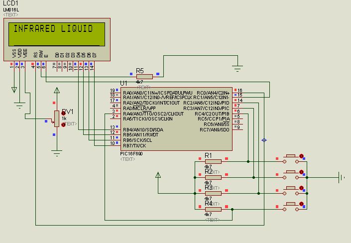

READING A PUSHBUTTON & display on LCD
im not sure if its just the LCD in proteus but i had to change he LCD INIT to:
	lcd_cmd(0x02);
	lcd_cmd(0x08);
	lcd_cmd(0x02);
	lcd_cmd(0x08);
	lcd_cmd(0x00);
	lcd_cmd(0x06);
	lcd_cmd(0x00);
	lcd_cmd(0x0E);
	lcd_cmd(0x00);
	lcd_cmd(0x01);
I made a few changes to the code in which the increase and decrease buttons were working....

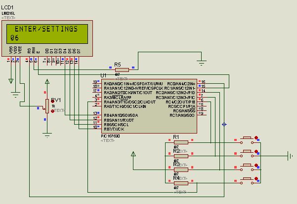

when i power on:
it displays "infrared liquid level detector"
then it displays "ENTER/SETTINGS"
BUT NOW its not repeating continuously and stops at the enter settings screen.......
when i press increase it increases
when i release increase it is stable
when i decrease it decreases
when i release decrease its stable
however pressing HOME and enter/settings has no affect

oh gosh i dont know why my ADSL is slow today. Sorry
here is the LCD part of my report that i have to submit when im done with the entire project:
here it is.................
  • LCD.doc
#define LCD_RS RC0 //LCD RS pin
#define LCD_EN RC1 //LCD EN pin
Rb7 Rb6 Rb5 Rb4 are connected to 14 13 12 11 of the LCD respectively
This works great in protues but since my line 2 doesnt work i cant see the actual digits but in MPLAB i can see they are in fact increasing and decreasing:

Here is it in proteus: (second line wasnt working tho)
lcdhelp01-jpg.33369
EDIT:
Forgot to note since i redid my PC (had a issue so reinstalled windows) i forgot to install Office(open office not ms) so im installing it now to see that lcd.doc stuff
got line 2 to work with this init. its the same as yours but i had to tell the lcd first that we are using 2 lines. You should try it as to avoid errors in future:
void lcd_init(void)
	LCD_RS = 0;
	LCD_EN = 0;
	DelayMs(20); //wait for LCD startup
	lcd_cmd(0x02);
	DelayMs(5);
	lcd_cmd(0x28);	// 4-bit mode
	lcd_cmd(0x08);	// display off
	lcd_cmd(0x01);	// clear display
	lcd_cmd(0x0C);	// disp. on, cursor off, cursor blink off
	lcd_cmd(0x06);	// entry mode
	lcd_cmd(0x80);  // initialise DDRAM address to zero
lcdhelp02-jpg.33370
