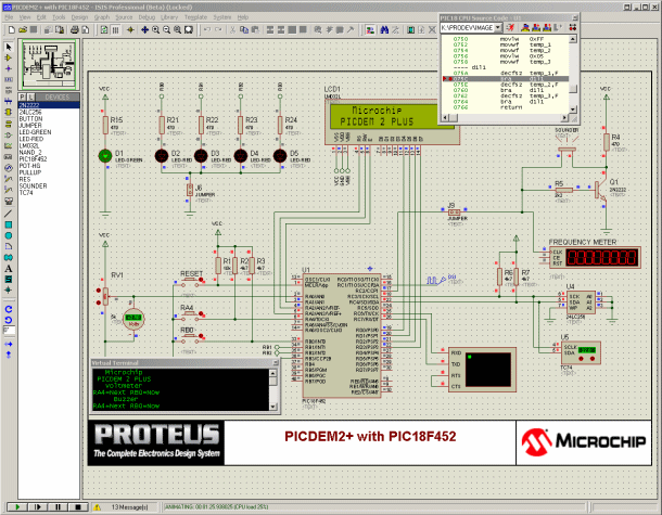

Do you think its possible to use Proteus to simulate? Ill have to make a schematic tho :(
Proteus VSM for PIC16 contains everything you need to develop, test and virtually prototype your embedded system designs based around the Microchip Technologies™ PIC16 series of microcontrollers. The unique nature of schematic based microcontroller simulation with Proteus facilitates rapid, flexible and parallel development of both the system hardware and the system firmware. This design synergy allows engineers to evolve their projects more quickly, empowering them with the flexibility to make hardware or firmware changes at will and reducing the time to market. Proteus VSM is discussed in more detail here.
Wow thats pretty neat stuff that can be done with proteus from the picture but it looks complicated to hehe:eek:
