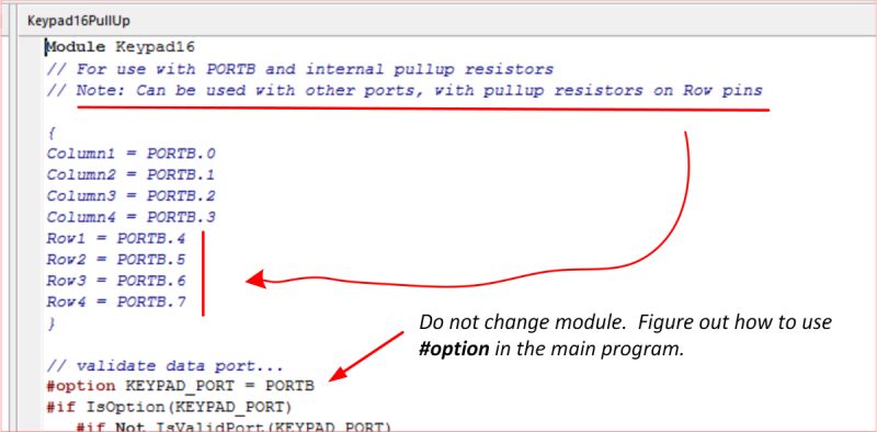

received new keypad from Elecrow and re configured the keypad port to portc
need to change the pullup.bas as it is configured for portb
installed pullup resistors on first 4 bits of portc

What chip you using again?
Why are you changing the pull up code? Have you checked that port C on the chip has internal pull ups?? if not then why change. The big question is...
Why use internal and external pull ups :confused:, say you use 10K internal and 10K external, your outside (yet again) the specs for the port current. Why are you running this so close to the edge without any reason i can see?
If your using 18F24k20
I am pretty sure its only port B that has pull ups......infact I am positive, if your using this port for the keypad you got things to watch for, like PORT C has the CCP module on which is part of the PWM module etc etc, so your going to have to make sure that the port is set correctly.
On most pics PORT B is designed for inputs like switches, hence its pull ups. So what have i missed? Why,where and when did you suddenly change the wiring?
