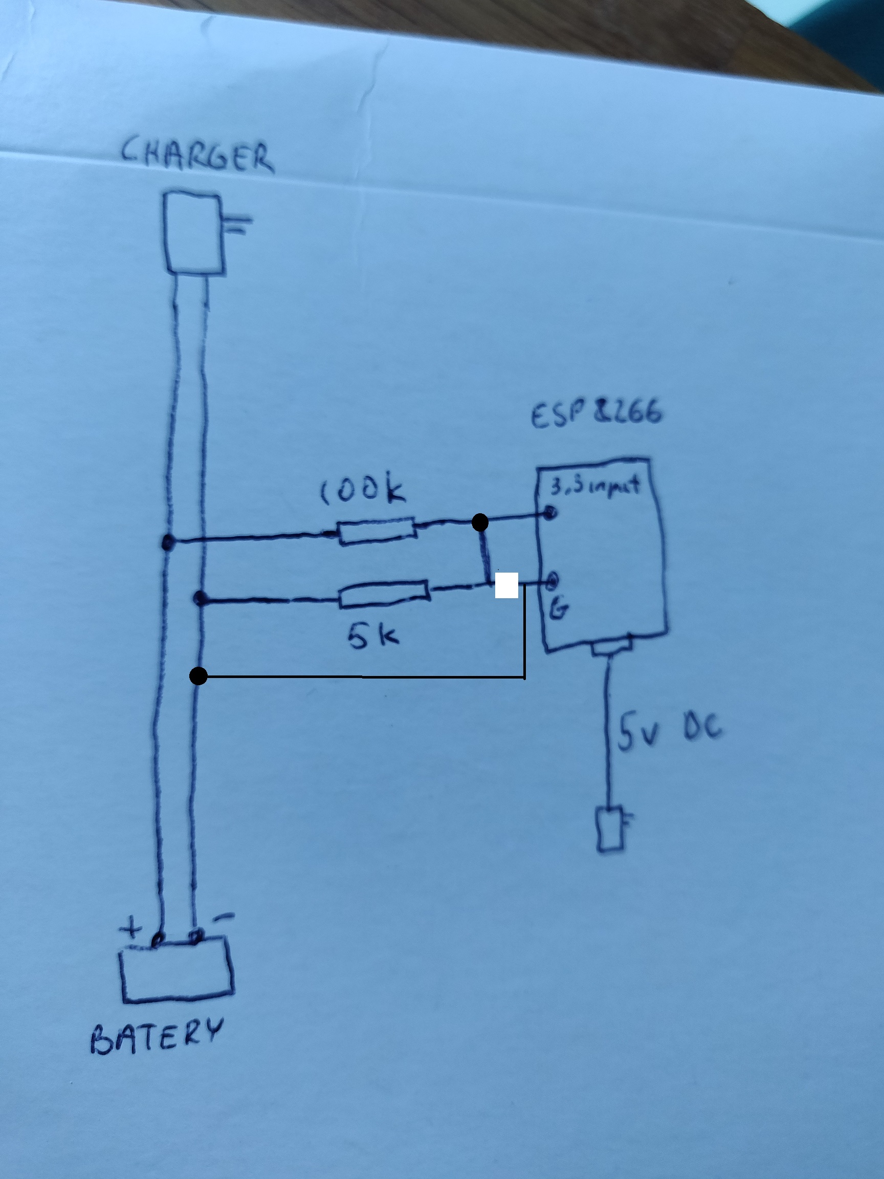

Hi Diver300, thank you for suggestion and detailed explanation.
I will try using 100k and 5k resistors. Just i have further question on how capacitor should be connected.

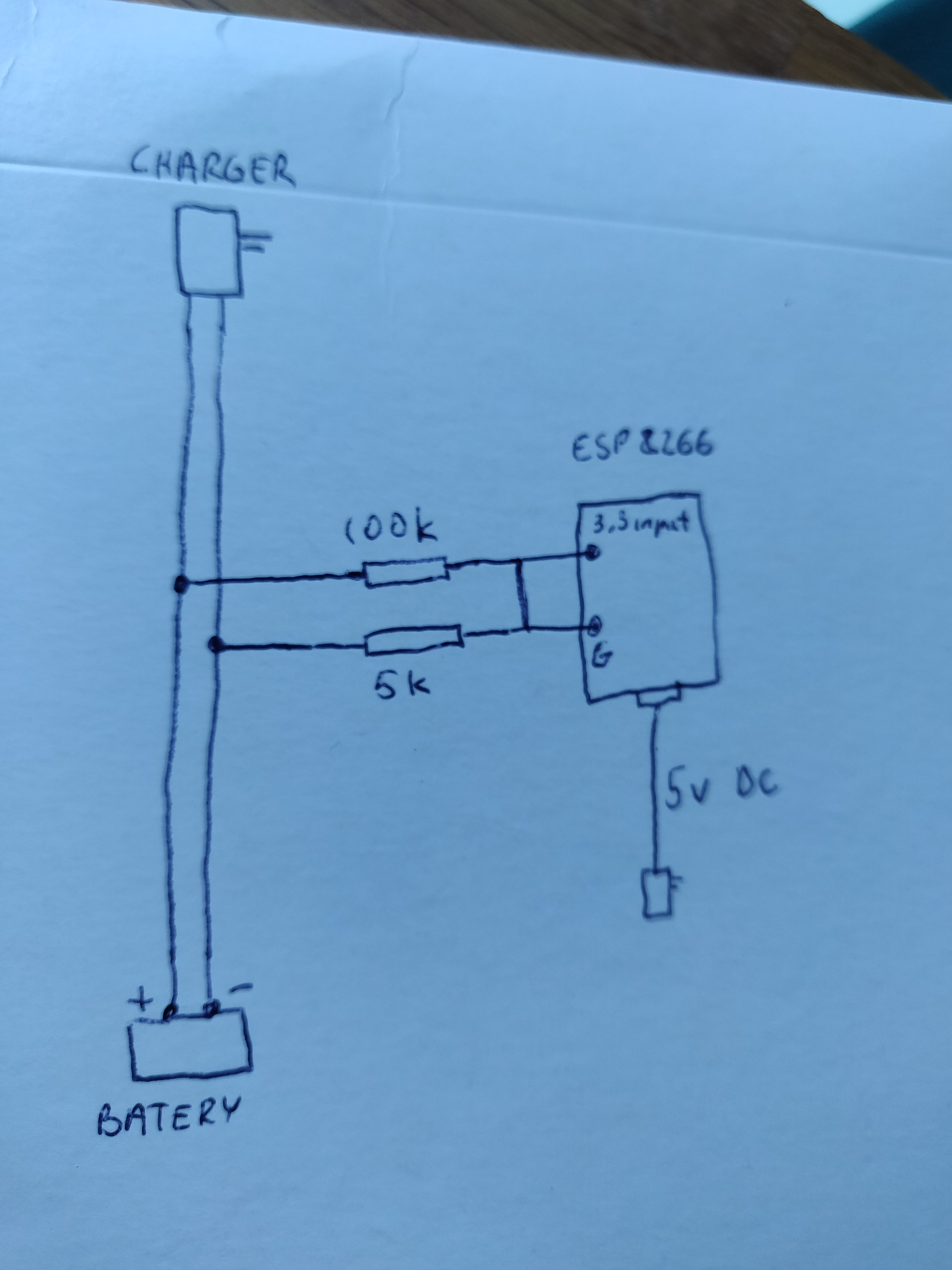

I did quick non technical drawing of my circuit. Can you please see if that is how it should be connected? I am not sure if tapped ground should be feed into ground pin of my esp8266. And if you could give some more details on exact capacitor location would be great.
This is how the sensor should be connected.
You should be able to measure around 2.6 V across the input to the ESP8266 when the battery voltage is 55 V.
The capacitor should be connected across the input to the ESP8266, which is also in parallel with the 5 kOhm resistor.

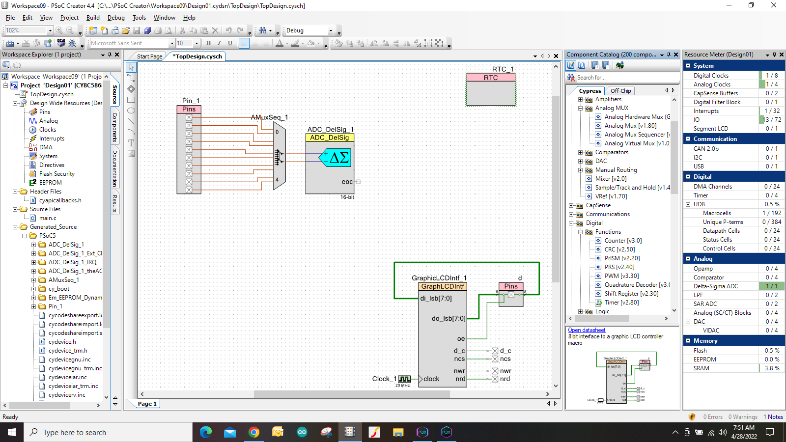

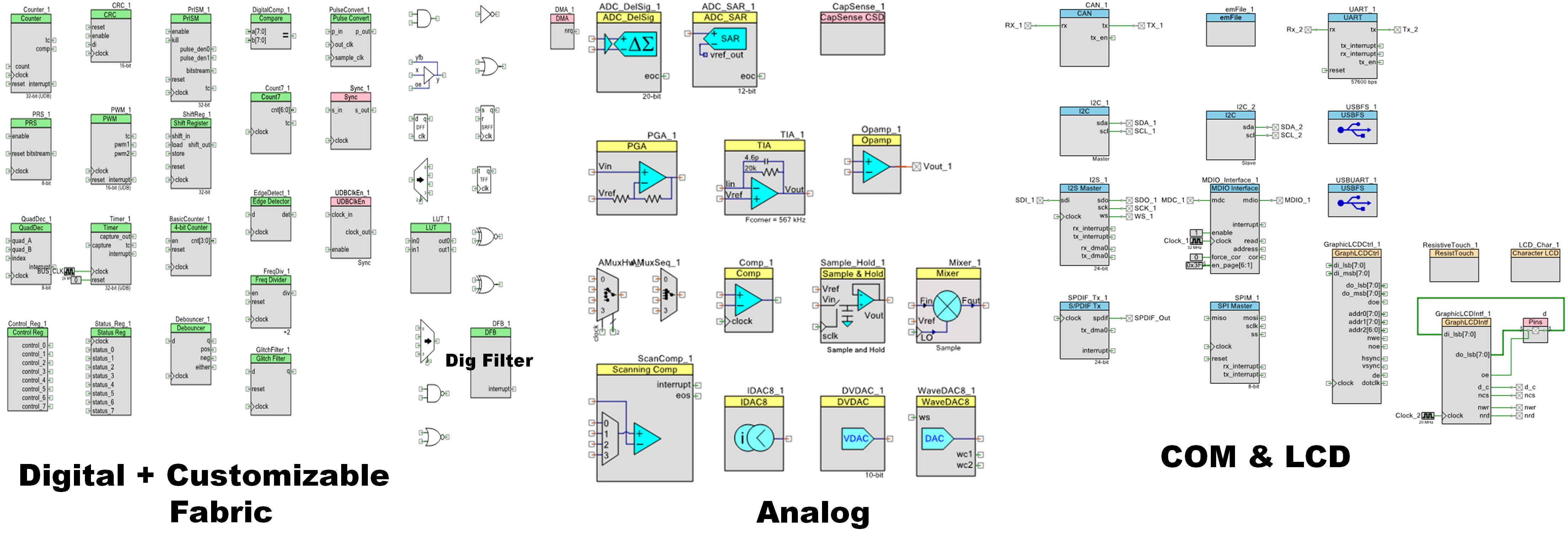

If you had issues with accuracy of A/D or wanted to add capability like
energy consumption over time or seat temperature :))) or whatever.
There are chips out there, like this one, that has a +/- .1% Vref onboard,
and its ADC can common mode outside its rails, allowing a shunt to be
placed in negative lead so you can monitor power/energy used, charged.
Single chip. Could also handle heart rate..... Note chip does not have WiFi, so still
need ESP8266. Does have SD Card capability as well.
Note this shows a fraction of overall chip resources used.
Onchip resources -
Regards, Dana.
