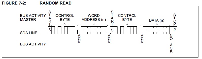

Well, as you can imagine this is going wrong. I think the problem has to be something to do with the I2CRead instruction.

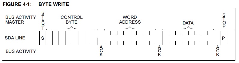

Reading the datasheet i found some rules.
- The controlbyte has the format 1010ABCx. A, B and C are selectionbits for the level (block) of the memory (8 blocks of 256 byte available). x is used for write or read action (will be controlled by the I2CWrite and I2CRead instructions).
- The I2C write sequense seems to be the same as used in the I2CWrite instruction (see image 1, byte write)
- The I2C read sequence is different and i think the problem can be found here. For random reading (this is what i want to use) the internal Eeprom addresscounter must be set first. This is done with a write instruction. Then - without a stop - a read instruction is folowing to get the data. (see image 2, random read)
So, it seems to me that i have to write a special routine for reading out the Eeprom by using the lower level I2C instructions.
I tried to do this, but do not know how to handle the acknowledge bit in case of reading out one byte per instruction.
In the sourcecode below, i've tried to use the normal I2CRead instruction, but that doesn't work. Also the readout of the Eeprom is attached as txt-file.
Hopefully someone has some experiance with this type of Eeprom...

4.1 WRITE OPERATION
Byte Write Following the Start condition from the master, the device code (4 bits), the block address (3 bits) and the R/W bit, which is a logic-low, is placed onto the bus by the master transmitter. This indicates to the addressed slave receiver that a byte with a word address will follow once it has generated an Acknowledge bit during the ninth clock cycle. Therefore, the next byte transmitted by the master is the word address and will be written into the address pointer of the 24XX16. After receiving another Acknowledge signal from the 24XX16, the master device will transmit the data word to be written into the addressed memory location. The 24XX16 acknowledges again and the master generates a Stop condition. This initiates the internal write cycle and, during this time, the 24XX16 will not generate Acknowledge signals (Figure4-1).

that gives me the problem with read out. For random readout i cannot use the standard routine, because the write/read format is not compatible with the standard instructions.
if i use I2CWrite1 directly followed with I2CRead, then i am creating a stopbit between the two instructions..
The snippets of code below should provide a framework to fill the entire EEP using single byte writes, and retrieve the entire contents using single byte reads. Haven't had a chance to check it out though (but I've used similar architecture to do "in-house" endurance tests of EEPs).
Generic code for sample write:
'WRITE TO EEP
For block = 0 To 14 Step 2
    block_addr = 0xa0 + block
    For addr = 0 To 254 Step 1
        I2CWrite sda, scl, block_addr, addr, addr
        WaitMs 5
    Next addr
Next block

How can I build the code with lower level instructions - without a stop in the middle - that the format seems like:
S-1010xxx0-Ack-addr-Ack-S1010xxx1-Ack-data-NoAck-P
I am thinking about (for the first block)......
I2CPrepare sda, scl
I2CStart
I2CSend 0xa0
I2CRecA ???
I2CSend addr
I2CRecA ???
I2CSend 0xa1
I2CRecA ???
I2CRecN data
I2CStop
I do not know how the instructions I2CRecA and I2CRecN are working.
For I2CRecA tmp
Does this mean that the program is waiting for an acknowledge AFTER sending tmp?
For I2CRecN tmp
Does this mean that the program doesn't have to wait for an acknowledge BEFORE reading tmp?
Oh, and thank you for your help for sofar :)

Ok, but if i want to use page write and page read then i have to understand the loverlevel instructions.
Can you tell me how the instructions I2CRecA and I2CRecN are working? There's no clear explanation in the Oshonsoft reference manual..
The two functions are I2C read ack and I2C read nack When you ask an I2C device to do anything it replies with ACK or NACK to signal that your request has been delt with..
Similarly when you are reading you must respond with NACK to continue or ACK to finish correspondence...
I still think the stock functions should work .
