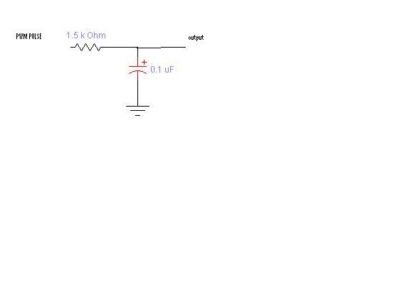

OK, after doing some reading and learning up the basic calculation on RC filters (thx to Nigel's recommendation), i finally used the RC filter to filter PWM pulses. :oops:
However, i have several problems
Firstly, the ripples are too large or if i increase my capacitor or resistor value, my PWM pulses voltage seem to have dropped from 5V to 1V after being filtered.
If there anyway i can maintain my voltage level with slight ripples?
Thx.

You give almost no information?.
What frequency is your PWM?.
What mark/space ratio are you using?.
What frequency is your filter designed for?.
What are the source and load impedances on the filter?.
What filter values are you using?.
What about posting the circuit?.
If you have excessive ripple, your filter is too high a frequency, if your filter is too low it should only affect it's response time, not the output. If you mark/space ratio is 20%, with a 5V rail you would expect to get 1V out.
Filtering PWM with an RC filter is an EXTREMELY! common technique, most TV sets use it in five or more places!.
sorry about that.
First of all, i designed my filter for 1000Hz frequency. My PWM is 4kHz.
I used the formula R = 1 / ( 2 x pi x f x c)
Initially i set the C=0.1 uF, therefore i get R= approximately 1.5Kohm.
The space ratio u meant was duty cycle? i used 30%. Strange though. My PR2 register for my PIC was set at 14(which would mean 16 steps), and my PWM was set to run at STEP 7(which is 50%).But it could out around 30%. But i'll continue with my testing.
Sorry but i dont understand the "source and load impedance" part.
Do u meant by Z= squareroot ( R.square x Xc.square)?
PLS tell me if i did anything wrongly. THX
I would suggest that's FAR too high, I've never got involved in designing a filter for a PWM output, but a simple RC filter isn't going to attenuate much at only four times it's roll-off frequency. Try calculating the reactance of the 0.1uF at 4KHz, and work out the attenuation of the resulting potential divider.
A quick glance at a TV service manual (Tatung 190 series) which uses PWM for volume, brightness etc. shows that it uses a 270K resistor, and a 1uF electrolytic capacitor, buffered by emitter followers. But I don't know what the PWM speed of it is.
What actually are you trying to do anyway?.
When u mentioned that it is TOO HIGH, what you meant is i should use a lower frequency filter?
I intend to monitor the current of my hbridge using a sense resistor. However, since the current is going to be in pulses, i want to smoothen it. 1 thing for sure is that i cant have high attenuation, as it may affect my current reading.
Yes a MUCH lower frequency!
Same thing, an RC filter!. Attenuation is irrelevant, you don't need to know a specific figure anyway - just if it's above a certain figure. This will produce a voltage based on the AVERAGE current - which may?, or may not?, be what you want. Or you could just measure the instantaneous current at the peaks?.

What do you expact to get out of the filter?
If you pass a PWM signal through a low pass filter, you will get DC.
The time constant of the filter must be long compared with the period of the pwm waveform, or to put it the other way around, the cut off frequency of the filter must be low compared with the frequency of the PWM.
Example
If you have a pulse wave with a peak value of 10 volts and a mark/space ratio of 10%, you will get 1volt out of your filter.
If you increase the mark/space ratio to 50%, you will get 5 volts out of your low pass filter.
This is what you are seeing already I think. Some "bumpy DC" out of your filter. That is what I would expect.

I've just had a quick play with my scope at work!.
Like most scopes, it's got a 1KHz p-p squarewave output on the front for calibrating probes.
I fed this through a 10K resistor to the probe, then connected different capacitors from the probe to ground.
A 4.7uF electrolytic produced only 5mV p-p ripple, and a 22uF only 2mV p-p ripple. Both of these were too small to see on the original scope setting, and required the gain turning up considerably (actually to 5mV/cm and 2mV/cm). With a 1uF, ripple was visible on the original 200mV/cm setting - actually measured at 20mV p-p.
In all cases (included 0.1uF, where the ripple was too bad to use) the DC output was 0.5V - half the 1V p-p of the original squarewave - as it had to be!.
