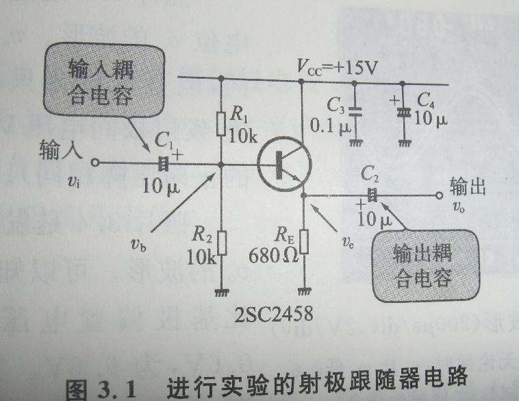

I guess I still need some time to fully understand your comments. The circuit I was refering to is one from a book I am reading, which is about the emitter-follower configuration. see attached picture. Since Emitter is not directly connected to 0V rail, the base bias is, according to the book, 7.2V, slightly below 7.5V. Why it's below 7.5V, according to the book, is because that the input impedance of the transistor is parallelly connected to R2, so it divides less voltage than R1. Actually i have another question here: why the input impedance of the transistor is paralelly connected to R2, not R1? what "the input impedance of the transistor" actually mean -- i mean it has 3 terminals, from which two terminals we "see" its impedance?
Also, in this case, it will be helpful if you can also explain why the signal voltage can be added to the base voltage. the confuse i have is that the base has a much higher voltage (7.2V) than the signal voltage (0.1v, e.g.), why the small voltage can still directly imposed on the big voltage?
well it looks like an emitter follower (common collector amp) only ive never seen the RE resitor shown on the circuit. Usually the resitor is placed between +Ve and Collector to control the amount of current that can flow.
I am asuming the output will be identical to the input minus 0.7V. The current gain is limited by RE (usually Rc???)
Be interested to hear other peoples comments.
An emitter follower has a resistor in the emitter, NOT in the collector, it's a perfectly normal and common circuit.
It provides no voltage gain, but high current gain, and a high input impedance.
The transistor has a small amount of base current that reduces the +7.5V from the two 10k resistors to about +7.2V. The input signal causes the +7.2V to increase and descrease by 0.1V peak-to-peak.
The emitter voltage averages +6.5VDC which increases and decreases 0.1V peak-to-peak.

Hi Nigel,
Little bit confussed with my thoughts on this. Is that Emitter resistor an actual physical resitor or is that the INTERNAL emitter resistor?
Also ive seen this circuit before used as a voltage regulator and there is always a resitor in the collector???
The emitter resistor in the emitter-follower circuit is an actual resistor. The internal emitter resistance of a transistor has a value that is much lower.
Hi Nigel,
An external resistor.
No, you don't have a resistor in the collector, the circuit is complete and correct, and is an absolutely standard common circuit.
thanks for the explanation, audioguru! now i am a little bit clear on the value of the bias voltage. so it seems, since the base current is flowing throught the transistor to the emitter, not the collector, then the author can say that the input impedance is parallelly connected to R2, not R1. it also explains another point of the author about the choice of R1 & R2: choose R1 & R2 to get a current (through them) which is bigggger enough (i.e., more than 10 times) than the base current. this is because, i guess, that the effect of the base current can be ignored w.r.t to the bias voltage imposed on the base terminal (i.e., the change from 7.5V to 7.2V can be ignored here, for the purpose of the circuit).
this is a digress:) and let's go back to the original AC coupling question. In this configuration, the author also present the scope pictures of the voltage at each point of the circuit, and from the pictures i can see exactly what you said: "The input signal causes the +7.2V to increase and descrease by 0.1V peak-to-peak.
The emitter voltage averages +6.5VDC which increases and decreases 0.1V peak-to-peak." actually the input signal in the book is not as that small, but is 5Vp-p, and the behavior is the same: the input signal causes base and emitter voltage change accordingly with the same amplitude. my question is how it can? I guess this is a too simple question, but it puzzles me when i want to understand the details. so let's discard the transistor in the circuit, we just keep R1, R2, +15V power supply, the ground, and the coupling capacitor C1 and the input AC signal Vi. In this simplified configuraiton, will Vi has the same effect on the voltage drop on R2 (and R1)? Can Vi be treated as another voltage source, and how is it connected to the DC power supply (parallel or in series)? Will the DC power supply affects the input signal instead of the opposite?... Sorry, I have a lot of doubts:)
Thanks again for your help,
/bruin
The input impedance of the circuit is the input impedance of the transistor in parallel with R1 and also in parallel with R2.
Correct.
The input signal is strong enough to drive the approx 3.5k ohms input impedance of this circuit without much signal voltage loss.
Yes, Vi is a valtage source, an AC signal voltage source to C1.
It is connected to the input of the circuit and to ground.
The DC power supply has nothing to do with the input signal source.
