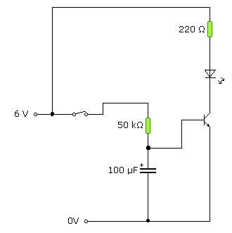

RC circuit thing
i remember doing an experiment with capacitors and resistors to make an RC circuit that would delay the turning on of an LED. ive forgotten how to make this circuit and i havent been able to recreate it by myself and after seraching google for RC circuits and similar seraches i have found nothing...little help?
edit: sorry i didnt mention that i got this RC thing but it takes time to turn on and off, i cant remember if there was an RC circuit which would onyl take time to turn on, not off.

no i specifically dont want to use a monostable,i would prefer to use the circuit i posted with the delay to turn off too, i probably should have mentioned that. thanks anyways tho!
Your circuit could be modified to turn off quickly if you turned the switch around the other way so that the common goes to the 50K.
Then connect the unused normally closed contact on the switch to 0V and connect a schottky diode across the 50K with its anode towards the cap.
Try this
I do a lot of them too. Use the 555 and if you want on delay just select your resistor and capacitor for the time, or use a potentiometer but dont connect pin 7 (discharge) to anything. The resistor will slowly fill the capacitor and when it gets to 2/3 the source voltage pin 3 will go low and stay low until you connect discharge. So make sure your LED positive side is connected to high because pin 3 after trigger value will go low. Is that what you needed ?

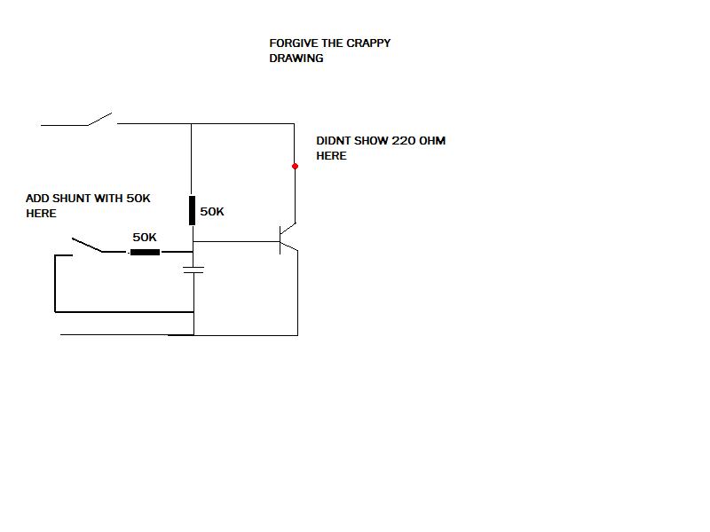

What I see in your diagram is Crocodile3D showing a 6V source charge via a 50K ohm resistor to the base of a transistor. That diagram will bring the LED to full bright via time, using the 555 it turns on and off and stays in that state. Hope that helped. Jim Now I see what you wanna do, how about a normally open switch I call it a "shunt" between the positive and negative of the capacitor. Use a 50K in series with the switch to turn off at the same rate it charged up. I went back and edited that..... Im just a novice myself but I learn a little more every day. Jim
