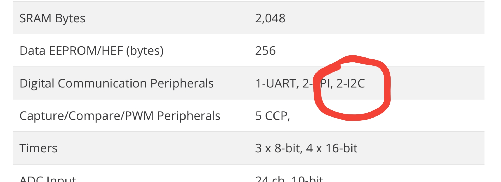

The chip uses an I2C interface. It's not connected to a UART interface. Fortunately, the 16F18856 supports 2 I2C interfaces, which use SDA (data) and SCL (clock) lines.
