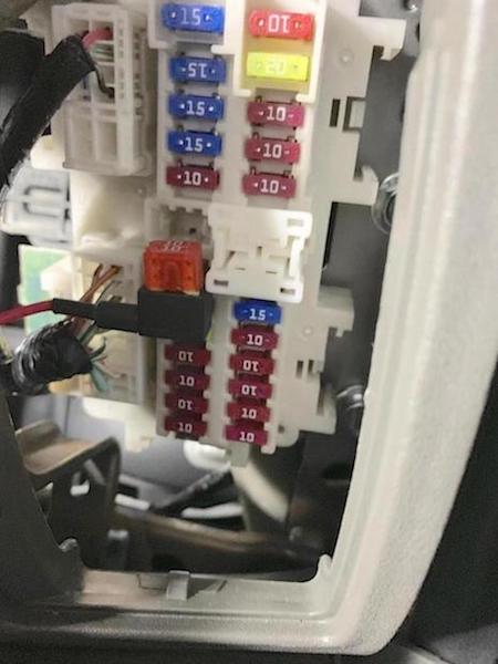

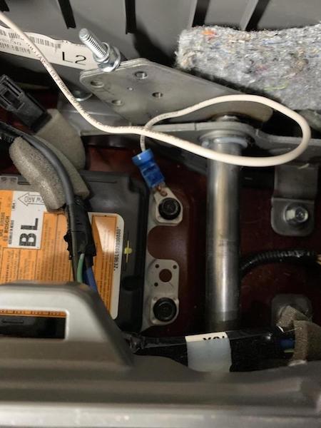

I installed a wireless phone charger under my console on my truck but when I place the phone on the charger I get radio station interference. The wires are connected to the fuse panel using an add a fuse and the wires are behind the dash and up under the console but my radio sits high above and away from all this wiring I did. I used a 12V adaptor a 3.0 fast charge car charger and 3.0 fast charge charging pad to make the connections and hot glued the board from the fast charger under the plastic console piece. It charges fine but I can't figure out how to lose the static/interference on the radio.
I added these photos for reference for power connection and ground.

Sounds like your charger is a switching regulator, which are very RF noisy. There may or may not be a solution, other than changing the charger. Other option is to run the power leads through a RF choke of some sort, like a "Snap Choke". Alternatively, wrap the wires thru a ferrite choke, like those found on the ends of monitor cables or similar.
I suspect the charger is producing enough RF that it is getting into the power panel.
However, if the RF interference is simply radiating from the charger itself, you would have to replace the charger with one that is RF quiet...
The RF seems to come about under load, when the charger is actually running with enough power to produce the RF via power spikes. This type of RF noise would be worse on the AM band, and less noticeable on the FM band.

I would suspect the USB adapter (third item). The wireless charger is still a possible culprit as well. The first two items above are just wiring to tap into a fuse block and provide a lighter output. No real electronics in those. If you want to try a RF choke, put it right behind the cigarette lighter socket.
If possible see if you can find a different 12V/USB adapter. If the noise persists, then it is likely your wireless charger.
I have a couple of adaptors I can try. Don't think they're fast charge but it will possibly narrow it down.
