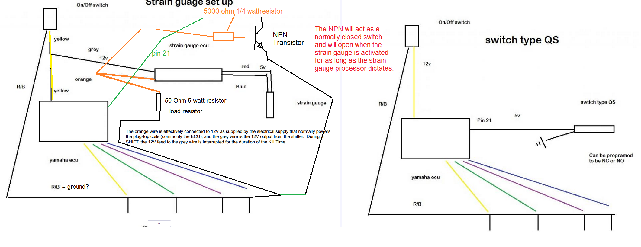

I have a strain gauge type quick shift on my bike
But I want to program the kill times with my onboard ecu at the click of a button...
To do this I need to tap the strain gauge(12v) to the ecu wire (5v) ...... EG when the 12v wire is cut I need the 5v wire to cut instantaneously
Can you guys hold my hand and point me in the right direction for a solid state relay that would make this work ?
By "when the 12v wire is cut" do you mean the 12V circuit is opened?
I think what you want could be done by one or two transistors but a circuit drawing of what you are trying to do would be a big help in avoiding the design of an incorrect solution.
I'm confused by the 5V and 12V going to ground. Does that mean their voltages are 5V and 12V respectively when they are open?
Do you mean when the 12V line to ground is opened then the 5V to ground should also go open?
If so do you know the current level through the 5V line?

I'm confused by the 5V and 12V going to ground. Does that mean their voltages are 5V and 12V respectively when they are open? YES
Do you mean when the 12V line to ground is opened then the 5V to ground should also go open? YES
If so do you know the current level through the 5V line? .497m the multi meter setting was on "2m" dc
In response to your first quest my strain gauge is not programmable because it is the cheap version......
However my Yamaha ecu is programmable for free because I have all the gear already, so I am just trying to get the strain gauge to work for my Yamaha ecu

Do you have a wiring diagram of the stock hookup or the way its hooked up now?
Your diagram of what you want is a bit confusing.
You show two wires going to ground labeled 5 volts and 12 volts but anything that is attached to ground will be at 0 volts.
Do you mean when those wires are disconnected from ground you get those voltages?
I dont see what the strain gauge relay box is switching.
The way you have it drawn it would short out your battery.
in a effort to simplifie things I believe I have made things more confusing
Ill draw everything the way it is.... and we can start again

Here's something to get you started, I looked at the HM super lite and your drawing, when the HM activates, it removes power from the orange wire which will turn off the transistor as if the switch type had opened. I assume that once the ECU gets a signal, it take control of every thing regardless of how long the switch is open.
I'm hoping someone else will make a suggestion as to which NPN to use and maybe modify the trigger from the strain gauge.

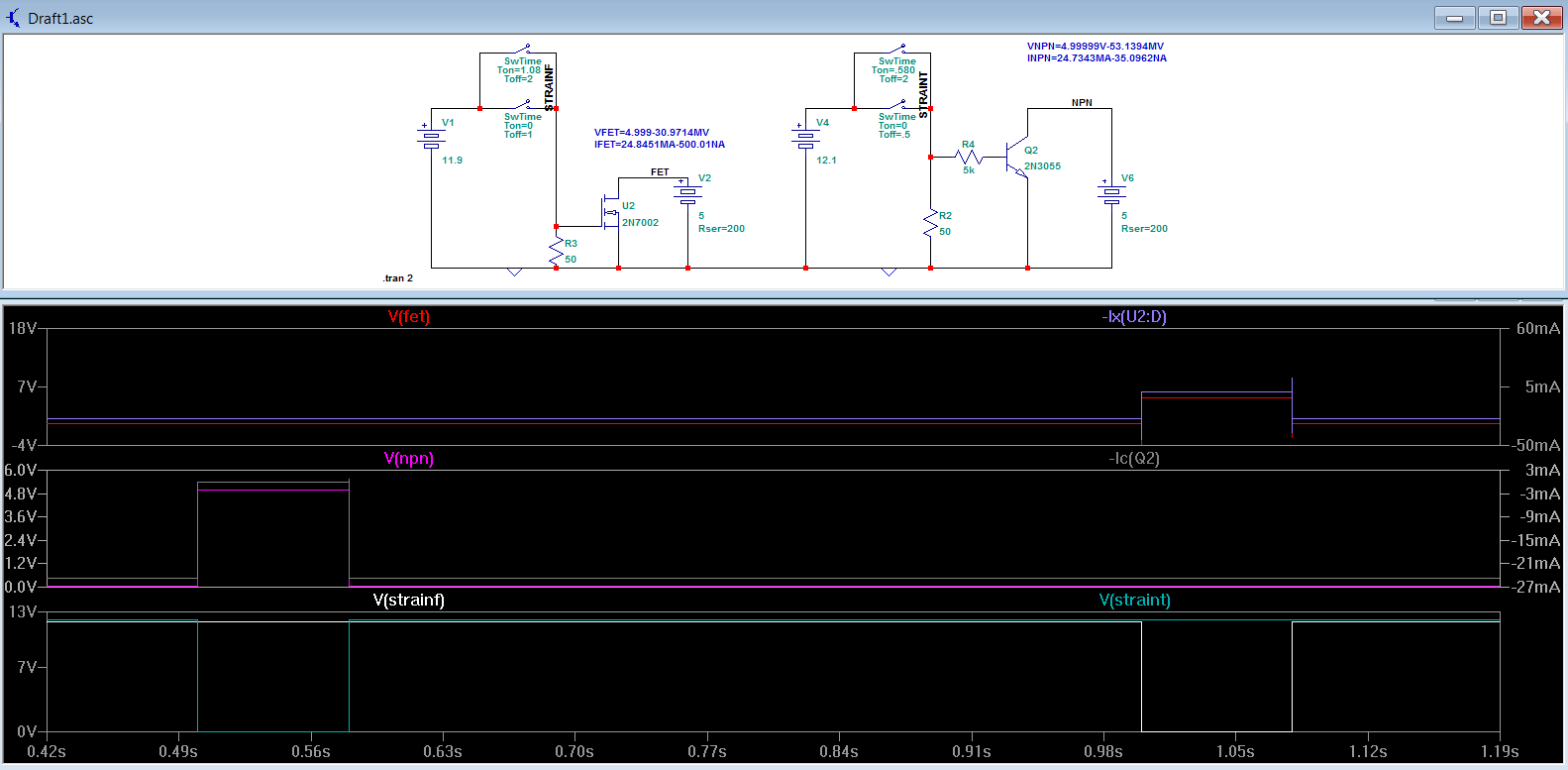

I ran a few schematics through spice and here's the numbers and wave forms of what I came up with. Current from pin 21 was limited to 25ma internally. If you can measure the current from Pin 21 to ground, it may be helpful in choosing the correct FET or transistor.
