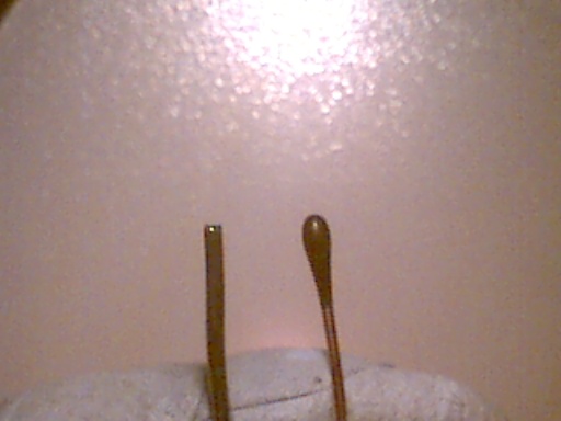

Hi - I have used a very small resistance sensor for controlling a forced airflow to within 0.5C. It was smaller than a pinhead with a nominal resistance of 50k ohms. With a suitable series resistor, the voltage generated by the current through the sensor was fed directly into an A/D input of an Atmel processor. (a Mega16 in my case).
From the A/D value the sensor resistance can be calculated and from the resistance the temperature can be calculated. (floating point math required).
Where are you based - I could drop a sensor in the post to you.
Ron

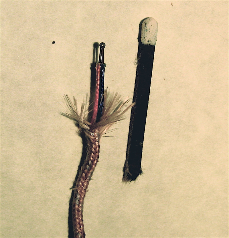

Are those 30Ga (0.010" dia.) (.3 Second response time) TC assemblies much different than this?
tc-jpg.26646
Thats the smallest TC I have ever had and its not fast enough. I just think I need something more like a ultra thin coiled wire or something.
With those "Surface Thermocouples", can I remove all that paper or tape or whatever it is from those stick on sensors so that it can just sit in the center of the air flow without restricting it. They're surface sensors originally... which makes me think that they will have to be modded to better meter air temp.
That's actually pretty big. The smaller the wire, the faster they respond. Though the sense point is at the bead, the thermal mass of the leads add to the response time. Stripping the patch off of the surface mount type should actually improve the response time. If you want professional input, free, Omega has engineers that can help you figure out exactly what you need. And I'm sure there are other companies, but I use their online references a lot. :)

One problem with very small sensors that can be overlooked is the thermal effect of the connecting wires - heat can be conducted away from the sensor through these wires giving innaccurate readings. Make sure a good part of the connecting wires are in the airstream as well as the sensor.
Re the sensor I mentioned before - (see pic) - the sensor is shown next to length of standard 0.7mm cored solder. (The blob on the right hand side is the sensor).
