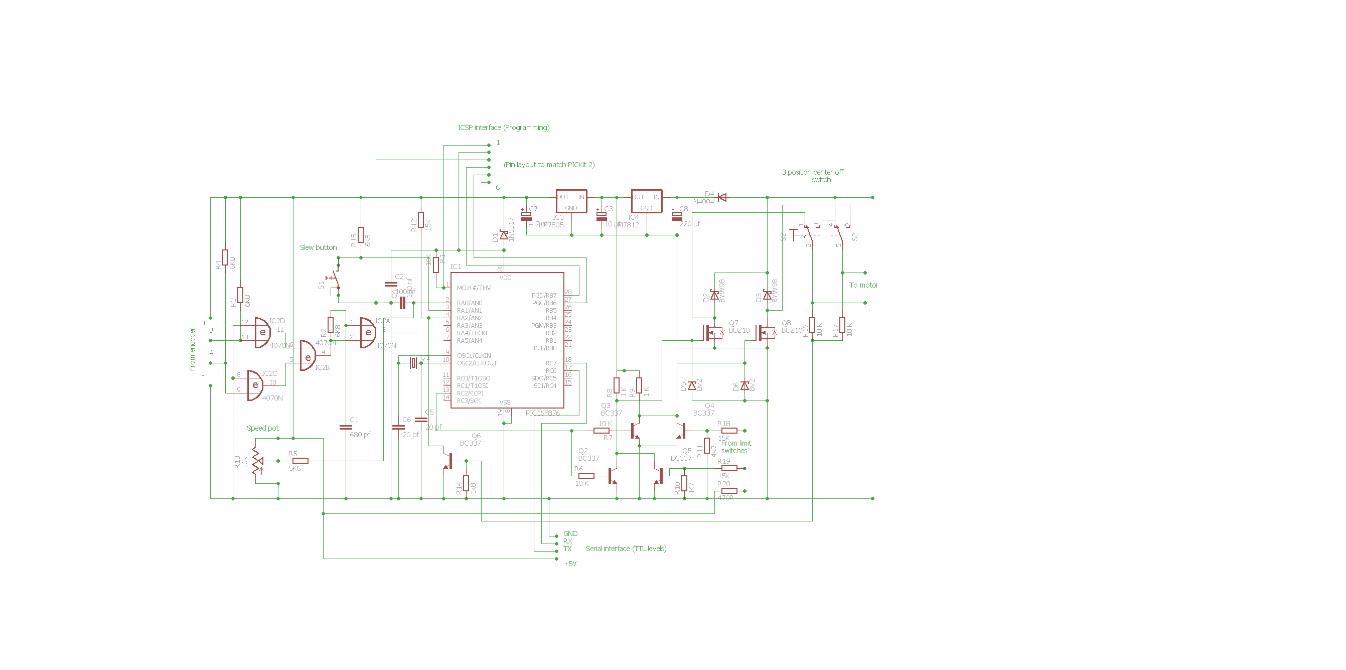

If you do not need direction information you could XOR the A & B signals from the endoder then feed the output of the first XOR gate to a second XOR gate. The output of the first gate goes directly to one input of the second gate and also to the second input of the second gate via resistor. There is also a small capacitor to ground from the second input to produce a small delay. The result is a short pulse on every transition of either A or B encoder input.
This is the method I use on the table feed on my milling machine. (The serial port connections are used to set the PID gain values.)
Les.
If you have the encoder and it has an index pulse, And you only need RPM, not position or direction, then the marker could be used in simple tachometer mode with a CCP capture module etc.

Yes I think this is the way I will go with. I need just want the RPM value for now.
