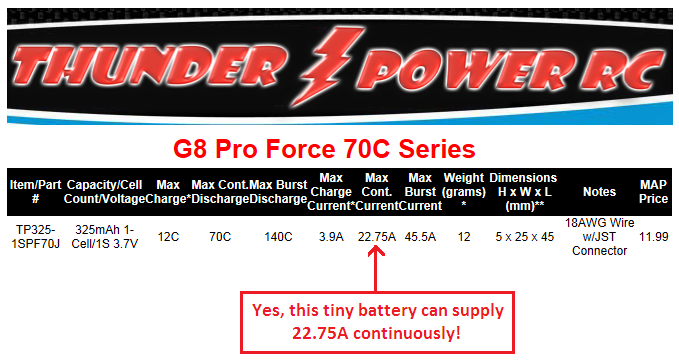

Lithium batteries are used in cell phones and in laptops.
They are also used in hybrid cars.
My RC model airplanes are powered by a modern Lithium battery.
Here is the spec sheet of a tiny Lithium battery and they have thousands of more powerful batteries:

Wouldn't it be kind of expensive to buy that many Li-ion cells for her project though? Maybe you know where to get them cheaper.
But perhaps we can work on reducing the heat losses. That would mean less power required so smaller batteries would be OK i think.
My radio controlled model airplanes use Li-Po batteries. I buy Name-brand American batteries that are fairly expensive but they are powerful and last a long time. Some of my friends buy very cheap batteries from China and they do not last.
