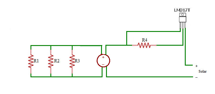

Here is everything I am going to use and do, so you can assure me if I am going on the right way.
Okay so the circuit now will consist of:
1- Sealed Lead Acid battery that has 12V and 4.5 Ah. Like this one in Amazon:
https://www.amazon.com/UltraTech-UT...sr=1-18&keywords=Rechargable+Gel+Cell+Battery
2- Three resistances in parallel, each one of them is 15 ohms and able to handle 20 watts.
I will insulate the bottom of the three resistances and attach the top into the metal surface. Is that correct?
If it's correct, then there is another thing I would like to ask you about if you may. I was thinking of recharging my battery by solar energy! So whenever I walk around with my mug in a sunny day, it can charge the battery a bit. To charge it fully I can leave it outside for a long time till it charges for example. I made a diagram combining the circuit I consulted you about (the heating circuit) with another circuit that charges battery by solar energy. My idea is to cover my mug with a flexible solar panel, like these: https://www.siliconsolar.com/product/flexible-solar-panels.html and attach it to the battery I am using for the heating circuit.
The diagram of the whole thing is attached to my post, please tell me what you think.
The components of the charging circuit are:
First, a high voltage solar panel, higher that the battery I am using but I don't know how much exactly yet, maybe about 20V. Second, a resistance. Third, a voltage regulator chip LM317T, so it regulate the voltage produced by the solar panel and doesn't allow the battery to heat up.
Waiting for your opinion :)

Hello again Sara,
Everything sounds good so far but im afraid the solar recharge part is going to cost you a small fortune. That's because you'll need a decent solar panel that can put out at least 400ma at the required voltage of around 14.2 volts or higher. Since the max power point of a solar array is not at it's open circuit voltage, you probably need a 20v panel or better (as you noted) that can put out 600ma short circuit current. That puts the wattage of the panel at 12 watts.
If you try to use less than 400ma it may charge a little, or it may not charge much at all. Also working against us here is the angle of the sun relative to your panel front surface. The power that gets to the panel varies as the cosine of the angle, so at 12 noonish you get full power and any other time you get less unless you have the panel track the movement of the sun.
Anyway, taking that into consideration and assuming we get 8 hours of decent sunlight, we'll probably see an average of 300ma over the 8 hour period if we are lucky, and also that the battery charges at least some with lower current than 400ma, and also the charge acceptance of lead acid, it will take 3 or 4 days of bright sunlight to charge the battery even with a panel that good (20v, 600ma assuming the max power point is close to 14v at 400ma).
So this starts to sound a little expensive unless you can get cheaper panels on sale or something. And it may end up being a little bigger than you want to have to carry around with you :)

Hello again MrAl,
um yah I see now :/
Maybe I can afford the cost, but the size is a huge problem for me. So yah I think the idea is not worth it. Thanks for all the info..
I like the the hand crank generator idea very much! It it is an environmental friendly way of charging too and it is easier to afford.
May you please tell me more about it and how it can fit in my circuit?
