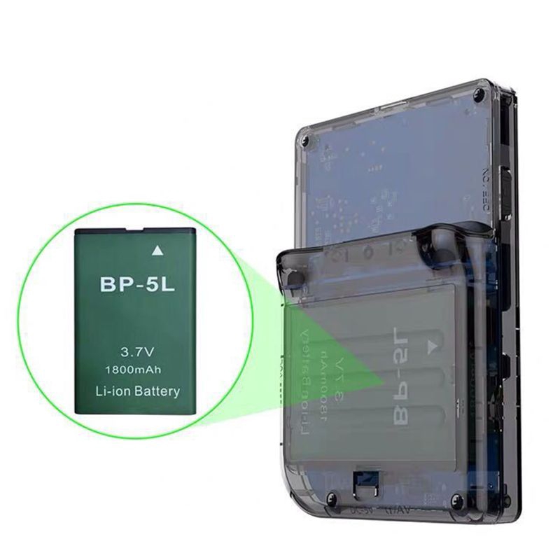

I am in doubt if these two BM20 and BP-5L batteries are lithium or lithium polymer batteries or lithium ions
the BP-5L batteries are 1800mah and the BM20 battery is 2000 I charged them using this photo charger for 75% after how many days do I need to recharge them again so they have long storage and durability?

A Li-PO battery is a Lithium-Ion battery in a polymer case. Storing them fully charged at 4.2V per cell reduces their lifetime and capacity. Store them at 3.7V to 3.8V per cell. I have some Name-Brand Lithium-Ion batteries stored at 3.75V per cell for 20 years and they still hold the 3.75V today.
Your batteries are no-name-brand so they might not hold a charge for long.
You charged the battery at 75% of what?? 75% of 4.2V is only 3.15V which is too low.

If you are going to store them for a long period, they should be charged to around 50% capacity.
Then put them in an airtight "zip" bag and store them in the refrigerator (not freezer).
That is the general advice from the battery pack makers, for such as camera/video batteries etc. that are unused for long periods.
It equally applies to any general rechargeable lithium cells, laptop batteries etc.
The cell capacity loss should be no more than around 1% per year at 4'C
They do not need any attention until you are ready to use them.
(Let them reach room temperature before unsealing the bag when you plan to use them, to avoid condensation).

I charged the battery at 75% using the charger in the image I posted at the beginning topic of the third link
How much time after this charge do I need to charge again in order not to decrease battery life? BM20 2000mah and BP-5L 1800mah batteries
Li-Ion are very good as regards charging, as long as it's done properly there shouldn't be any issues - don't over charge them (a proper charger shouldn't let you), and don't discharge them too far, as this damages them.

75% is meaningless, as it's purely dependent on that specific charger - not the state of the batteries. As I've already said, there shouldn't be any issues if they are charged properly.
In post #2 I said, "You charged the battery at 75% of what?? 75% of 4.2V is only 3.15V which is too low."
A lithium battery fails soon if it is stored at a full charge. Also, it should have a circuit to disconnect its load when the load discharges the battery cell to below 3.0V.
A good Lithium battery cell holds a charge for many years, a cheap one maybe a few months.

charger dc 4.2v dc 400 ma max
You cannot say 90% unless you say what it is measuring. Voltage? Current? Is it mAh?
If a Lithium-Ion battery cell is discharged below about 3.0V then its power and capacity are damaged. If it is discharged below about 2.8V then it is a hazard to charge because it might explode and/or catch on fire.
