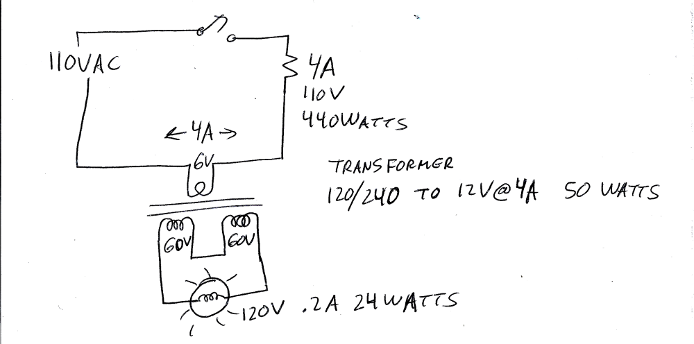

Here is a "current transformer" circuit.
Picture shows 110V---switch---4A block heater.
Break open the wire and insert a transformer. (in this case backwards)
Use any 110 or 220 V to low voltage transformer that is rated at 4A or more on the secondary.
In this example I wired the transformer for 220 to 12V. (will also take 110 to 6V).
The transformer will have 6 volts across the secondary causing 120 volts across the double primary.
Putting a 120V 0.2A 20 watt incandescent bulb on the secondary.
Another way to think about it:
120V 0.2A bulb on the primary looks like a 6V 4A bulb on the secondary.

Note that the current transformer design in post #7 can generate a very high voltage across the 120V winding if left open circuited, so be sure to always have the light bulb load (or a short) on the winding when the heater is connected.

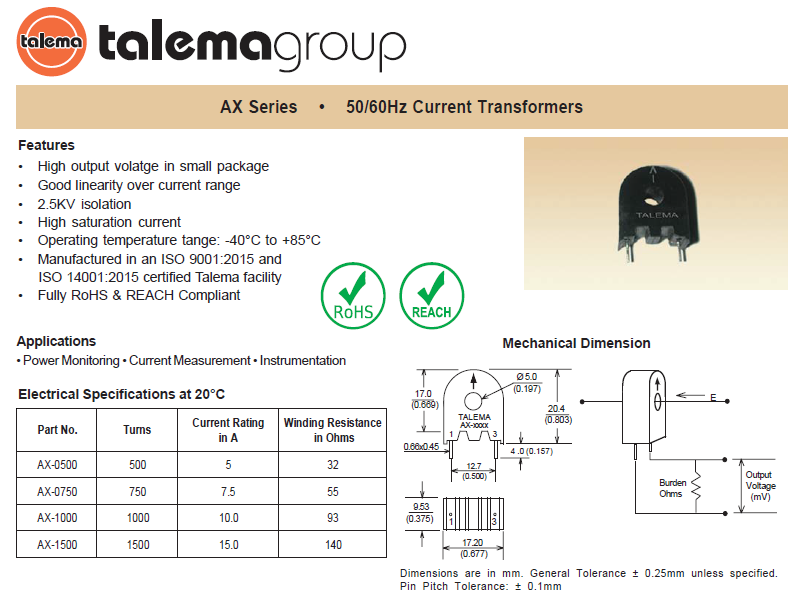

Making a "current transformer" from scratch is hard and unpredictable.
Here is a data sheet of a real CT.
Many CTs can only output a fraction of a volt. Not enough to light a LED. In this case don't use a small CT like from CoilCraft.com
This part (AX-0500) can output near 3 volts.
Many CTs have a turn ratio of 1000:1. So your 4A will output 4mA which is maybe too small for a LED.
The AX-0500 will output 8mA.
You run one wire (not both) through the CT.
Normally you would put a resistor on the output of the CT like in the picture.
Because you don't care to "measure" the current but to just turn on a LED then forget the resistor and put two red LEDs across the output.
Do not use white LEDs because they need 3 volts.
You must use two matching LEDs. (same type and color)
The load of 4 amps into the CT will output 8mA into the LEDs.
https://www.digikey.com/product-detail/en/talema-group-llc/AX-0500/1295-1132-ND/4172197
DigiKey has 3000. I have made this circuit.

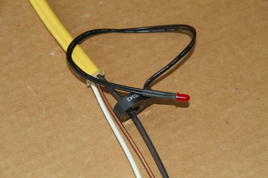

I would just buy one of these. You can build and try different approaches but I have seen these in the US (maybe on Amazon) for about 10 to 12 USD. I used them with heating elements to detect burned out elements. Simple, easy and non intrusive. The RED LED turns on at 0.75 Amp so it should do fine for you.

The LED you linked to, the 50/50 is a RGB (Red, Green, Blue) tri color LED. Any reason you plan a tri color? Doing it the way you propose will require a separate power for the LED. Here is an example of what I suggested in post #14. The AC hot is simply passed through the loop. The LED (which comes in a choice of colors) is line powered. They include "snap-in" hardware so mounting requires a single hole. The LED lead wires can be extended.
Pictured with AWG 12-2 ROMEX cable. Figure for under $15 USD it's done. I use them to detect open heating elements in large systems. I can easily see the LED at 50 feet even in bright lighting. Obviously simply detecting voltage to your heating element won't work for the reasons you cited.
