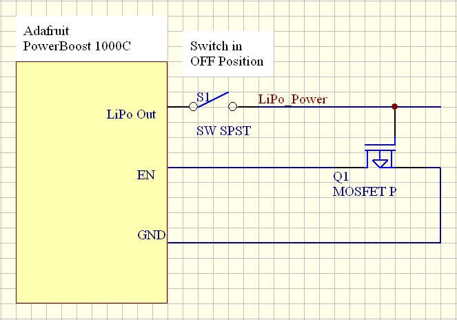

Based on a recent conversation about FETs, I was thinking something along the lines of:
The design goal is to have zero current draw when the switch is OFF and to have minimal (almost none) to enable the boost circuit when the switch is ON. I was trying to disconnect EN from GND when the gate is connected to a positive voltage. I know from the recent discussion on N-FETs, that a N channel FET is not going to work when wired like above.

Can I install the PMos with the source connected to EN and the drain connected to GND?
When the switch is open, the gate would be at ground and the source at battery and therefore the FET is on. When the switch is closed, the gate will be at battery or higher and thereby turn the FET off.
Can the FET be installed this way? Something doesn't seem quite right to me, but I havne't used individual FETs much (I can't recall ever, actually).
Yes, but then the gate must be -5V to -10V to cause the EN to be grounded.
When the switch is open, the gate (of the P-channel Mosfet) would be at ground and the source at battery and therefore the FET is on.
No, gate is floating and the drain-source diode will be backwards and will conduct.
No, the drain-source diode will be backwards and will conduct.
Besides, the Li-Po voltage is too low for many Mosfets. An ordinary Mosfet barely turns on when its G-S voltage is 4V and will not conduct enough. A Logic-level Mosfet barely turns on when its G-S voltage is 2V, but then it will not conduct enough when the battery is near 3V. There are some tiny very sensitive Mosfets in products but I have never seen them for sale.
This was predicated on the suggestion to add a resistor from gate to ground. Though that solves the floating issue, all the other problems with the idea still make it not work.

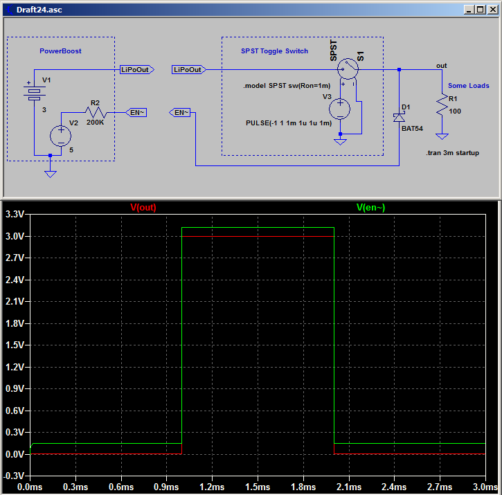

Isn't it just this simple?
The simulated SPST closes at 1ms and opens at 2ms
The Bss123 is a tiny NFet with a Vth of 1.6V, which sinks more than enough to pull EN~ low when its gate is at 3V.
As usual, Audio is making a mountain out of a Molehill.
ps: while the circuit I posted does what you asked for back in post #1, I read some of the on-line discussion about the "powerBoost", and I don't think you understand how it works.
read this
That's hard to tell. I'm usually the main culprit in do that.
I'm not sure that circuit does.

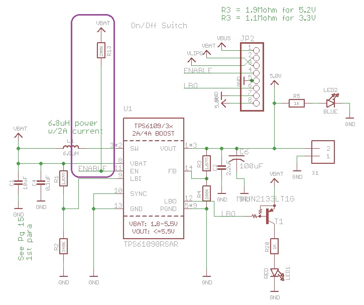

The module has six pins: (original long version here Module Pinout and Functions)
Summary version:
USB - this is the micro USB 5V power pin. Power from the microUSB port when it is plugged in
BAT - this is the battery input, connected directly to the JST connector. For most Lithium batteries, this will range from 3.0V when near-dead to 4.2V when fully-charged.
VS - this is a switched output, either USB when connected or battery power when not connected to USB.
GND - this is the power ground. This boost converter is not 'isolated' - the ground input is the same as the ground output
5V - this is the boosted output. \
EN - this is the 'enable' pin. By default it is pulled 'high' to VS (according tot he schematic it is pulled to battery?). To turn off the booster, connect this pin to ground.
LBO - Low Battery Output. By default it is pulled high to BAT but when the charger detects a low voltage (under 3.2V) the pin will drop down to 0V.
To minimize losses due to regulation, part of the unit runs from VS (Vshared) and the sensor runs from the boosted 5V. To turn the circuit off, but still be able to charge the battery, there needs to be a disconnect between VS and the load. The same does not (completely) apply to 5V. I can turn off the sensor by disconnecting 5V from the sensor, but the booster still runs and draws current. To stop the boost circuit, EN is connected to GND. In short that is how the module works.

Then it is even simpler...
I guess not. I tried and it didn't work (although I used a 1N914 because I don't have any schotkeys on hand). I don't think your simplified PowerBoost is correct. What pulls down EN when the switch is off? Where is the pull up resistor in the PowerBoost? I think EN should be connect between V2 and R2.
The load(s) have to be there to act as a pull-down. You said you thought there was a pull-up on EN inside the power-boost. It is easy to tell using a voltmeter. Since EN is a logic input, then the Si diode should work.
In trusting and believing you. I tried again. The local electronics store stocks a limited number of NTE parts. I found a NTE180 listed as a schottky diode. I tried again. There was vague success, as the powerboost indicator LED did not turn completely of. I don't think the pull down was hard enough (or too much loss in the diode).
There is a pullup resistor from EN to the shared voltage out. So EN is a few mV lower than the shared voltage out. Realizing (not quite understanding) where you were headed with diode. I have to ask, why the diode? Why not just a direct connection?
