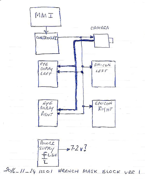

A functional block diagram for the Wrench mask is posted below.

looks awesome :) what bothers me the most with this mask is how can i change emoticons (facial expressions) stealthy i can always hook it to something like a phone or something else but it kinda ruins the fun because its noticable

This is a very important point. The safety of eyes can never be compromised under any circumstances. This applies to mobile phone displays, individual display screens, and the screens of video glasses. The two eye screens on the block diagram, of post #29, can represent the screens of standard, off-the-shelf, video glasses. By the way, at the moment, I think that off-the-shelf video glasses are the way to go.
This aspect of the mask is nothing to worry about. The box maked MMI (Man Machine Interface) represents all the manual controls for the mask: emicon selection, emicon brightness, emicon on off, eye display brightness ... and so on. The actual controls will be up to you- literally any form of manual control can be provided.
My initial thought on the MMI is a small push button pad that fits in the palm of your hand with a single wire routed up your arm to the mask. From the palm pad you will be able to control all mask functions. These are just my initial thoughts about the MMI though.
i thought about that too but my thought was around bluetooth so there wont be wires where they are not needed hehe but the wire can be done too i can make it into a stickable tattoo and hide the wire under it
I suggest going for a wire- it can be thin and flesh colored- to start with to keep things simple. A wireless link can always be added later, if absolutely necessary.
