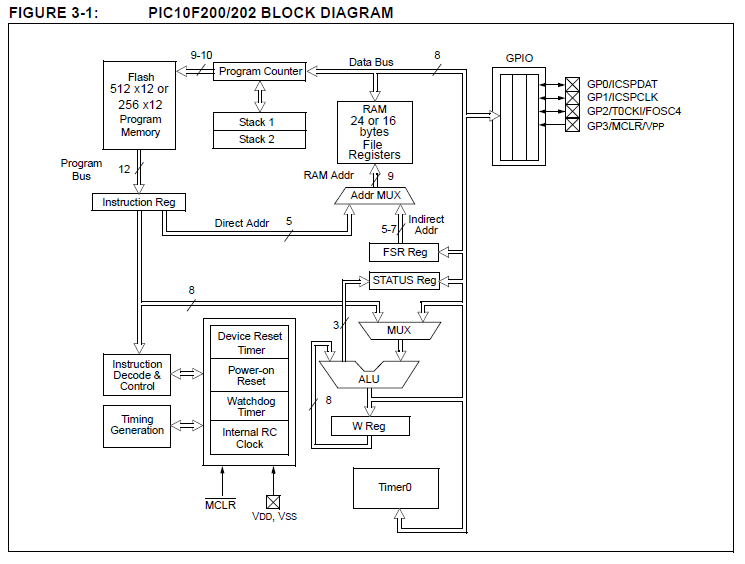

what is data path and instruction path in micro controller
Lets imagine an istruction that sais add A to B and store it in A.
Data path are the wires that connect A and B to the ALU. Instruction path are the wires that connect the instruction (stored in some place) to the control unit.
Try reading this, it seems to explain a bit more https://minnie.tuhs.org/CompArch/Tutes/week03.html
Using simple terms of instruction space and data space, ispace and dspace for short. dspace changes; this is basically RAM; Instruction space doesn't It's typically accessed by the program counter and has fixed values (e.g ROM, EPROM, EEPROM but can be RAM). The categories are not engraved in stone.
In larger computers, there could be many Ispaces and dspaces. The OS operates in one and each program operates in another. ispace and dspace could be RAM in a larger computer, but if the program counter ended up accessing dspace that would be considered an access violation. The Program Counter is only allowed in ispace.
The common cause of the blue screen of death - there was no protection (hardware layer) between programs and the operating system.
Instruction path - anything that has to do with modification of the program counter
Data path - things like adding, subtracting, getting a value from a memory location.
