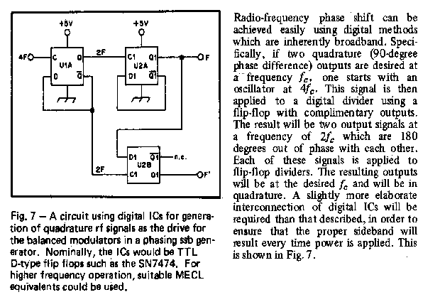

So, for the "standard approach" you described, one would get this, no?
But how would you get two signals 90° out of phase out of that? (I have no doubt that it can be done, just couldn't figure out this particular puzzle.)
Hmm, maybe you don't need that bottom wave, since you said 4 times the frequency, but since you're using 3 FFs, I wonder what the third one is doing.
surely a Wien Bridge Oscillator can set up the in phase and feed this though an integrator to get the Q phase. From my days at school, when differentiating Sine -> Cos and Cos -> negative Sine. This keeps all the waveforms as sine/cos and not square
So, for the "standard approach" you described, one would get this, no? ...
... but since you're using 3 FFs, I wonder what the third one is doing.
It is doing this as per the attachment.

It is in the book:
Solid State Design for the Radio Amateur
Published by the ARRL
I cannot see an ISBN number anywhere on the book.
It was published in 1977 and I think that it is out of print now.
The fragment which I scanned is on page 184.
