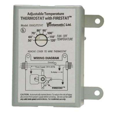

I have used one of these because I have several:
119464
It was designed for 24V ac but works with dc and almost any voltage. I use it to turn on a power relay that turn on the "240V/30A".

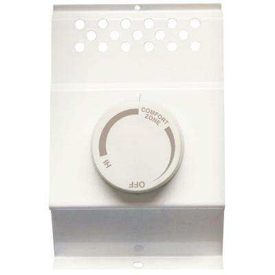

The lumber yard also has these. 120/220V ac/dc 22A. Used in base board heaters.
119465
I can't find a picture now, but electric hot water heaters have a thermostat much like the above.
