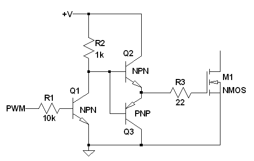

Ok:D so finally i had some time to open up the dashboard of my car, located the blower and installed a snubber diode in the blower. After testing my mosfet is still heating up like before which means i need to built the driver circuit.

You could try this driver circuit for the FET. Q2 and Q3 are the pair of transistors DrPepper mentioned. If your PWM source is low voltage (3.3V, 5V?) the additional Vbe drop imposed by Q2 could prevent the FET turning on fully. Use of a higher voltage for +V, plus Q1, can overcome that. Bear in mind, though, that Q1 inverts the effective PWM duty cycle.
Hi I finally made the driver, as you said my output was inverted so had to change some code and things started to work. I connected the driver +ve to the car 12V. Even after the driver circuit my mosfet is getting pretty hot dont understand why.
One mysterious thing happened, with the car turned off every thing worked except for the mosfet heating (tested over 15 min), the moment i turned on the car i heard a soft exploding noise and then smoke, I turned off the car and opened the blower compartment and found out that the diode that i connected with the blower exploded it got tosted. This can only happen if the polarity in the blower change.

If the FET still gets hot it may be oscillating. It is important that the wire from driver to gate is as short as possible.

heatsink is very tiny about 1 inch long and 1cm width, you can only put it in one fet or vregulator t12 package. driver circuit +V is direct car battery 12.xxV
Try a bigger heatsink.

driver and mosfet is next to each other with a 2 inch wire connecting them.
2" of wire hopefully isn't too much and causing high frequency oscillation of the FET.
Did you replace the burnt diode? One with a higher current rating preferably? Without the diode your FET may fail from back-emf spikes. Those spikes may be what is causing the FET heating.

no i did not replace the diode, the diode worked fine while i was testing and suddenly in just moments it exploded, which makes me wonder that the blower output polarity must be getting reversed with some settings. I need to further look into the wiring.
It's a very strange arrangement if some 'settings' (?) change the polarity :confused:
