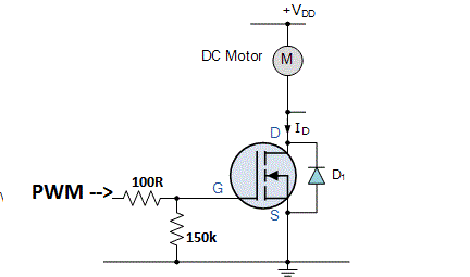

My schematic. Very simple and straight forward.

Can i use this to discharge my MOSFET.

Without having part numbers and a supply voltage shown on your schematic then we must guess if you used a Mosfet that needs 10V on its gate to turn on or if your logic is old TTL which provides a low current high of only 3.3V.
With logic as the driver then the Mosfet should be a "logic-level" one that turns on well with a gate voltage of only 4.5V.
A Microcontroller is made with HC Cmos that has fairly high current highs and lows through the 100 ohm series gate resistor then the diode at the gate is not needed.
Your circuit is missing a diode across the motor to clamp voltage spikes to the supply so instead the diode in the Mosfet avalanches which heats it.
At a higher frequency you may need a MOSFET driver to rapidly charge and discharge the MOSFET gate capacitance to minimize switching losses. The diode you show will not help since the 100R series resistor is small.
I cannot put a diode/snubber in the motor, i cannot reach that deep inside of the dashboard, i have to open up lots of unknown things to reach the blower motor:banghead:. Is there any other solution. My drain and source is protected by a fly wheel diode isn't that good enough.

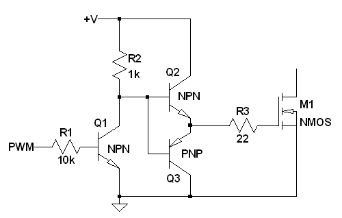

I think you need a pair of transistors or a mosfet gate driver chip.
Your mosfet at higher freq's is spending more time in its linear region, therfore dissipating more heat, switching it on faster will reduce the time in its linear region and will dissipate less heat.
You could try this driver circuit for the FET. Q2 and Q3 are the pair of transistors DrPepper mentioned. If your PWM source is low voltage (3.3V, 5V?) the additional Vbe drop imposed by Q2 could prevent the FET turning on fully. Use of a higher voltage for +V, plus Q1, can overcome that. Bear in mind, though, that Q1 inverts the effective PWM duty cycle.
Exactly what I was thinking, bc548 and bc558 ought to do the trick.
I think i will give this a shot. Thanks for the circuit. What is the purpose of R3.
R3 (100 Ohms in your post #7 circuit) damps any parasitic oscillation due to gate capacitance and stray inductance. The FET shown is what you have already; not an additional one.
My drain and source is protected by a fly wheel diode isn't that good enough?
No.
The diode from drain to source is not needed because it would block the drain from going negative which never happens and the Mosfet has a diode there anyway as part of its construction.
The drain does not go negative, instead it goes POSITIVE when the Mosfet turns off then the diode in the Mosfet has avalanche breakdown from the high voltage which causes heating. The diode must be parallel to the motor to prevent the positive voltage spike at the drain of the Mosfet. The cathode of the new diode connects to +VDD and its anode connects to the drain of the Mosfet. If its wires are long (far away from the motor) then it might cause oscillation ringing.
