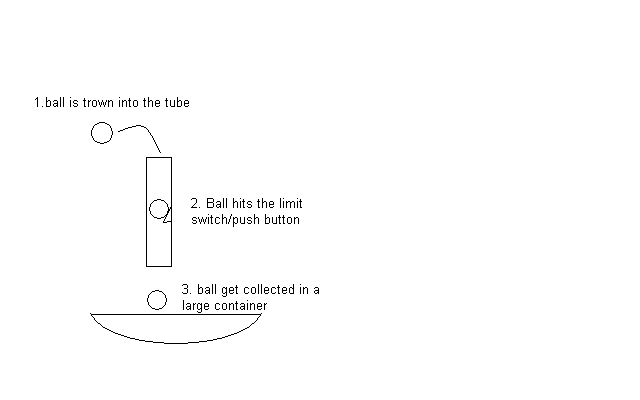

Lets summarise:
When the switch closes momentarily you want the 4017 and leds to run thru the sequence and then stop, display for 3 secs and go blank.?
Look at this image:
  • roulette.pdf
humm. im doing somethig like this. so when the ball is at no.2 it will +1 to a counter circuit and led running around it for 3sec or less
sorry and thanks :D
You need a freerunning (astable) 555 to CLOCK the CD4017 (LED rotation), and a monostable 555 to start & stop the LEDs via the RESET pin.
Have you tried a delay IC such as 4047 or 74C123? It may be possible to interface either IC to the 4017 or 555 to activate the LEDs for the time you specify.
