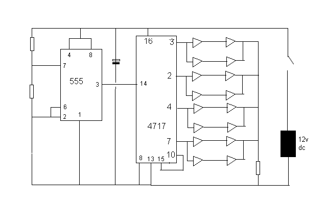

i was wondering, is it possible to make a delay with a push button?
this is what i actually wanted:
when i press the push button, a running led will run for 3 sec.
this is what i have:
i will need to press the push button(forever!!) for the led to run. once i let go. the circuit will switch off.

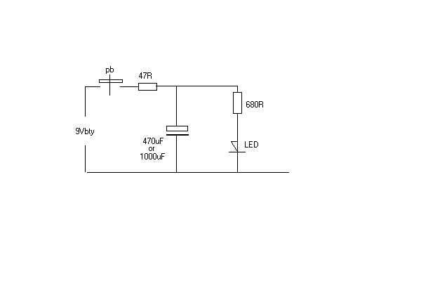

hi,:)
Have you tried charging a capacitor using the push button and then allow the capacitor to discharge thru a resistor and led.?
Its a very crude circuit, but do you need accuracy.?

Lokk at this image

Your dwg shows pins 2/6 of the 555 to 0V , it should be a cap.
Are wanting to hold ON any/all of the leds for 3 secs.?
Have you tried increasing that cap to say 470uF or 1000uF.[ the one shown from +12V to 0v]?
the led runs in circular motion. i want the circuit to run for 3 sec. is it possible? thanks!!!!!
Try a 470uF or 1000uF from +12V to 0V, keep the 555 and 4017 powered for 3 secs.
