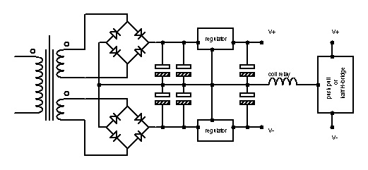

waiting to find the right relay can you tell me if the attached scheme can work?

it's just a very simplified double feed.
of course there are diode bridges, stabilizer circuits, and capacitors.

Then your schematic is so overly simplified that we cannot comment whether or not it will work. It is so simplified that it shows + and - power supply connected together. EVERY Person with electrical experience will tell you it won't work snd possibly damage your power supply and/or cause a fire. So, you'll either have to assume it won't work and redraw, add some detail so we can give a real opinion, or try it while protecting from fire or damaged power supply.
do you know a transformer with two secondaries joined together by a central socket and two diode bridges with a common output?

I understood what your diagram meant to show. :) Post #26 makes a good point. You should consider a dual coil latch relay because the drive circuitry is simpler.
A line frequency AC output transformer can be setup with two diodes to make positive and negative DC voltages.
is it clear now?

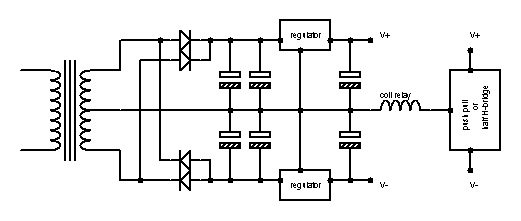

figure 1 or figure 2?

Post #32, figure 2 is incorrect. It produces two positive outputs, not one positive and one negative. The lower diode bridge is connected incorrectly.
Besides being correct, figure 1 is a better circuit because it achieves the same results with fewer parts and greater efficiency.

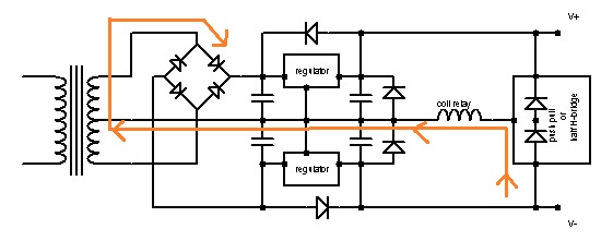

however what interests me most is to know if I can drive the relay coil in this way but not only.
Is the relay coil able to discharge the overvoltage after shutdown?
I'm sorry but the proposed circuit cannot work.
I make an example with the attached circuit which is the same as the one proposed. if the push pull or the half bridge H supplies the coil with negative voltage when the relay switches off it must discharge through the indicated path but is blocked by one of the internal diodes of the diode bridge. the same thing happens when the positive voltage is supplied to the relay coil but following another path. It should be noted that the darlington phus pull pairs or the half bridges H have inside them the diodes which are arranged as in the drawing in the box.

What are those bridge's "internal diodes"?
