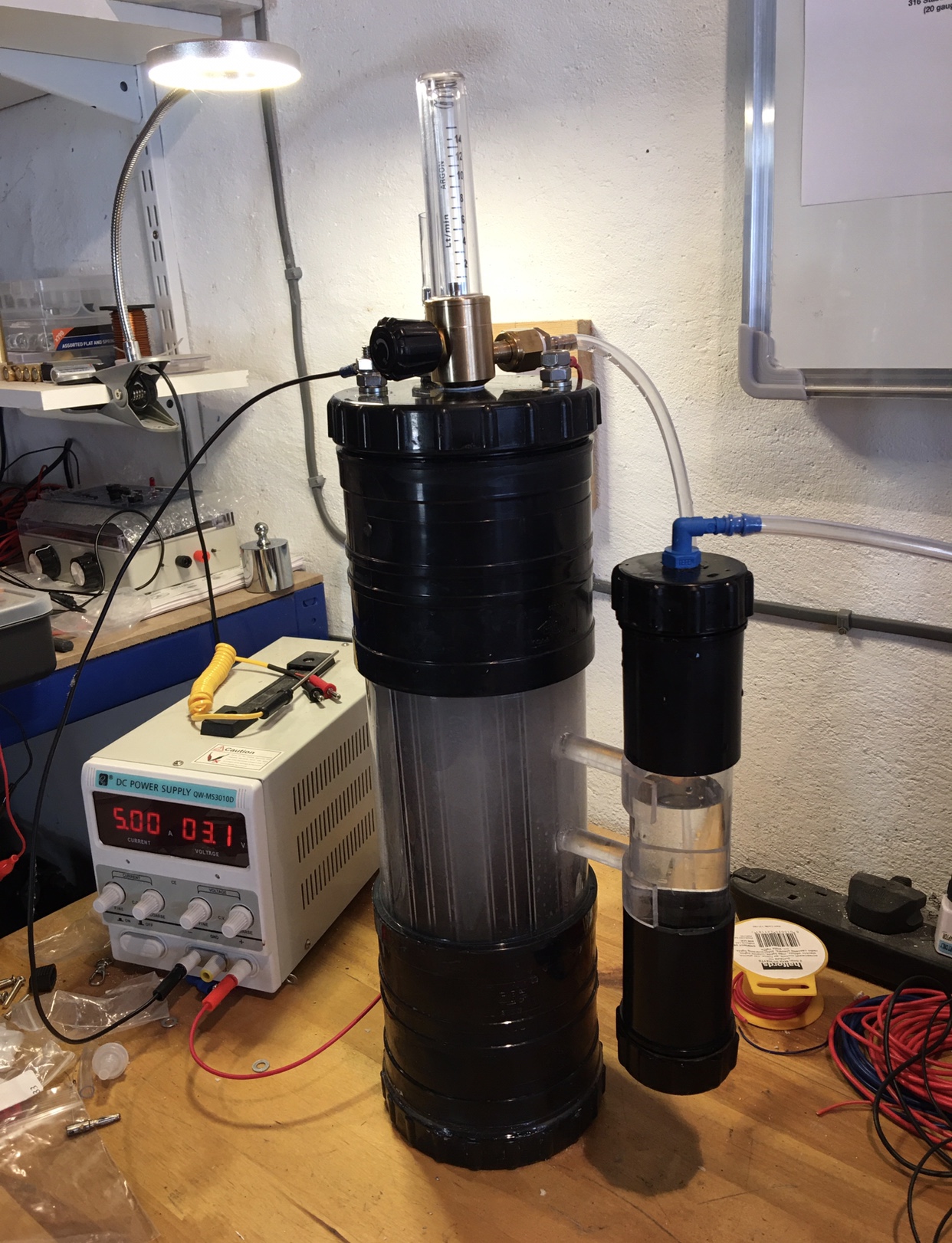

Hi there,
I’m building an Electrolyser to produce OxyHydrogen gas for brazing and welding (see attached). Part of the plate conditioning process requires putting 12V across the plates and allowing about 5-10A through for prescribed periods. However my modest lab power supply unit (supposed to be able to deliver 30V at 10A) seems unable to put more than 4V across the plates while delivering 9A.
I’m assuming this is a limitation of the PSU and so am contemplating building a beefier one using a power transformer and a rectifier/ smoother.
My question is: is the low voltage across my Electrolyser due to a ‘weak’ power supply or something else?

The online reviews of that power supply are not good, so the limitation doesn't surprise me.

I guess I’ve found its limitation.

What is it about the PSU I have that makes it unable to deliver 12V to my Electrolyser? Is the total power it can deliver not what it is rated at or is it something to do with the load I am using?
It's not a well made power supply. Read the reviews.
Play with plate separation and area of the plates.

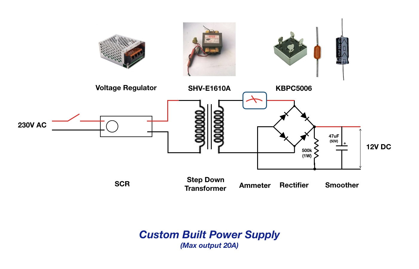

All sounds like fun but to condition my plates I need a PSU capable of delivering 12V at 10A max and my eBay one can’t do that.
Im thinking of building what’s on the attached but I’ve been told an ATX supply from an old computer will do that and enable me to control I and V.
If that’s so then I’m looking for a circuit to be able to set it up right.

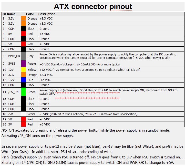

Have you heard of using an ATX unit from an old PC?
Plenty of projects use old ATX supplies. A typical 400W-rated ATX supply would likely give you 15A or so.
Yes and it works well.
It Needs a load so put a 10 ohm 10W resistor between any +5 red wire and ground.
An alternative is a 12 volt automotive turn signal bulb. It will be a load and glow just bright enough to be a power indicator.

That was my understanding of the amperage control too. Many people see this stuff on Youtube and take how some one lucky(so far) has done things. But a mix of oxygen and hydrogen right from the separator is an explosion looking for a place to happen. Especially someone that has no idea what they are doing. Shown very well by his "custom power supply schematic". The only thing to hope for is that he lives alone in an open area when using this, so no innocent is hurt or killed.
