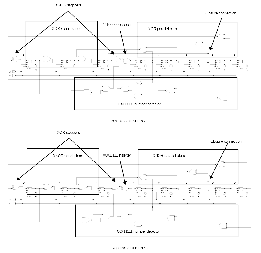

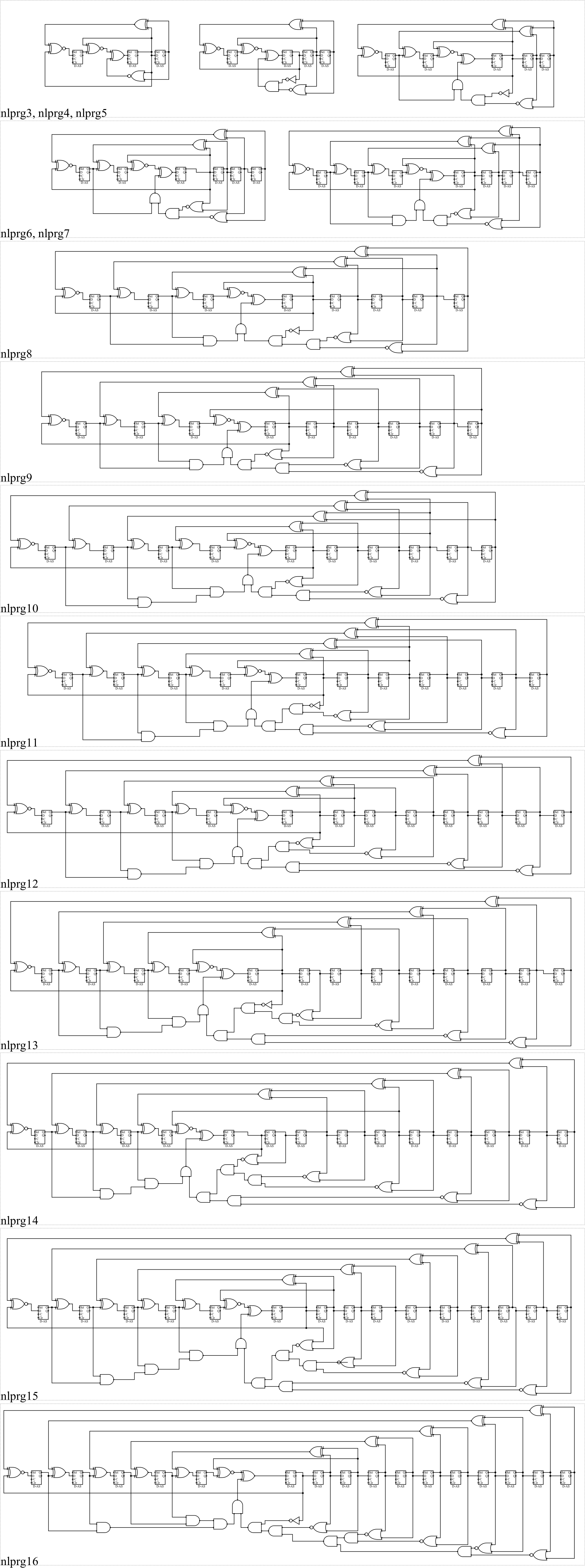

I would like to present a personal invention of mine.
It is a circuit that can produce a pseudo-random sequence with a period of 2^n numbers, where n is the numbers of registers.
The classical approach to generate pseudo-random numbers is to use Fibonacci or Galois linear-feedback shift register (LFSR) but the period of the generated random sequence is limited to 2^n - 1 numbers.
Furthermore, with the methodology I am proposing there are more circuit types that produce a complete sequence, therefore, it is more resistant to mathematical attacks.

So, you have to double the amount of logic so that your 16 bit SRNG can generate just one more state?
65536 instead of 65535? The economics seem doubtful.
There are few things to consider besides power consumption:
  1. It produces a complete sequence.
  2. There are more possible permutations of complete sequence typologies, which makes harder to predict the sequence.
  3. It can be optimized by making the transfer function more complex and therefore more secure.
It is extremely easy to break the pseudo-random sequence produced by LFSRs. This slightly more secure approach might be worth the power budget.
A Bijective transfer function for pseudo-random number generation will probably find its application in cryptography.
I researched on the topic and I did not find any equivalent circuit "a shift register circuit" with a complete sequence.
If you find a simpler way to do that please let me know.
Considering the aspect of power.
With normal LFSRs you generally need to perform a check on the seed to avoid the insertion of the dead code in the registers.
If the injected seed is wrong, than you need either to correct the fault or live with it. This is generally extra circuit that needs to be implemented in practical applications.
I hope this answer your question.

I compared the two with Dieharder running all the tests. Attached the results ( res.txt ), the code ( nlprg16.c and the lfsr16.c ) and the produced sequences ( nlprg.txt, lfsr.txt ).
I agree with you that shift registers-based pseudo random generators are not secure ( both the NLPRG and the LFSR ) , since there are shifts in the transfer function, ( bits that you do not need to compute in order to predict their value ). If all the bits needs to be computed ( are the output of a gate ), the problem to predict the sequence becomes cubic with the number of bits. You need to solve a system of linear equations with algorithms such as Gaussian elimination, which is still trivial as you said with modern processing power.
Having said that, the question I am trying to answer is:
Is the NLPRG more secure than LFSR? ( do you need more numbers to predict the sequence )
Has the NLPRG better statistical properties when compared LFSR? ( for instance the period of the NLPRG is one number longer than the LFSR )
etc...
If the answer is yes, than it is an improvement. Since LFSR are studied in universities, widely used in a variety of applications ( cryptography included ) and they have not been not improved since the 50s.
I do not understand much about those tests. The NLPRG has passed as assessment in all the tests except 2 weak, wheres the LFSR has passed as assessment in all the tests except 3 weak. The tests where the NLPRG and LFSR are weak are not the same.

The sequences are complete no opinions there, for instance the 16 bits nlprg has all the numbers from 0x0000 to 0xFFFF. And I do not get what do you mean by overflow, it is a shift register and therefore there is no overflow.
You are welcome to run the code and test the produced sequences. I did not say this before but I am very happy and ready to help if anybody wants a more clear explanation of the algorithm or if somebody has problems to run the code. The best way to reach me is by email: fd at francescodellanna dot xyz.
The code is at this link https://gitlab.com/francescodellanna/nlprg/-/tree/master/examples
I tested all the nlprg sequences with a counter. For example in the 16 bits case, both of them are initialized with 0x0000, any number would work. If the counter or the nlprg reache the number 0x0000, than end the simulation. If at the end of the simulation, both the counter and the nlprg are in the 0x0000 state than the sequence of the nlprg is complete.
I explained also how it works, it is like a more complex lfsr with a sequence of 2^n-1 with a number detector and a way to insert the missing number in the sequence.
If you want to know how visit:
no matter where in the sequence you seed, the sequence remains the same, all you are doing by seeding a number is changing your start location in the sequence. for instance if you seed A2F7, and the next numbers are D17B, E8BD,F45E, and 7A2F, this is in a particular part of the sequence, so even if you started at 0000, once you get to the location in the sequence where A2F7 is, the next numbers will always be D17B, E8Bd, F45E, and 7A2F... you might as well store the whole sequence in an eprom and step through it incrementally. plus you want to add a 17th bit that is only used once, which is a waste of that bit. it would be better if you used that bit to double the length of the keyspace rather than satisfying some desire for "neatness". there may be a perfectly good reason sequences of 2^n aren't used, especially as this type or PRNG has been in use for a very long time, my guess that it would be because 2^n sequences have serious weaknesses cryptographically, otherwise 2^n-1 sequences wouldn't be so widely used as would 2^n sequences. it only takes tiny differences in the math to change a secure cryptosystem into one that leaks like a sieve...
The 17th bit? I do not understand where does it come from, and why you bring it up. I do not want to add any extra register. All the circuits I posted before do not have extra registers.
I can post here the C code implementation of the nlprg algorithm, probably will clarify something. You are strongly encouraged to try it out.
As you see the nlprg16 function does not have any variable inside, it just shuffles the bits.
The only variable used ( nlprg ) in the main function is declared as uint16_t so 16 bits.
