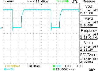

I decided to build my own PWM controller and I found a 12V/5A SMPS.
The schematic is this: https://www.multisim.com/content/jcWPXBhUCutR4dmEitXfLg/high-frequency-pwm-with-ne555/open/
And I built the circuit on a breadboard.
But on the oscilloscope, it looks like the attached screenshots **broken link removed**
Why it does it look like this and not like the results from the simulation from the above link ?

I managed to make the waveform better by adding 2.2uF capacitor and 100uF capacitor. I added the 2.2uF capacitor very very close to the power pins of 555. I also added a 100nF capacitor. But the waveform is still not looking as expected from the simulation.
Why the wave form does not look perfect ?

I also can't see your attachments but...
Circuits that you run on a simulator can appear perfect because they're using perfect models with perfect connections and no parasitic effects.
Circuits that are built on solderless breadboards are not perfect, and can suffer from stray capacitance, inductance and resistance that can make circuits misbehave.

I cannot see your attachments but I assume you are seeing a non-perfect square wave. It could be your power supply is sagging as the 2.5A load is quickly applied. Or it could be an inductive effect you are seeing as the PWM hits beach off cycle.
I hope you are not trying to drive your 2.5a load directly from a 555 timer.
Also, solderless breadboards are not intended to carry 2.5A so you may see some effects from that as well.

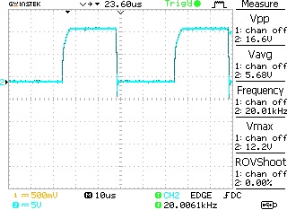

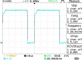

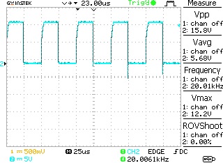

Sorry for the images. They appeared to be ok when I uploaded them.
I built another PWM, using an Arduino UNO, and I got the following screenshots:
The 1, 2 and 3rd are with the oscilloscope probe on the load ( I used as load a 27R/5W resistor), and the 4th one is from the Gate of the Mosfet ( I used an IRF630). I used a 100R gate resistor and a 10k pull down resistor.
The code is using the PWM.h library. I also used a potentiometer to "create" the square wave at the output.
Please have a look at the screenshots and please tell me if they are good or not.

Most switch mode power supplies,or at least ones not made for motors don't like motors. The commutators and brushes of the motors put them into shutdown mode.
The waveforms look ok, you can see the lack of drive current to the gate, hence the rounded leading edge, and theres a little ringing, but it should still work Ok.
You'll need to make sure the 'duino is well decoupled or the noise from the motor will mess things up, also make sure the motor doesnt briefly pull so much current that the voltage drops & resets the 'duino.

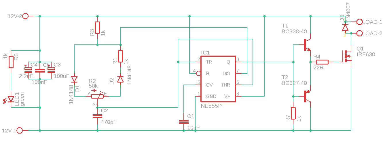

I built the attached schematic and it looks like it is working good.
I am interested in attaching a snubber circuit to my schematic.
Can you please answer a few questions for me?
1. I saw on the internet different types of snubbers. Some of them are capacitor and resistor, others only capacitors, others zener diodes, etc. Which one should I use in this project ?
2. Where should I connect the snubber circuit ? In parallel with the load or in parallel with the mosfet (D to S) ?
Note: in my built schematic, R7 is missing.

The Rc method might not be so easy.
The C needs to be big enough to absorb the energy in the spikes and the R enough to damp it.
A method I've seen and used is to solder a 100n cap across the motor, then solder another 100nf to one motor terminal then to the motor case, and the same on the other terminal.
