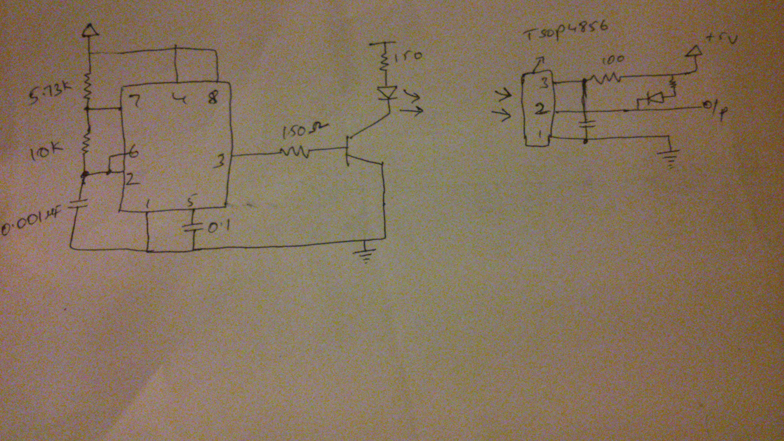

ok. I have used only one 555 timer. I have uploaded the circuit diagram i have used. I have used 56khz carrier freq and tsop4856 at the receiver side. According to the circuit, are the signals pulsed at 50 % on off or does the led emit continous signals. If it emits continous signals, what changes should i make in the circuit for on off signals and how could i vary the on off period.

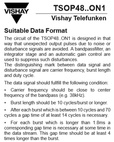

The datasheet for the TSOP IR receiver (and almost all of their IR receivers) shows that it needs its 56kHz pulses turned on and off in bursts of 10 cycles or more for the AGC to keep the gain high. If it receives continuous 56kHz pulses the AGC reduces the gain a lot so the IC will not respond to 56kHz compact fluorescent light bulbs and it might not detect your IR pulses.
yes, I have read the info in datasheet. I have found this basic circuit in internet and believed that the led is turned on off with 50%duty cycle. after seeing my circuit, can someone explain if the signals are turned on off or just sending a 56 khz continous signal. If not how could i turn them on and off. an explanation with circiut diagram would be very helpful for me
You need a second 555 (or use a 556 which is a dual 555) to turn on and off the 56kHz oscillator to make bursts of 56kHz.
56khz for 250msec, then 250msec of silence, then start over.

Your attachment shows a circuit that blasts bright IR for a very short distance.
I think the instructions in the datasheet should be followed, "For long burst lengths, the gap time should be 4 times longer than the burst."

The timing capacitor in a 555 oscillator charges for a longer time through two resistors in series but discharges for a shorter time through one resistor. When charging, the output goes high. Then the circuit linked here with the 556 IC does the duty-cycle backwards. The 56kHz pulses for the IR LED are turned on for longer time than the gap between bursts.

The burst length should be 10 cycles of the 56kHz or longer (select 11 cycles) and the gap time between bursts should be at least 14 cycles for a burst length up to 70 cycles, select 15 cycles of 56kHz. Then the minimum burst time is 196us and the minimum gap time is 267us for a maximum frequency of 2.16kHz.
How will you turn the 56kHz 555 oscillator on and off? The circuit linked has the duty-cycle backwards.

"For each burst that is longer than 1.8ms a ----- gap time ----- should be at least 4 times longer than the burst". 1.8ms is a very long burst time resulting in a low frequency.
The datasheet also says, "After each burst which is between 10 cycles and 70 cycles a gap time of at least 14 cycles is necessary".
11 cycles of 56kHz is a burst time of only 196us, not 1.8ms which is 9.2 times longer.
Then the gap time can be 14 cycles of 56kHz= 249us. The total time is 196us + 249us= 445us and the frequency is 2.25kHz.
