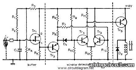

Any idea how this works?
I would hazard a guess that the 'transformer' at bottom left plus a few adjacent components form an inverter putting out a high voltage (>1kV?) which is applied to the probes. Conduction between the probes when ions in a flame are present would then be detected by the rest of the circuit to energise the relay at bottom right.
I am not entirely sure high voltage is needed, I saw one schematic that ran off 12 volts but could not find much info on it.
