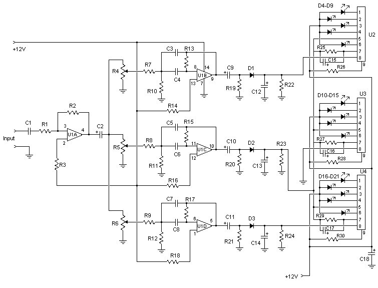

hey..for the following circuit..the input is from a cd player
but the problem is..if i give the output of cd player here....
how can i get an audible output :S
need help

It's not really very clear what you are asking?.
If you just want a complete audio signal, you could take it directly from the CD player, or after the first opamp. If you wanted the three filtered outputs?, you could take them after the filters, but before the rectifiers.

You can't connect a speaker, you need to connect a power amplifier, that then feeds the speaker.

The output of a "cd player" is a line level signal, and can't feed a "speaker", so either it doesn't work?, or you're using the incorrect name for one or both items?.
If your "cd player" has an amplifier in it, then it's NOT a "cd player", it's a music "system" of some sort. Your "speakers" could have amplifiers built-in?, but in that case they need power leads of some kind?, and it's fairly uncommon.
Simple question! - do you have a volume control?, and where is it!. (The volume control will be on an amplifier.)
