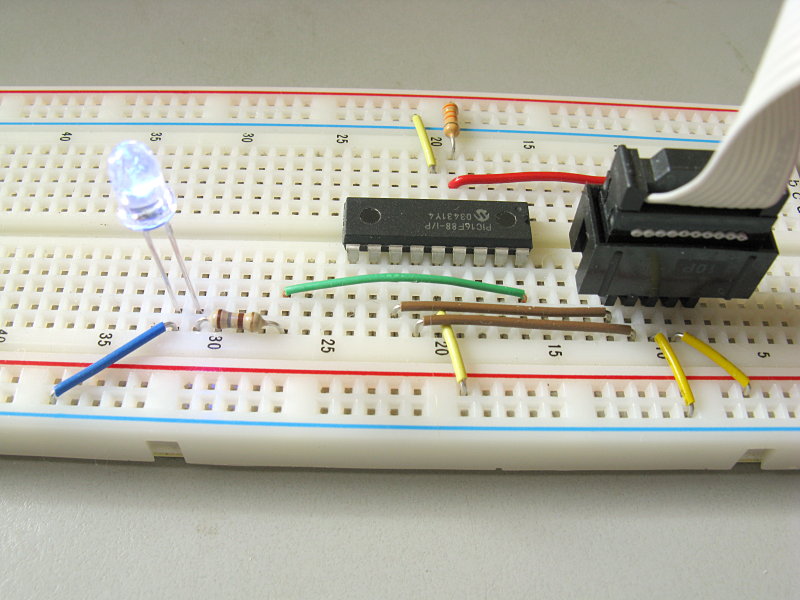

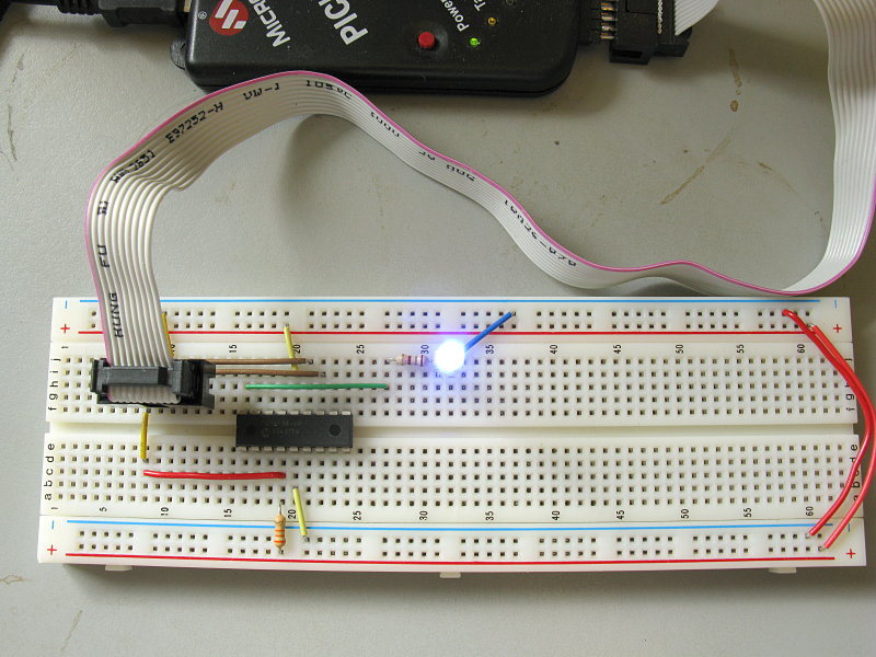

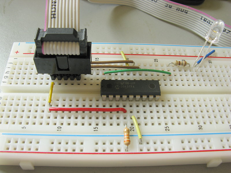

OK. Here it is, complete, and all in one post, with photos. :D
That's a blue LED, so I used a 180 ohm resistor. For a red or green or amber LED you'd probably use a 330 ohm or even 470. Not terribly critical. But do use a current limiting resistor somewhere in that range.
It has a 33K MCLR pullup. Any value from 10K to 33K is fine. It's not critical at all.
