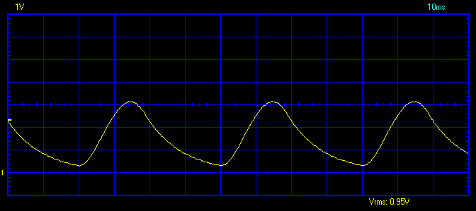

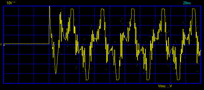

Sorry this took so long, a Raspberry Pi happened to pass my way and I couldn't resist. My efforts to get a decent sine wave out of my transformer have been met with limited success. I have increased the PWM frequency to 8 kHz and this is what I get out of the transformers primary windings (I haven't increased the number of values in the sine lookup table.)
My knowledge of magnetics is somewhat limited. Anybody have any idea what is going wrong here?

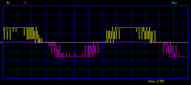

I have made a snapshot of both PWM signals which control the two MOSFETs. I have also fed one of these signals through an RC low pass filter (100n, 100k) and recorded the waveform there as well.
Yes, your PWM frequency is 1kHz, which is much too low. The transformer does not filter out 1kHz very well, so it is appearing as nasty 1kHz noise on the transformer output.
Try increasing PWM freq to 10kHz or better still 20kHz.
It's ringing :) I have changed the PWM frequency to 8kHz and simply tried connecting a phone bell to the transformer output - and voila! Admittedly, the output waveform is not exactly a clean sine wave but it does the job.
