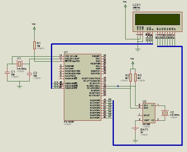

Hi everyone!
I’m trying to connect a pic16F877 with a DS1307 using I2C, but I’m getting some problems, and I can’t find what I’m doing wrong.
I’m using the next program.

In attachement is the circuit that I’m using to test the communication. Hope that is noting wrong with it.
I had make a simulation in Proteus and I can’t get any data from de DS1307.
The 1º memory address from DS1307 should be save to the DS_data register but instead I only get 00000000, even running the simulation for over then 1 min.
Did anyone can tell me what I’m doing wrong??
Tanks!!
Please post the complete program so that we can run it.:)
Also when you post the asm file, use the 'Manage Attachments' button lower down the post reply page.
Problem solved
The program only was reading de second address from de DS1307 and displaying the bits in an lcd,
I was running the program in a loop (reading, displaying, reading, displaying,…) and the loop was to fast, just put a 1ms delay after each loop and it work fine.
But seem that’s not all, simulating the circuit in Proteus, it only work if i add an I2C Debugger to the circuit, I don’t know why but it work, maybe this can someone that is having trouble with I2C and Proteus.
Tanks for the help.
