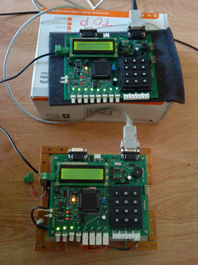

Hi, i'm trying to make RS232 communication between two boards with PIC18F6585, keypad and LCD. I want to send characters from the board1 keypad to board2 LCD and vice versa. The first thing works fine. I'm sending from board1's keypad and receivig to board2's LCD. But when i'm trying to send from board2 and receive to board1 the boards just hang-up. I am using two functions for transmit and receive.
The function kbd() reads the character from the keypad and sends it to the USART. The usart() function reads the USART buffer and sends the characters to the LCD. I'm trying to switch these functions when i press the '*' key on the keypad.
I am using the C18 compiler and the standard function for the USART included in usart.h.
I'll post my code for you to understand exactly what i'm trying to do.
I have this code on the two boards with that difference that in the main() function of the board1 firts is the kbd() and then the usart() and on the board2 first is the usart() and then the kbd().
