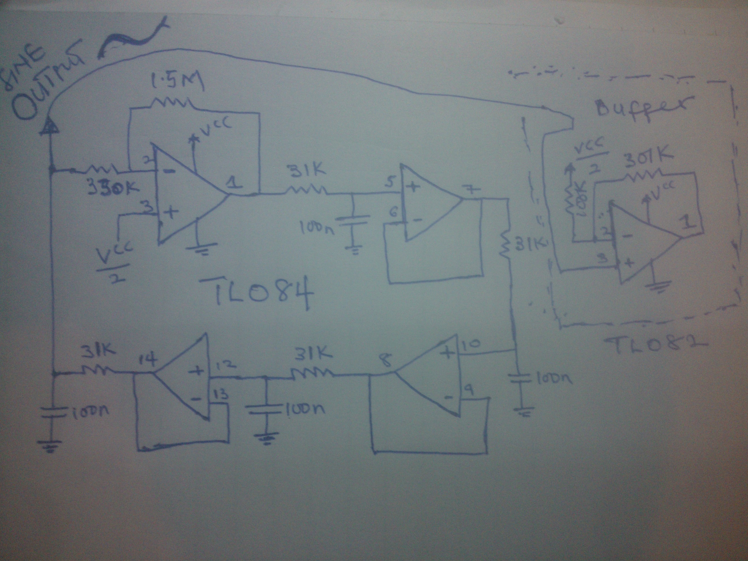

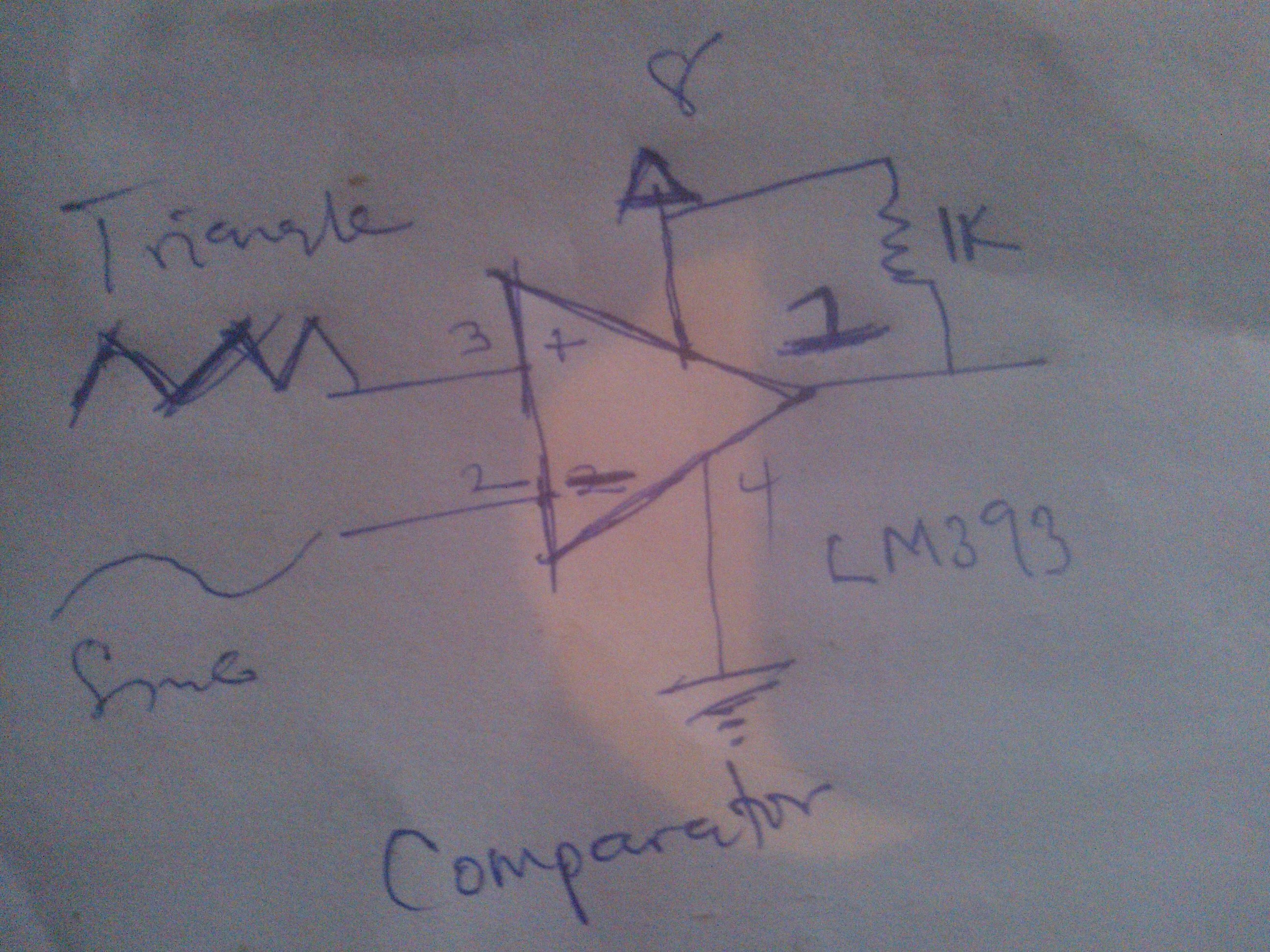

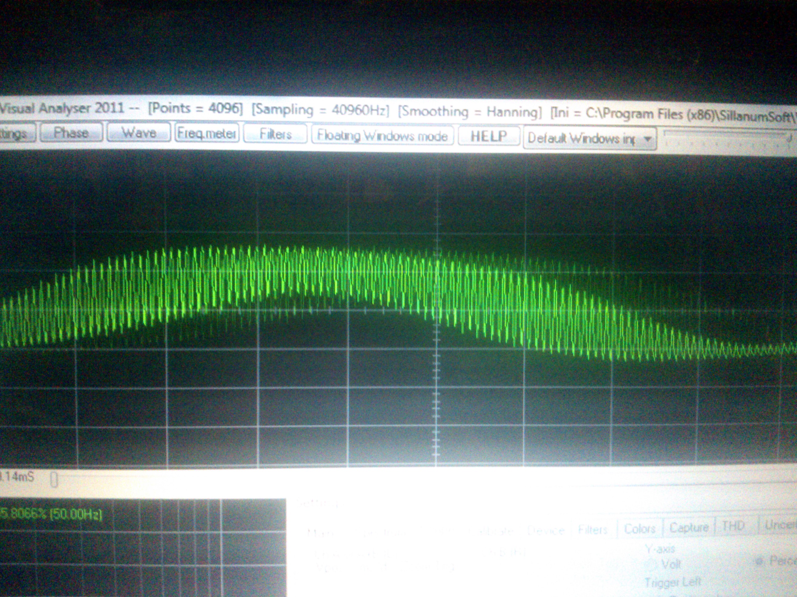

i built a bubba oscillator of 50hz frequency and had to buffer the point where the signal has lowest distortion using TL084 for the original oscillator and TL082 for the buffer circuit.i then built a triangle wave oscilltor of about 3000hz - 10000hz range and set it to about 5000hz but when i wired up the comparator using LM393 to get PWM signal i am getting strange signal and i dont know what else to do here are the pics of the circuit.
am kind of confused on what am doing wrong since i was able to get the bubba to oscillate well at 50hz and the trinagle to oscillate well between those frequencies and keeping it at 6000hz for pwm but i dont know whats happening.

Hello,
Can you show some scope pics of the two inputs to the comparator, the non inverting and inverting terminals?
And is that scope pic you had shown of the output of the comparator or something else?
If the comparator is powered ok and working ok it will definitely work at 50Hz. You might need some hysteresis though too. Note that if your input signals swing from -8v to +8v for example, you can not connect your comparator to +5v and ground or even not to +10v and ground. The comparator would have to be connected to +10 and -10 volts as well. If you need a PWM signal that swings from 0v to +5v or from 0v to +10v, then we have to do a little level shifting.

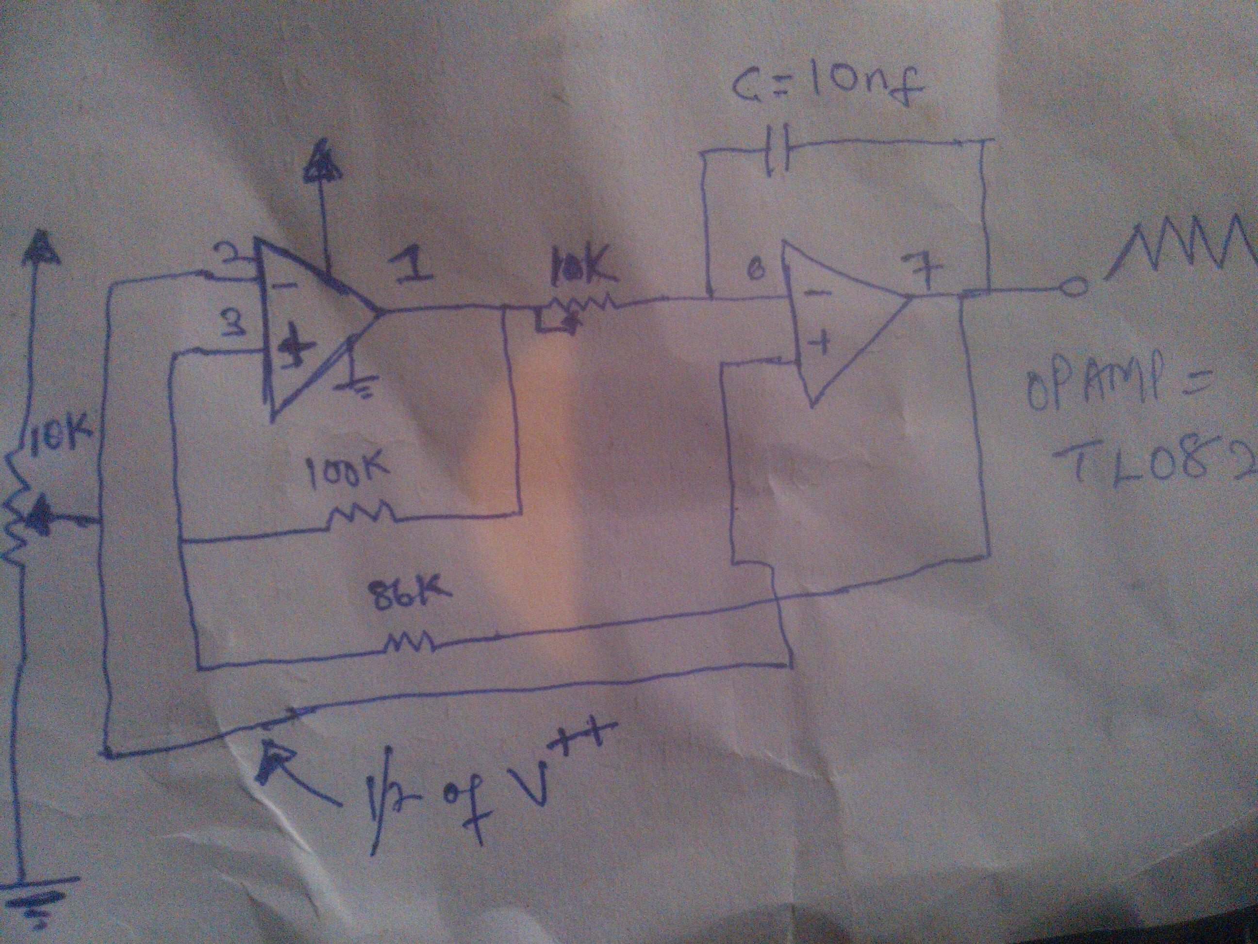

hello i have been following the thread on the guy who wants to build a 200Mhz triangle wave and i saw the part where he connected a triangle wave to the noninverting input of the comparator in my case is pin 3 of LM393 and the 50hz sine wave to the inverting input that is pin 2 to get a PWM signal and i just followed his lead.
my input signals cant swing from negative to positive since am connecting it using a single supply of +12v and setting the reference to +6v thereabout(half of vcc) for both sine and triangle waves so i dont understand why it should swing from negative to positive maybe you could enlighten me you know better than me and you are more knowledgeable.
how do we do this hysterisis and level shifting because i need the signal from 0v to +10v or higher.
and yes that scope pic my friend is unfortunaltely the output of the comparator where the PWM signal is supposed to come out from.i even changed the LM393 several times just to be sure that it was not at fault but it is still thesame output.

The schematic for the Bubba oscillator is not shown. The schematic for the buffer amp for it is not shown and explained why it is needed.
The maximum allowed input (input common mode voltage range on the datasheet) to the LM393 comparator is 0V to (+12V - 1.5V=) +10.5V so the triangle wave is probably OK but we know nothing about the sinewave and its buffer amp.
The LM393 comparator output is overloaded with a 1k load so its max output current is trying to be 12mA but its datasheet shows it saturating with a 4mA or less load.
The circuits here do not have very important supply bypass capacitors.

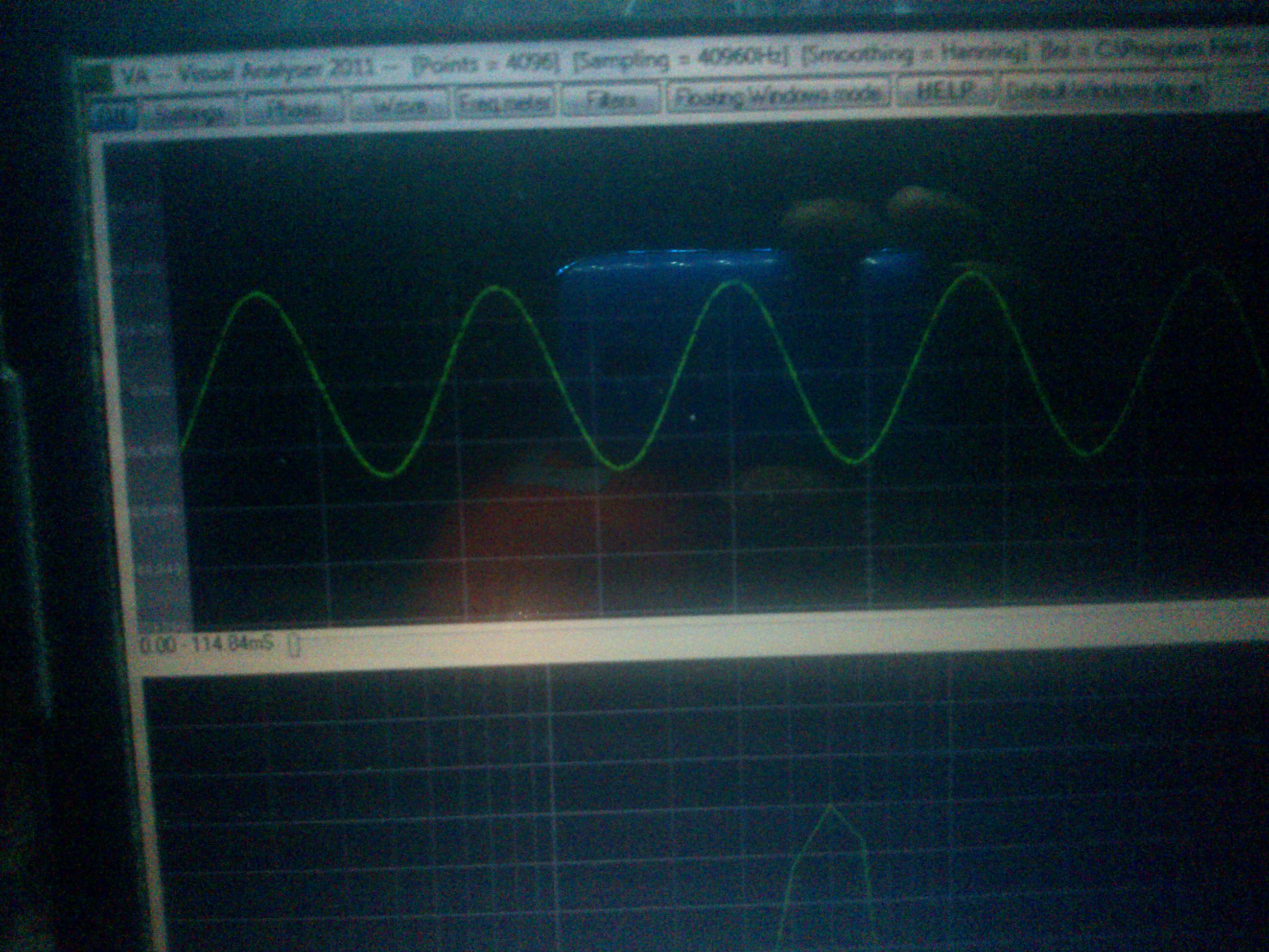

The scope is a software one that is messing up the output waveform because its sampling frequency is much too low and maybe because it is set for an AC input instead of a DC input. The software scope has filtering that might be messing up the waveform. 0V and any mention of how many volts per line are not shown.

Yes. This is extremely important. When the comparator changes state, it will send transient voltages back into the power supply lines which will interfere with the other signals. You need to connect a 0.1 µF capacitor from the comparator chip Vcc pin 8 to ground pin 4, as close to the chip as possible.
Also, are your signals coupled to the comparator inputs through DC blocking capacitors? If so, the inputs will need to have bias circuitry added (resistor voltage dividers) so that the inputs don't float up to +Vcc or down to ground levels.

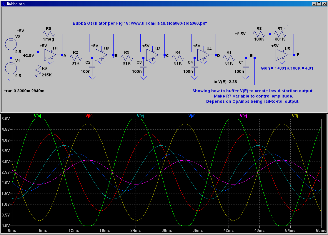

here is a picture of the bubba and the scope wave form.changes made to the bubba are R5= 1.5meg R6=330k all other values remain thesame and like i said i used TL084 for the mainn sine wave and then TL082 fot the buffer circuit consisting of R8 and R7 and i powered from a 12v source.i bufferd the output because at that point it has the least amplitude and lowest distortion so i read about bubba oscillators and tested it.

As for the software it is visual analyzer 2011 and am still checking it out as am not used to it yet and dont now all the fuctions and yet to even caliberate maybe with time will get some understanding

You are very confusing when you post a Bubba oscillator with the wrong opamps (not rail-to-rail), different resistor values, a different supply voltage and do not show how its first opamp is biased.
It is too bad that your software scope cannot show DC levels and peak-to-peak voltages.
The 1k resistor in the comparator is its important collector load. Its value is too low for a weak LM393, use 3k or 3.3k instead. Reduce the input levels to the comparator a little then it will work perfectly.

I am still waiting for a scope pic of both inputs. If we could see the two inputs as they arrive at the comparator, we can then tell if the signals are of the proper level or not. If the sine swings from 0 to +5v and the comparator power supply is ground (0v) and +10v then it should work ok because the comparator can work with input voltages from ground (0v) up to Vcc-1.5v, which for a 10v supply is 8.5 volts. So the max input to the comparator has to be 8.5 volts with a 10v supply, and 0v for the min input. So the sine can swing from 0 to +5v but NOT from 0 to +10 volts for example. Same for the triangle, 0v is the min and 8.5v is the max.
If you happen to be using a +5v supply for the comparator, then the input limits are 0v and 3.5v which as you can see is much lower. If the sine swings from 0 to +5v then that would not work when using a +5v power supply.
So you see why i want to see the two inputs on the scope because that tells the WHOLE story and we can probably clear this up in one more reply post. You should also measure the comparator power supply voltage right on the IC chip pin just to make sure, and report that value back here too.

A REAL scope will show the actual output voltages of the oscillators. The output of a TL082 or TL084 opamp cannot go to 0V.

sorry for confusing you with that bubba picture.i thought i explained well enough,so heres the actual circuit i used to clear things up.all circuits powered from a 12V lead acid battery as you said.
1)pls can you expalain what you mean by TL082 an TL084 opamp cannot go to 0V and rail to rail opamps?
2)f you know a list of rail to rail opamps ior where i can search i would be glad.the problem is here i was able to get only TL084 and TL082 which seeems to be common where i stay and even those who sell it dont know what an opamp is. i could not even find the MC33172 you once used in your PWM circuit to drive a motor so getting a list would mean i have a pool of options to search around for.
3)do you know of any scope software that can show peak to peak and what other comparator can i use or do i stick to the 393?
hoe my questions are not too much.Bear with me.
Your lead acid battery is about 13.8V. A rail-to-rail opamp is usually Cmos and its inputs and output can go from 0V to 13.8V when the load current is low.
The TL082 dual and TL084 quad have Jfets at the inputs and has many ordinary transistors as emitter-followers at the output so the input can go down to about +4V and up to 13.8V and the output can go down to about +1.3V and up to about +11.8V.
I have a REAL scope that works perfectly. I have never seen and have never used a software scope. I think you have your software scope set up for AC signals when it must be set for DC signals and calibrated.
The LM393 comparator will work perfectly on a pcb (but not on a breadboard) when its collector resistor is 3.3k ohms.

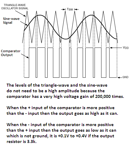

The difference between using a rail-to-rail opamp with an output of 13.8V p-p is small compared to using a TL08x with an output of 10.5V p-p.
The output level from the comparator will be exactly the same!
EDIT: The voltage gain of an LM393 comparator is typically 200,000 so when the inputs have a very tiny voltage difference then the output switches completely high or very low. The output of a comparator is never at a partial voltage.

The input signals to the comparator do not need to have a large amplitude and do not need to go to ground. The comparator has a very high voltage gain of 200,000 times so the input signals only need to have the same bias voltage (half the supply voltage) so that one goes higher than the other and lower than the other. The output of the comparator is a switch that goes either completely high or very low, never at a partial voltage. See my attachment.
I mentioned rail-to-rail opamps because they are common here and the sample circuit that was posted used them. The resistor values in the sample circuit must be changed to reduce the levels so that clipping does not occur.
