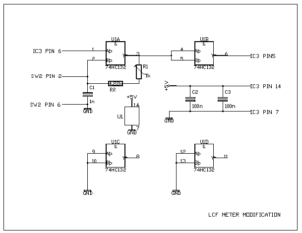

while the L meter looks like it works ok! the capacitance meter it's not!!! it goes crazy showing various indications.
i don't know what's wrong with it.....
guys any help?
the display constantly changes values when i'm measuring capacitors
there is no steady indication and also not close to the real value of the capacitor.
But when i turn it to inductor mode it measures fine... an 20uH inductor shows it is 23uH.
guys any help?
please indicated the exact components used by you, there was a suggesion to add 68pF cap
please search for LCF meter in edaboard.cpom
also there were some suggestions given long back one such is attached as txt file. please see.
  • lcfmods.txt
