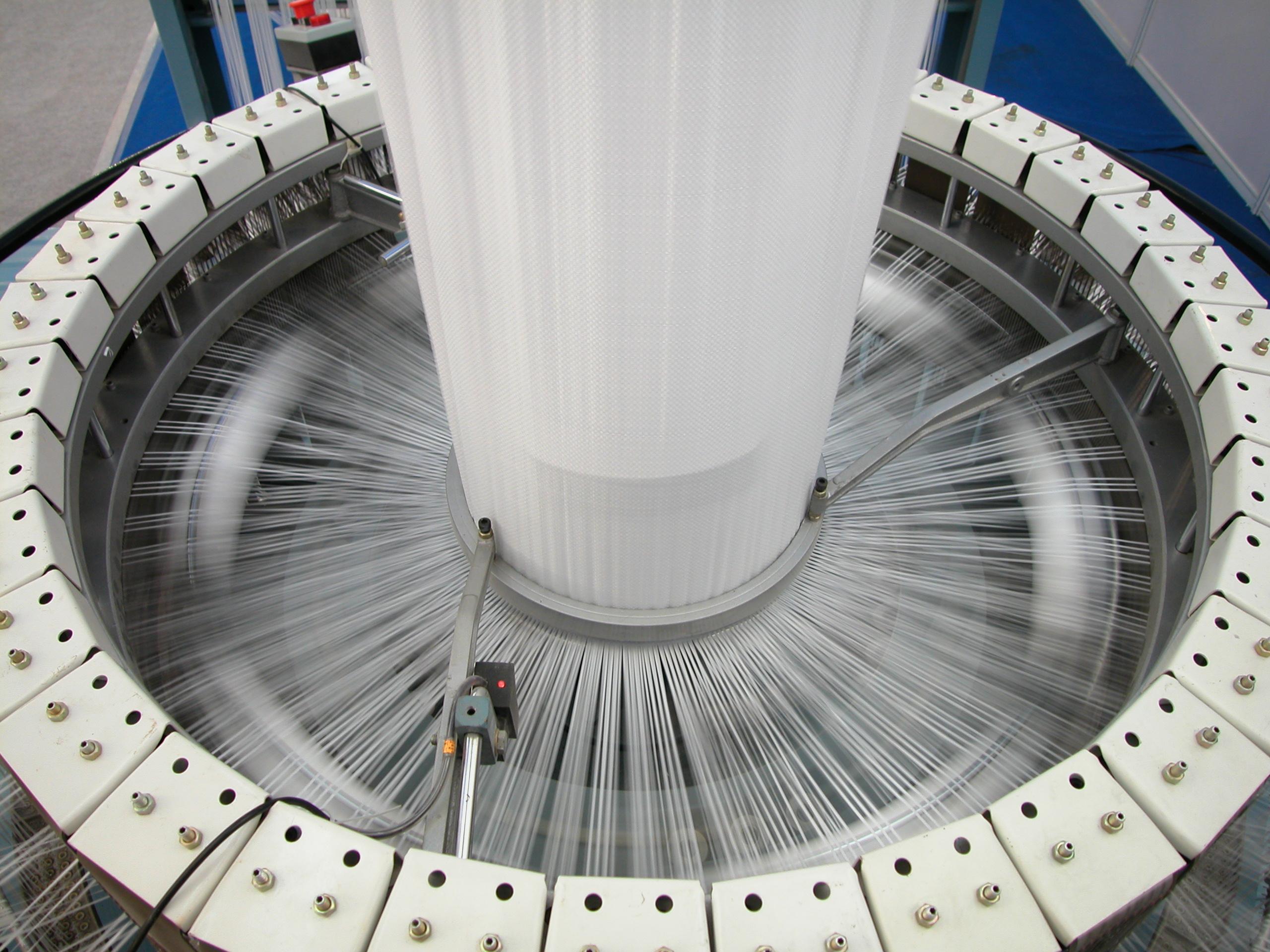

The shuttle's string swings are not so noticeable at all. You think the spool's string has a lot of swings? It does not at all.

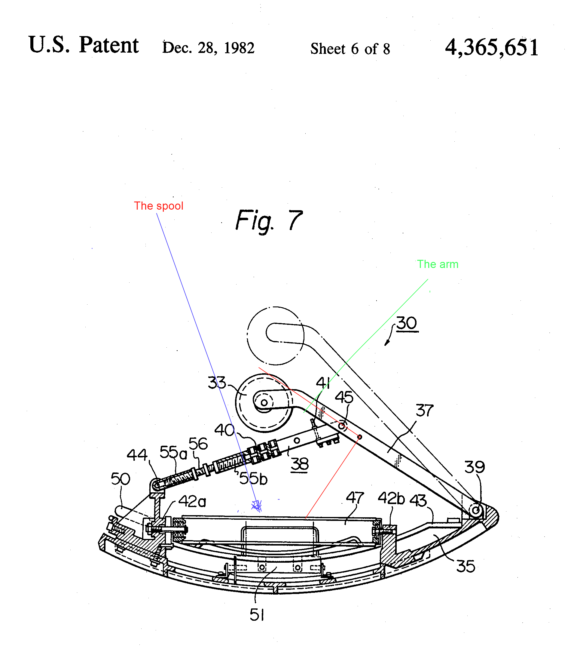

Here is a picture of a typical shuttle.
You can see the spool place (the blue line), and the related string (the red line).
In accordance with the reflector, I put a cube surface having a mirror on it under the arm and I said what would happen in the other post…

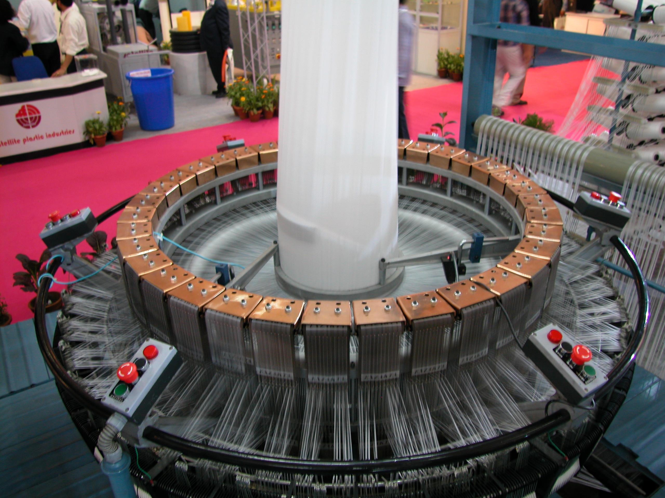

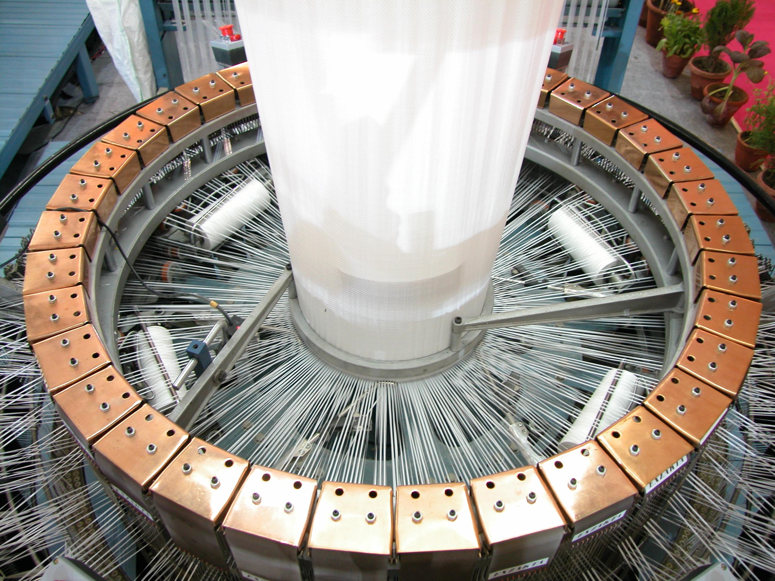

here are 3 typical pictures which I have found via the net:
You can see the reflector system on them too.
Hope they help you guys to understand me more clearly!

Thanks Wizard,
I understand the process now, and very helpfull here was the drawing from this patent thingi.
The task as I understand, is to stop the process when one of the four strings breaks (or the spool on the shuttle ends).
In the xyz space, position of the string on the shuttle is a variable that can not be easily monitored.
But, the string from the shuttle is always in a very predetermined and constant (x,y) position with respect to the arm - as shown on the drawing you supplied anotating the string as the red line. If a photo sensor (transmitter and receiver) were mounted on this arm in the exact position where the string always passes (with the string being in the middle between them), then any movment of the arm can be totally ignored because the sensor does move with the arm just as well as with the string always between them.
As long as the string is present, the (photo) Rx can not see the Tx, if the string breaks - an instant detection occures.
Some tunning of the sensor would be required (I am thinking of a window comparator past the photo RX stage, and initial luminosity(current) adjustment on the photo TX side. Infrared is probably the best choice to avoid false triggering from ambient light. Also, the string vibrates diagonally to some extend and this, just as well as the thickness of the string versus the area of the Tx/Rx IR beam - is the reason for requirement of some signal processing past the photo TX-RX but within the sensor. Ultimately, the output from the sensor is a Go/NoGo type of a signal.
The string is not touching the photo TX-RX, I think this was the requirement.
Four shuttles, therefore four sensors with outputs ORed to produce the "stop all" signal.

According to the shuttle and the arm set I think we have 2D motion not 3D.
Well I did not use any sensor under the line, just a mirror; the IR TX and RX were mounted in the IR system at above the Loom system (Just like 3 above picture).
They are hidden under the arm and rotate in respect to it, when a string is breached or cut off then the mirror comes out of the arm and reflects the light emitted by the TX IR into the RX for an instant per every revelation.
According to the numerous strings, fortunately they have just a one axis motion. So there is a spring for any of those strings (they are more than 300). When one of them is broken then the spring hits the metal body of the system and this why the system stops working. Those strings are tough when are not broken. Makes sense?
You have to consider that using of any tick in respect to the shuttle's string causes tension. So I think the best solution is working on the spool rotation along its axis?

Think metal detectors. Pulse Induction metal detectors induce a current in the target object and then look for eddy currents. They work reliably at 12". With a magnet providing the pulses it will be relatively simple.
My assumption on the geometry is that the shuttles provide thread that goes around the sack hence my assumption that the relationship between the two speeds is the square of there diameters. How can a shuttle go around a hub and not provide enough thread to match the circumference?
Straight ratio, there is no square term in the circumference. 1M×PI around the sack and 1-3CM×PI around the shuttle.
Dan
Yes, my bad, a straight relationship. From your guesstimate that would still result in 30 (to 100) revs of the shuttle to one revolution around the machine.
Which means you 15CM of sensing to ensure that you do not miss a pass. Combine that with the possibility of receiving anywhere from one to four pulses as the various shuttles pass the sensor becomes a bit of a math problem, if you're lucky.
